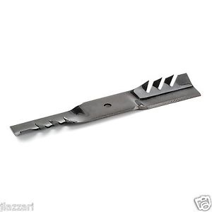

SWMBO flagged me down while I was mowing with my flail today. She was mowing the neighbor's property, in a ravine, 18" tall thick grass. Got caught on a large rock, then the mower didn't want to run with the blades engaged. Raised the deck and sent her to the shop. Put it on the HF jack and started looking. Right blade had lost 3/4" off each end, middle was 1/2" short on one end and so loose it was completely freewheeling, left blade was worn but still usable. Broke out the new G5 blades and installed them. Also greased the spindles. These blades are excellent! The mower is still loud, but much smoother. Cut is better than when it was brand new, and leaves dust behind instead of cuttings. Next it gets the mulching plug installed.

You should post pics of those blades or what's left of them lmao, she must have ran that deck for some time on a rock to do that kind of damage, that's not easy to do lol.
Good to hear the new blades are working well.

I just googled those puppies, pretty mean looking blades.

Twice the amount of cutting edge, carbide insert on cutting edge, very high lift - really work great. Turns leaves into mulch and I haven't installed the mulch plug yet. About $36/set on Amazon.

Usually the sharpest blade is the weakest, I wonder if the G5 blades will survive much more than chopping grass.

Seems to work well on saplings. Heavier than the original. If they don't last I will try the G6 ones - they are a quarter inch thick.
