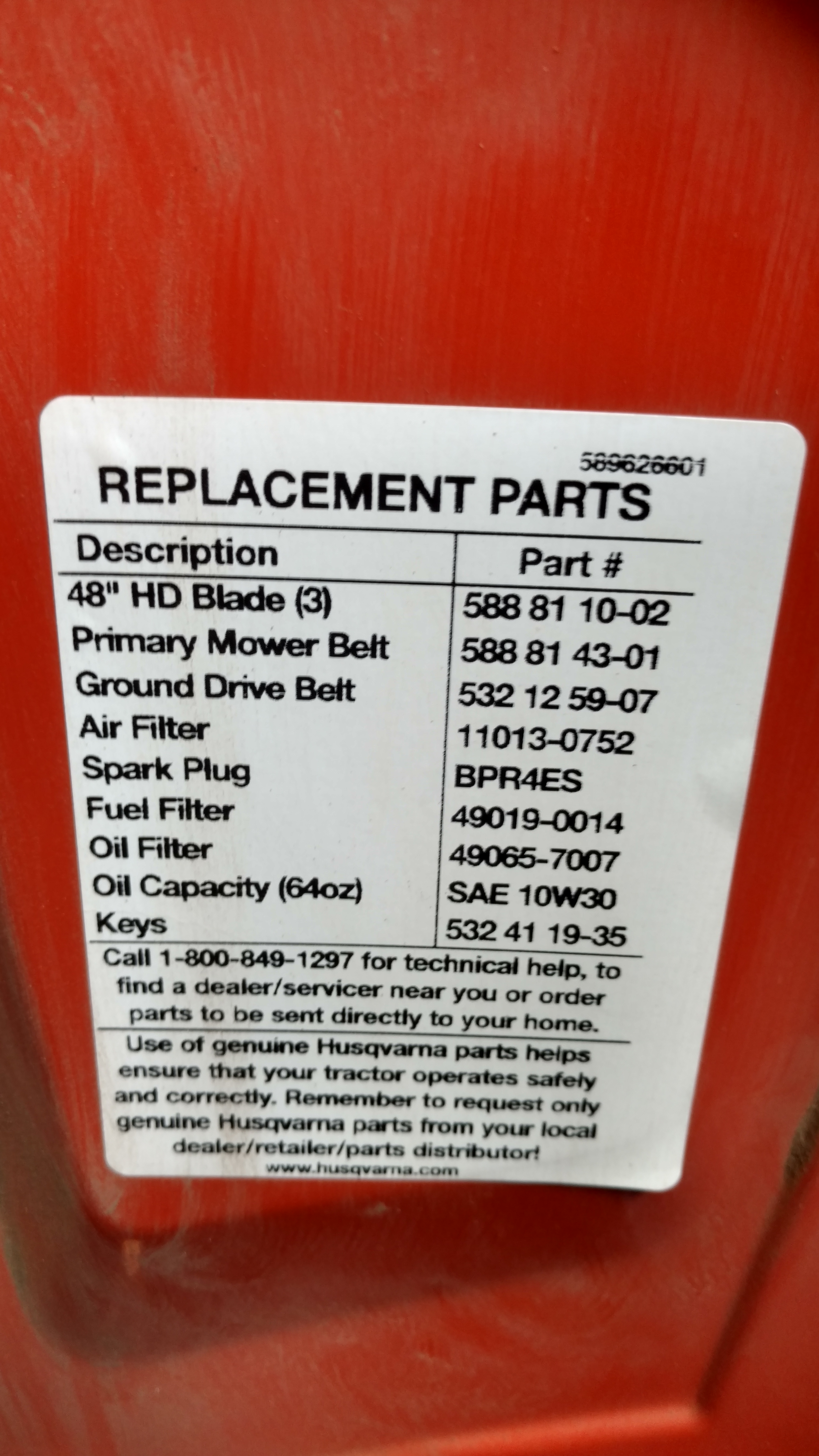

4) Soon will be looking to do the 8 hours oil/filter change...looks like straight weight 30 will be my choice as we rarely see 90F+. No synthetic oil for straight weight I don't believe? Would not a multi weight xx/30 or 40 be a good choice? Any problems with oil filter change out? Do you have the filter number handy?...I don't see it in the Kawa manual.

4) Open your hood. On the right side inside the hood is a sticker - I took a phone picture of mine, so I can refer back to it any time. Has blades, belts, filters, spark plug, and oil all listed. Husqvarna recommends 10W30, Kawasaki seconds that to 86 degrees, then says straight 40. Kawi also cautions that multiweight oils will be consumed at higher weights.
