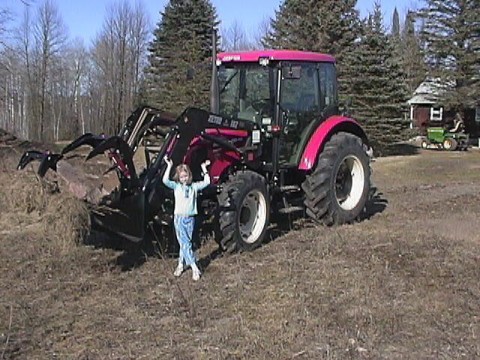

I hear you! Last thing on my list was buying a new tractor without a ROI in sight /forums/images/graemlins/confused.gif
Get a 3rd hyd function on the front for a grapple - saves climbing on & off, chaining debris to the bucket. Staying with MFWD gets traction and 4 wheel braking on those slopes /forums/images/graemlins/tongue.gif
I paid $26.5K from local dealer for this one in pix last year.
JD wanted an extra $20K for a green one. I bought a Gator from him last month & he said "JD makes the best tractors" I agreed - especially when I could get a red one & save $20K!! /forums/images/graemlins/cool.gif /forums/images/graemlins/cool.gif /forums/images/graemlins/cool.gif
Zetor was the manufacturer of JD 2200 thru 2840 series utility class tractors in S American markets. Zetor p/n's are still in the JD database.
In any case, picking a dealer is a key part of the purchase. Plan out initial tasks + attachments AND going out 5 years. Trading prematurely might leave cash on the table.
Trust your seat time feedback. I just felt that the 5105 would leave me running around with daylight showing under the rear tires too much of the time /forums/images/graemlins/wink.gif /forums/images/graemlins/wink.gif /forums/images/graemlins/wink.gif
