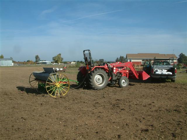

I have a 2008 Mahindra 5525 (54 hp engine, 45 hp pto, 2WD, power steering, partial constant mesh tranny, 8F/2R). It's a heavy, simple tractor with a basic partially synchronized tranny. Paid about $17.5K for it. Use it on my 10-acres of flat pasture. Have 5 acres this year in oat hay (plant in Oct, bale it in May).
It takes a little learning to use the FEL efficiently with that simple gear tranny. If you're in a hurry, shuttle shift or hydrostatic trannies might be a better choice.
