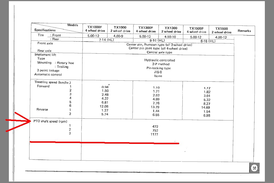

Thanks for your reply and yes it does sound very much similar to that one. I have some experience with diesels and know that particularly small displacement industrial engines can be quite noisey but this one takes the cake. apart from the noise she runs very well and everything appears to be working fine I even hooked her up to a tree and tried the 4wd which is engaging freely and works fine ,also I put the slasher attachment on and the pto works I just have to figure out the pto speed settings as all the labelling is either in Japanese or that faded it is unreadable, a little help there would be great.

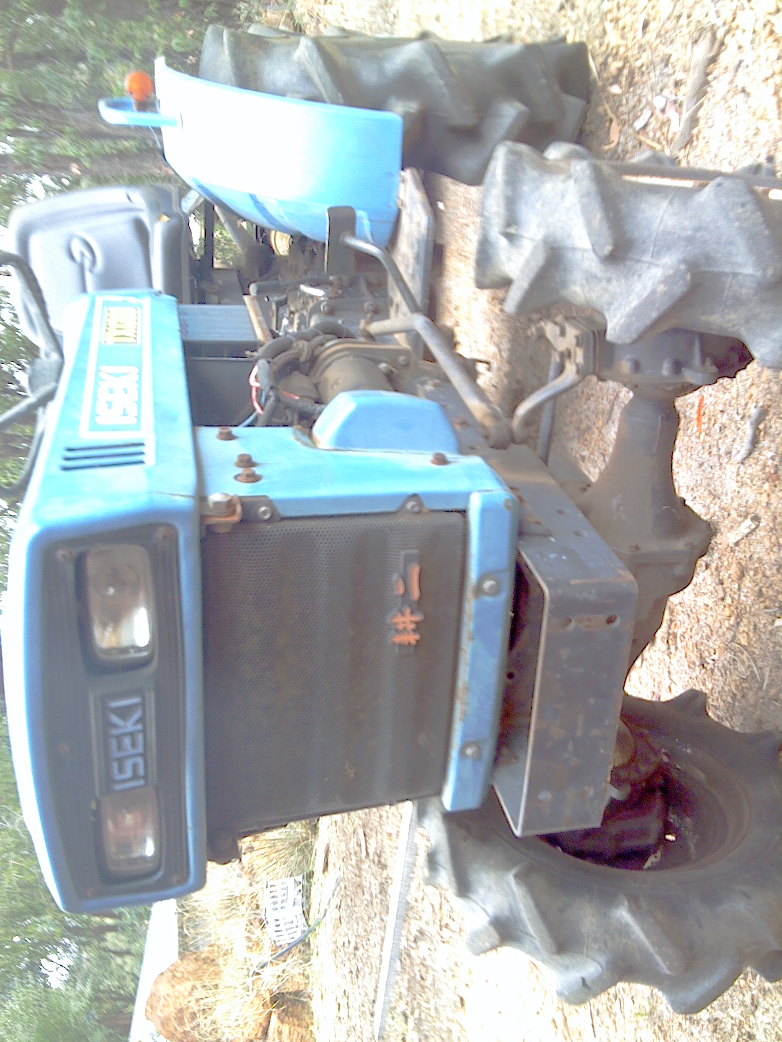

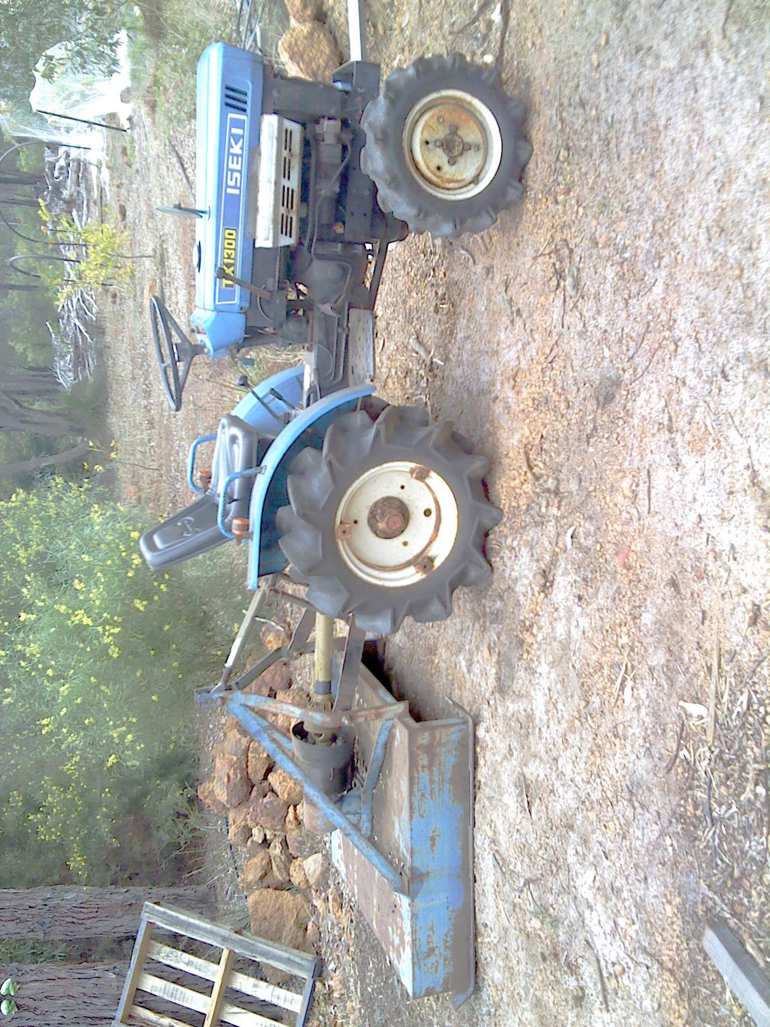

Also some pictures of yours would be nice.
Is your tractor a TX1300 or TX1300F ?
/ Another noisey tx1300
Mine is the 1300f still has the Japanese tyres on it cane with rotary hoe and slasher all on a licenced trailer so although there is some tidy up work to do im pretty happy with my purchase. Ill take some picks and figure out how to download them maybe later today maybe after Ive finished playing :tractor:
#9
Here are some pics I took after playing. I still have to give her a wash but this is basically how I bought it. Pic_0504_182.jpgPic_0504_182.jpg
/ Another noisey tx1300 #11
looks like a good one.
#13
Im happy with it. Unfortunately there is no hour metre or for that matter gauges at all so I cant guage how many hours she has done

The PTO is a three speed. Push the lever all the way down is first.
pull up one click and that is second. Pull up another click
is neutral. All the way up is third. Here is a chart with
the RPM's for each gear.
