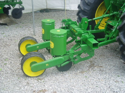

Planters Another planter done!
   / Another planter done!
#11
#17
</font><font color="blue" class="small">( Indy - How long did it take? )</font>
I spend roughly 3 hours per row unit, reconditioning them. The hitch components take about 6 hours to cut out, clean up, prime and then paint. Final assembly takes about an hour.
IF... the seed boxes are rusted, I spend another hour or so on each one, sanding priming, and then painting them.
Decals and detailing, about an hour.
SO....What you see in the picture represents about 15 hours of playtime.....er...hard work...Yeah, that's it! HARD WORK...!

Here's a few shots of the planter hooked up to a tractor. First couple show the older style seed boxes.

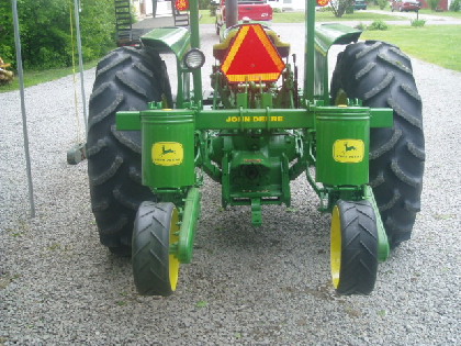

#20
Pic #2
