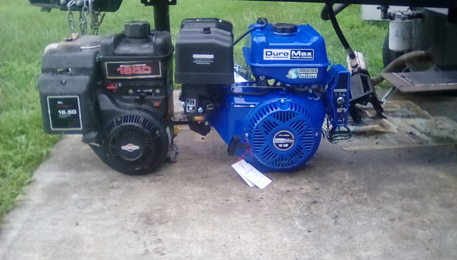

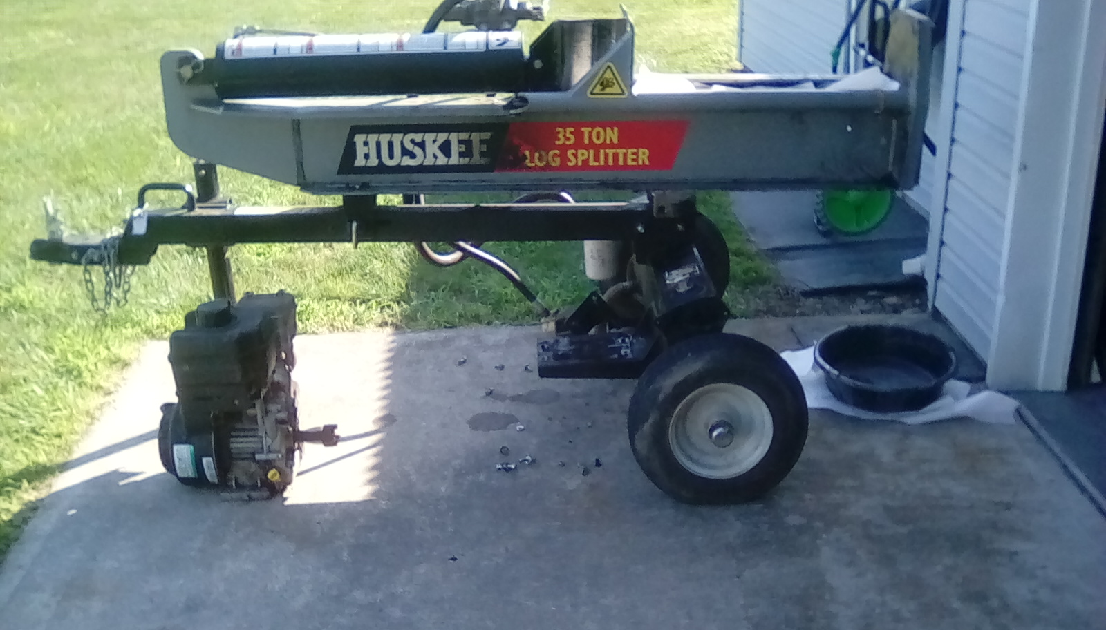

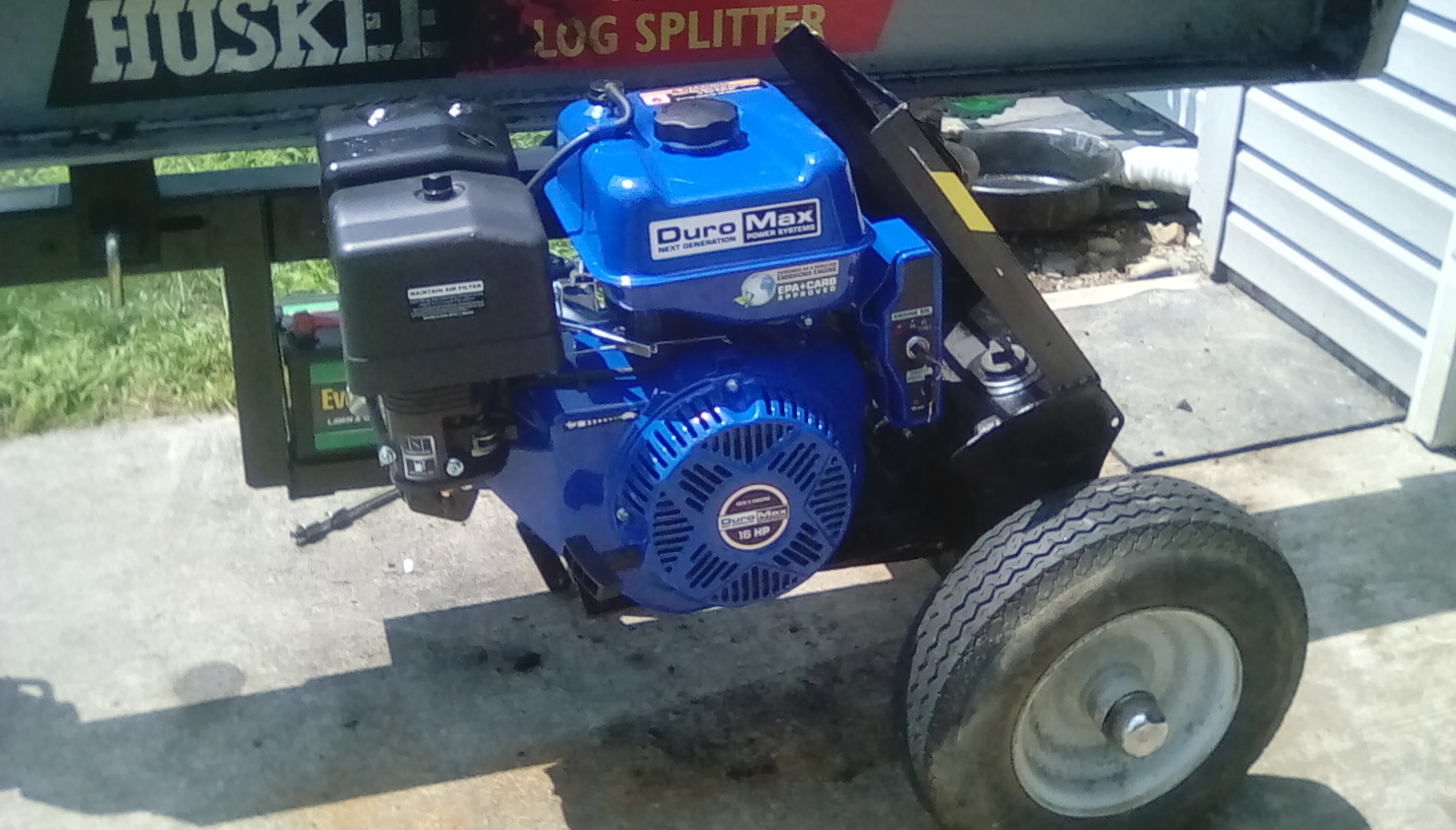

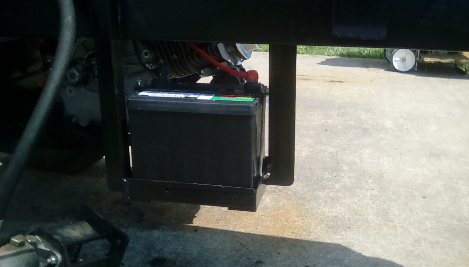

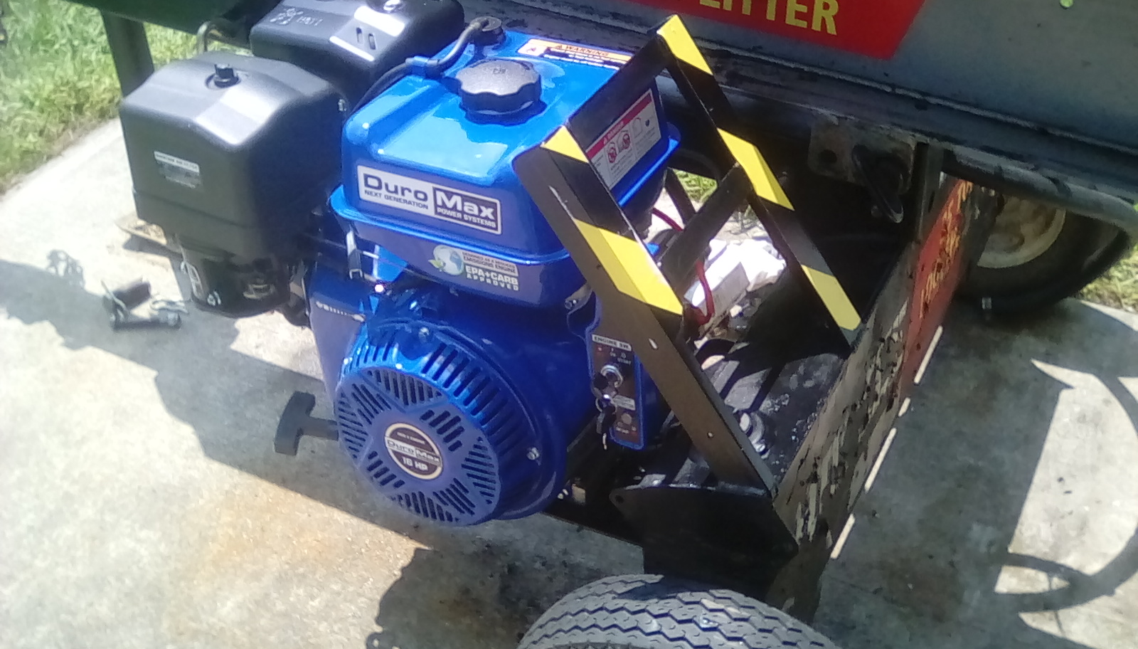

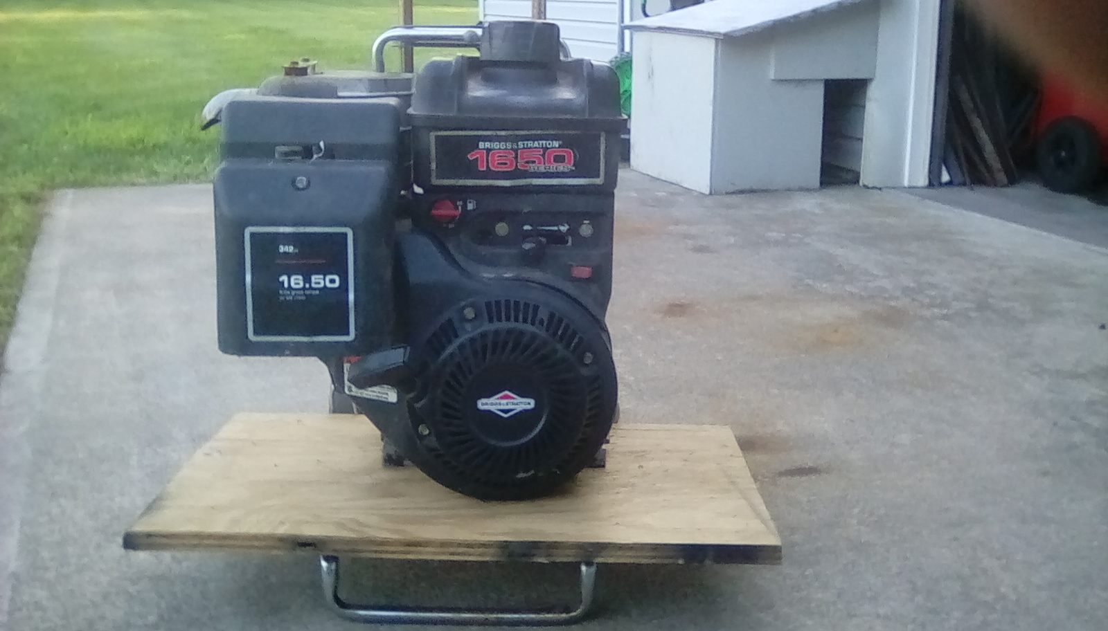

I did this one recently. Changed out a 11 h.p. Briggs to a 16 h.p. DuroMax electric start.
