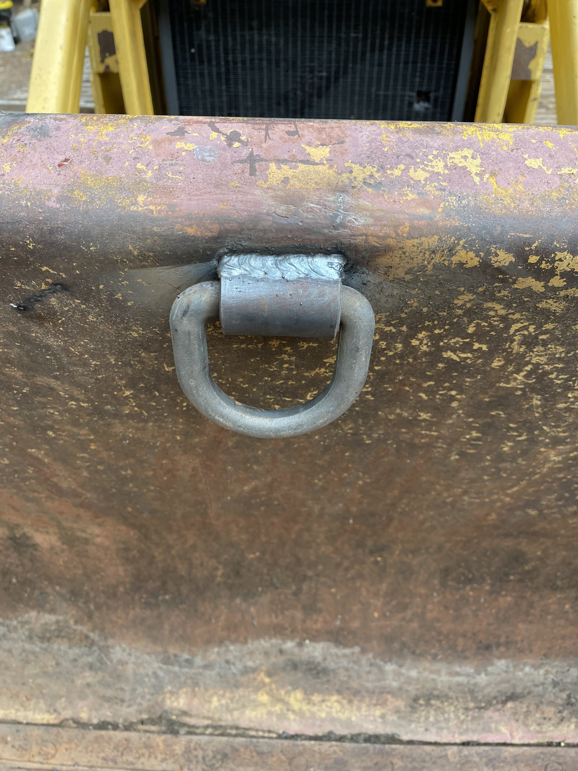

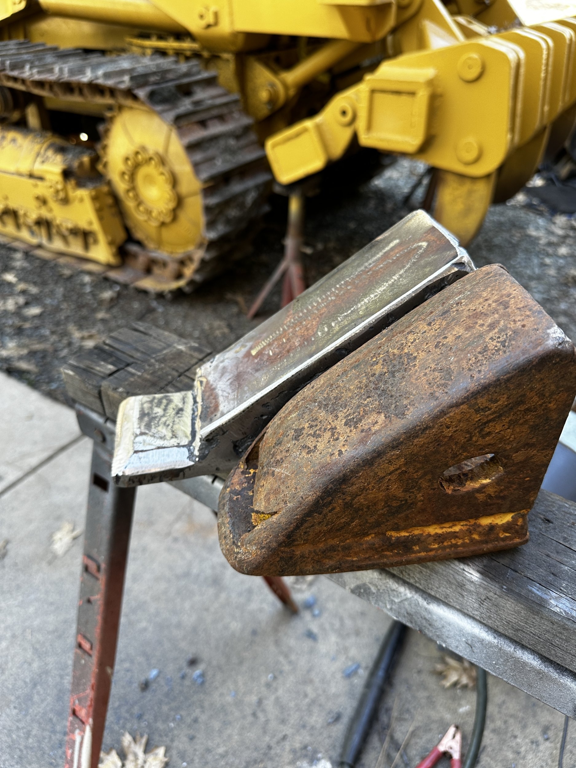

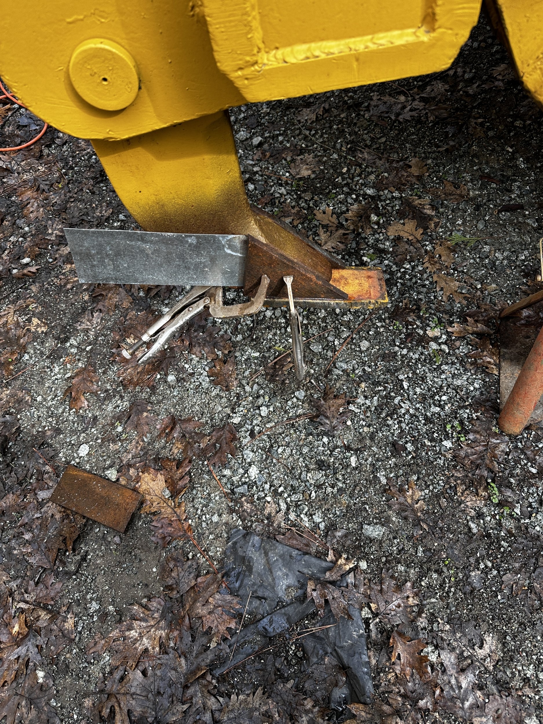

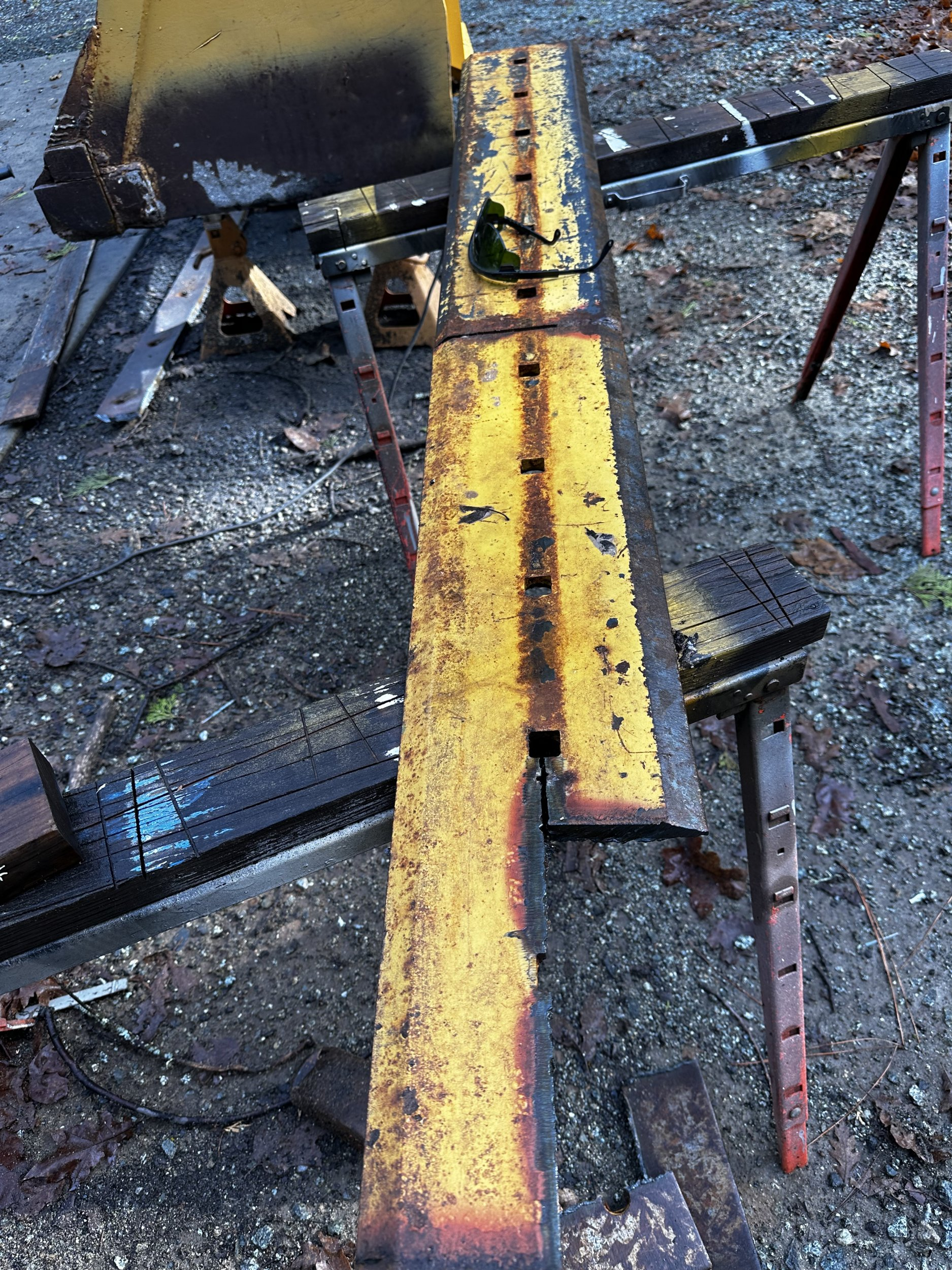

Here is the latest excuse for delayed progress. Road work, vehicle maintenance, helping neighbors stuck in the mud, rain, burning tree limbs collected last year.

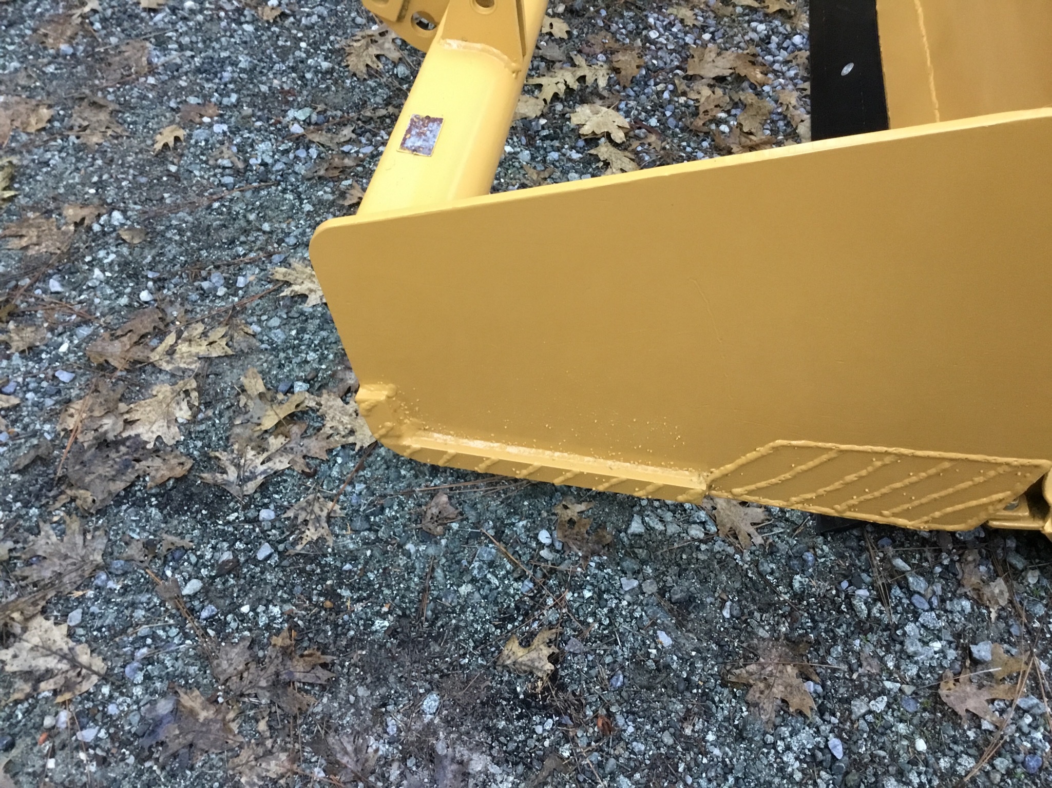

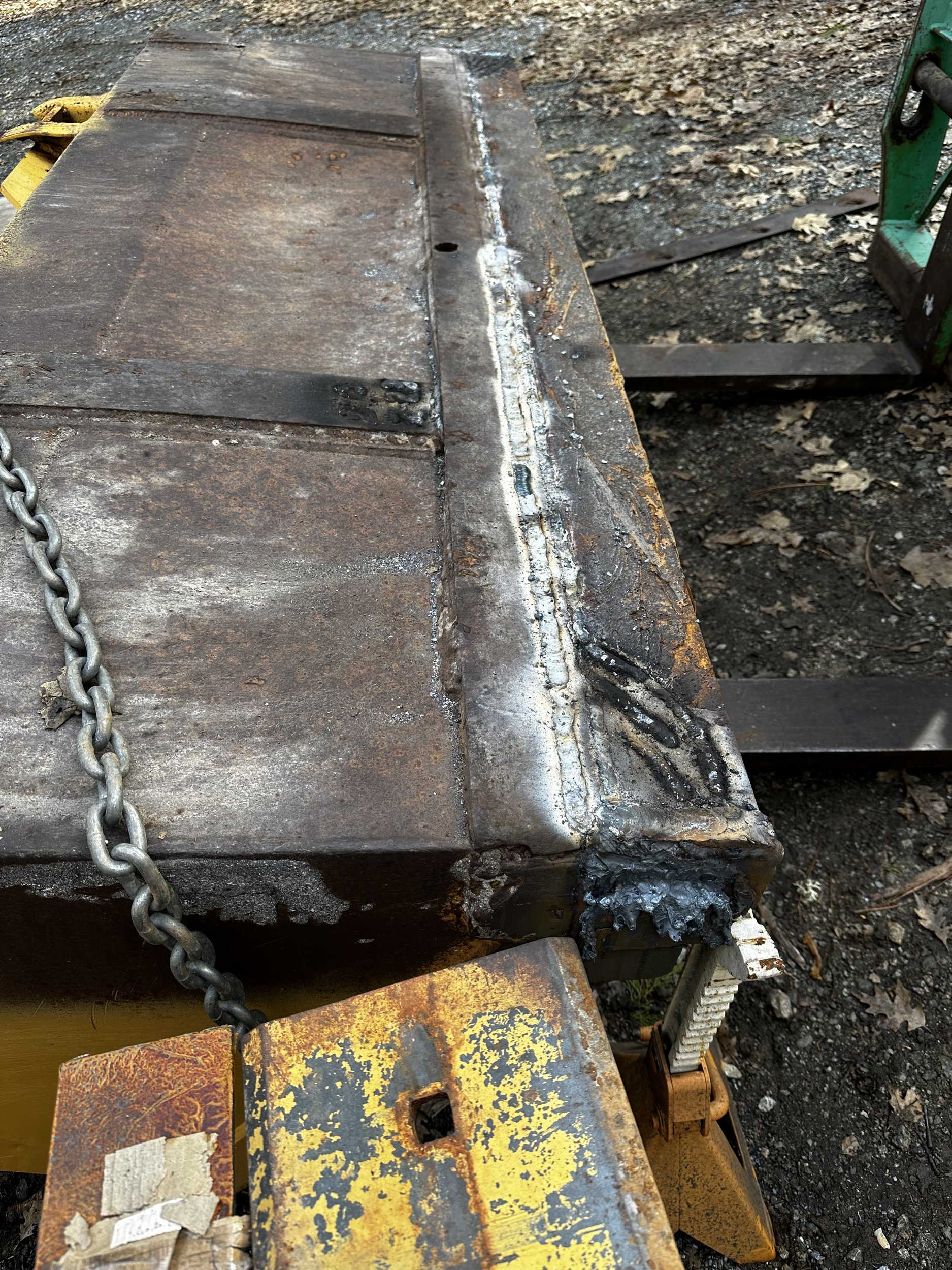

Ok I am cutting some steel to make the three ripper teeth. I am using cutting edge stock to make them. I have a loader/scraper box tractor that I restoed a few years ago shown on this site. I wanted to work on the loader bucket and remove a 3/4” thick large cutting edge and a curved cutting edge from the bucket. That derelict setup made it so the tractor was trying to push a 1.5” surface into whatever one was scooping. It’s only a 10,000 pound tractor. So I am using a portion of the 3/4” material for the extended cutting portion of the tooth and some 1/2” material from another cutting edge I had for the sides. I welded a new cutting edge on the little loader bucket and while I am there I am making a tooth attachment for it. Got rained out again yesterday.

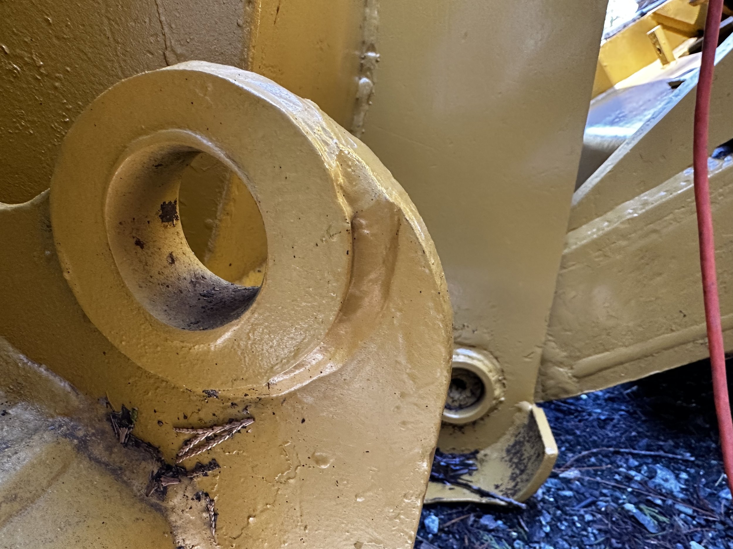

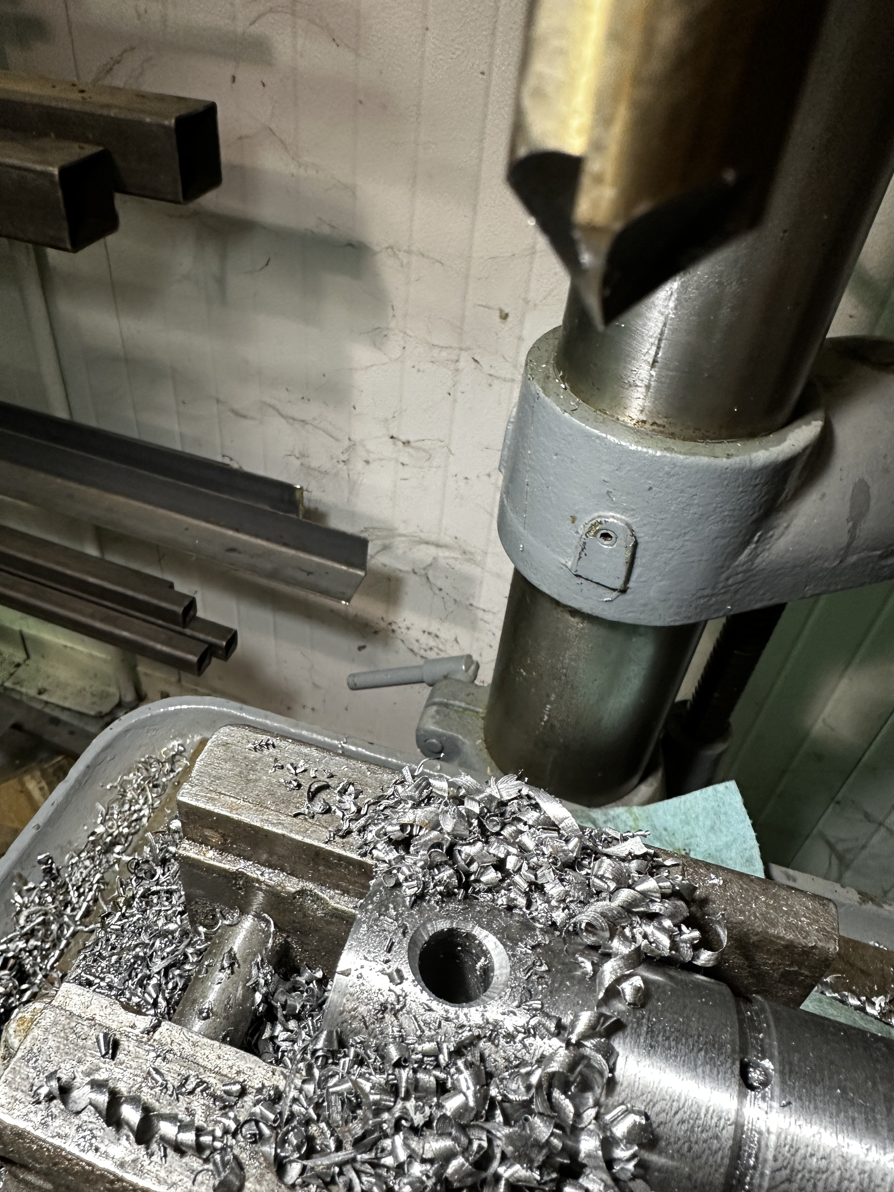

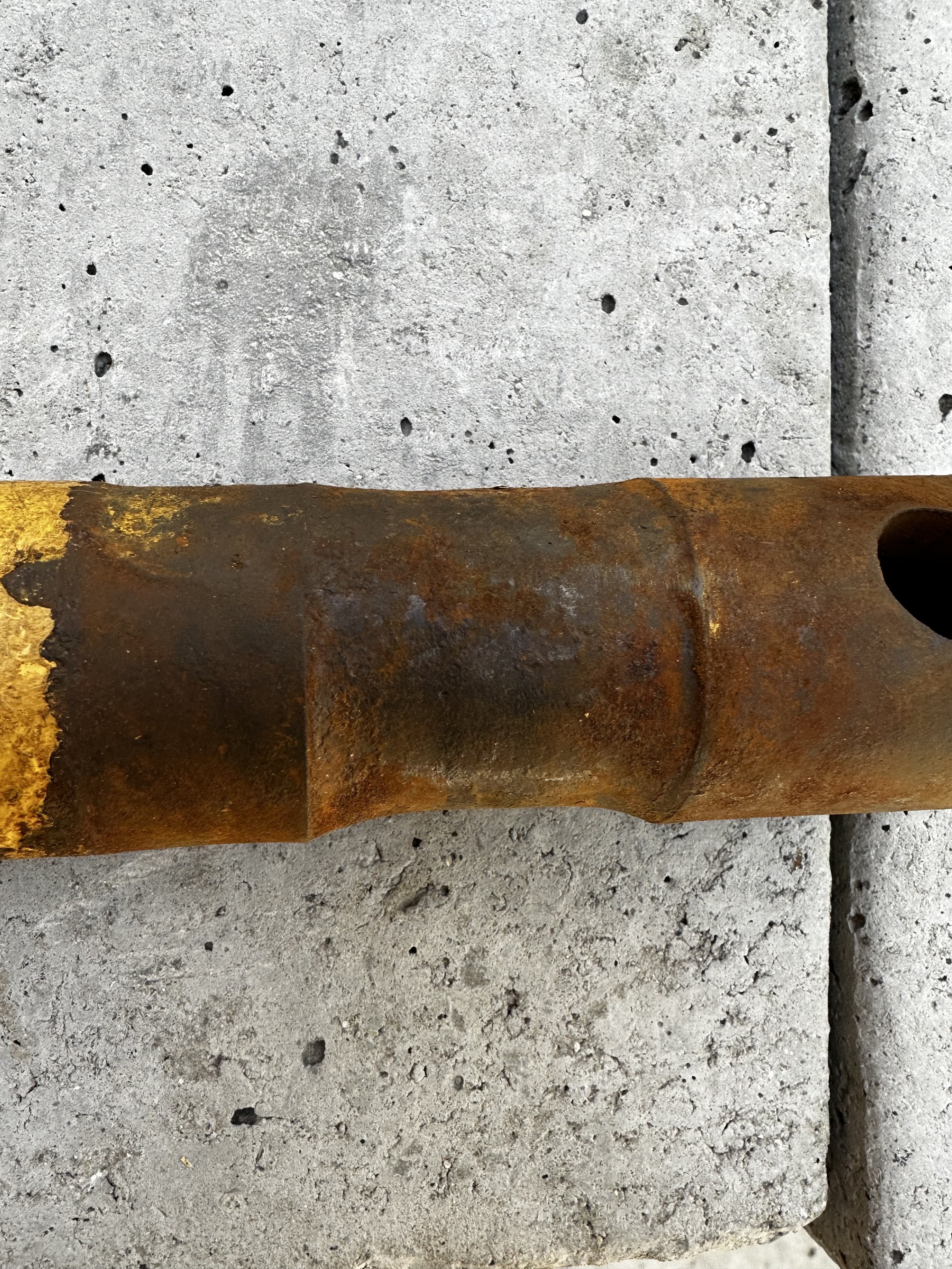

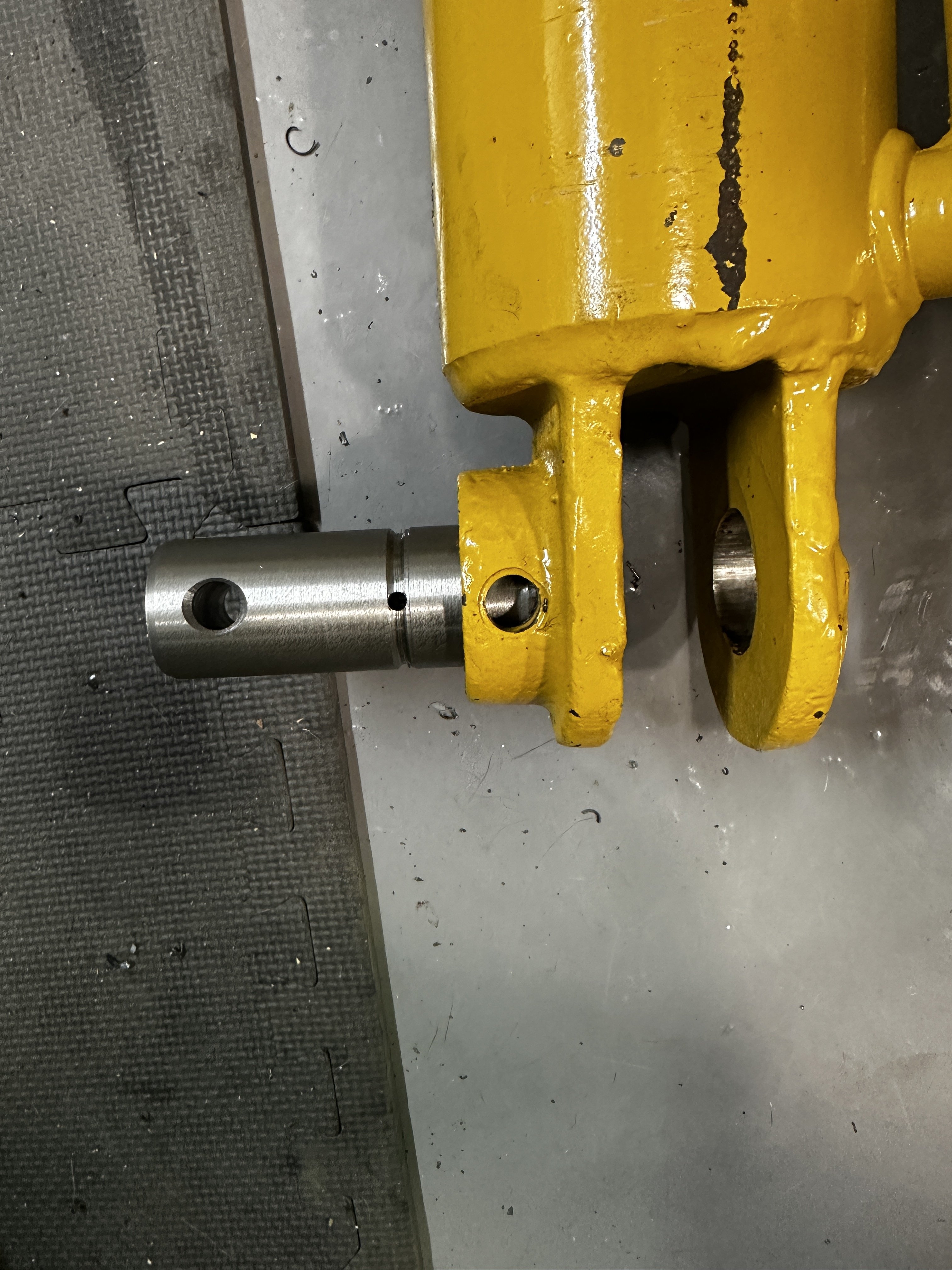

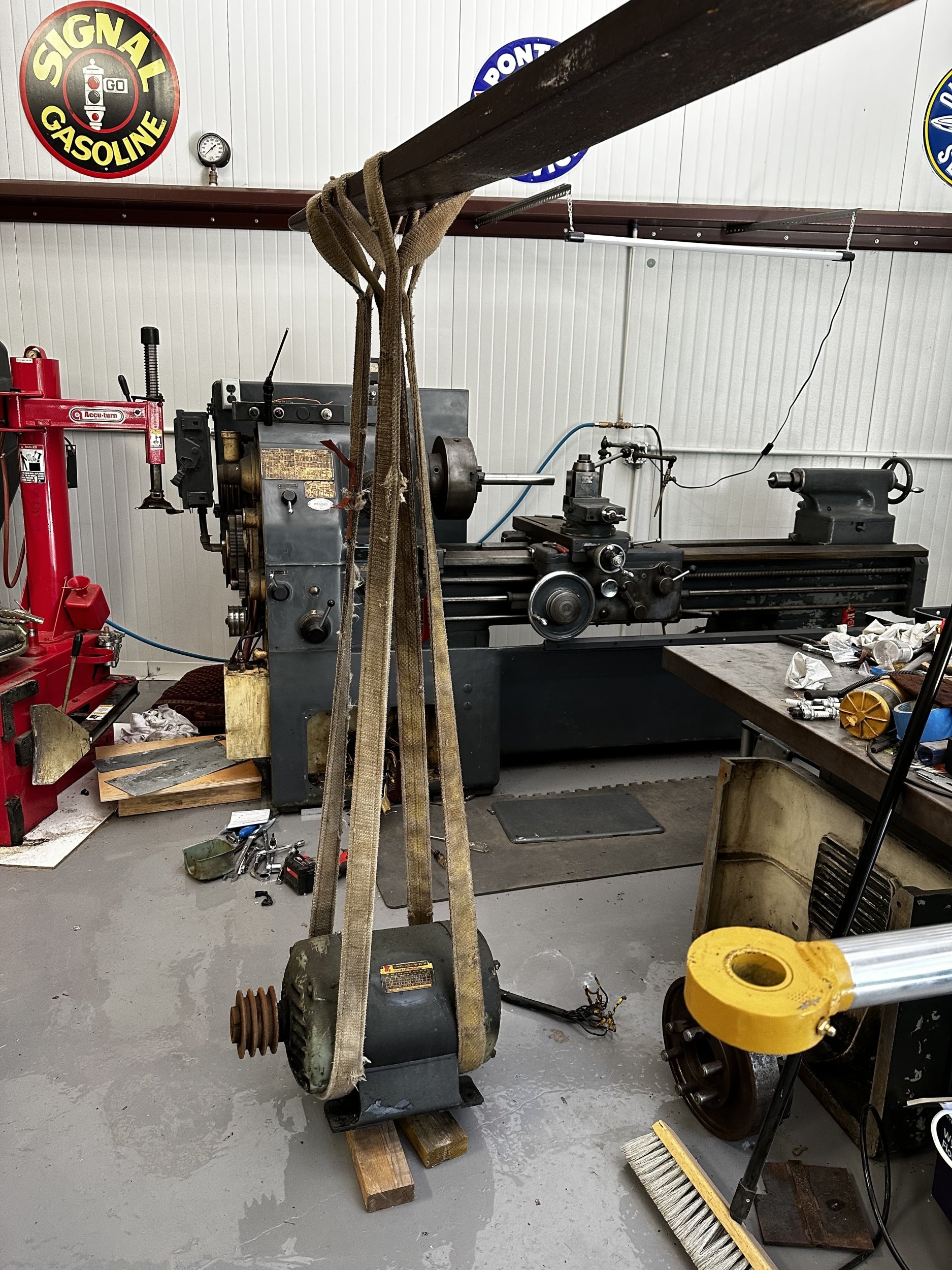

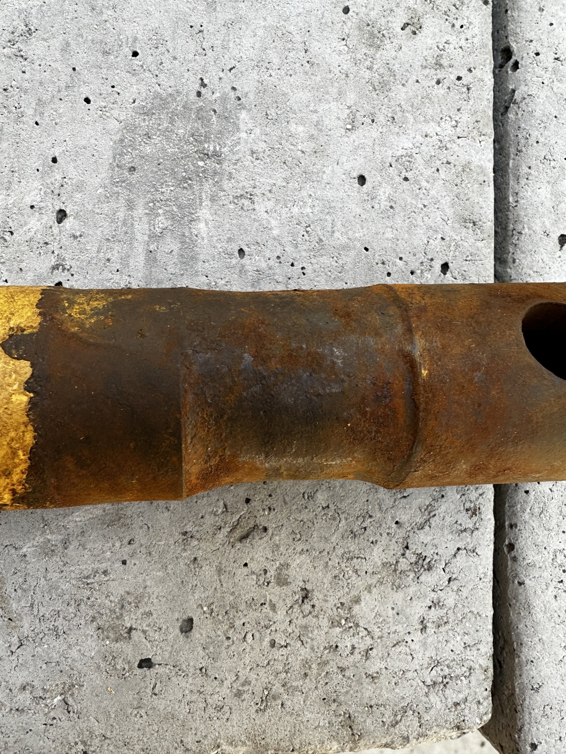

I had some egg shaped holes on the clam cylinders and lower mounts. I used an adjustable hand reamer to make them round then I am going to make some oversized pins.

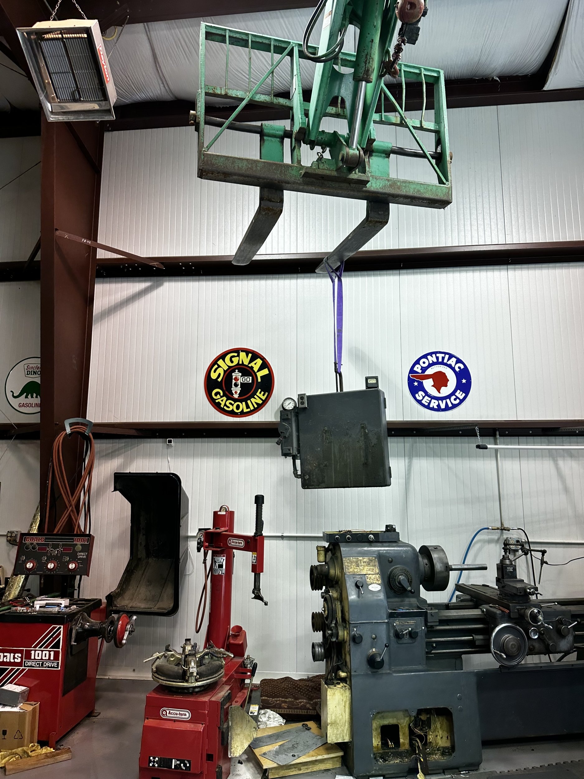

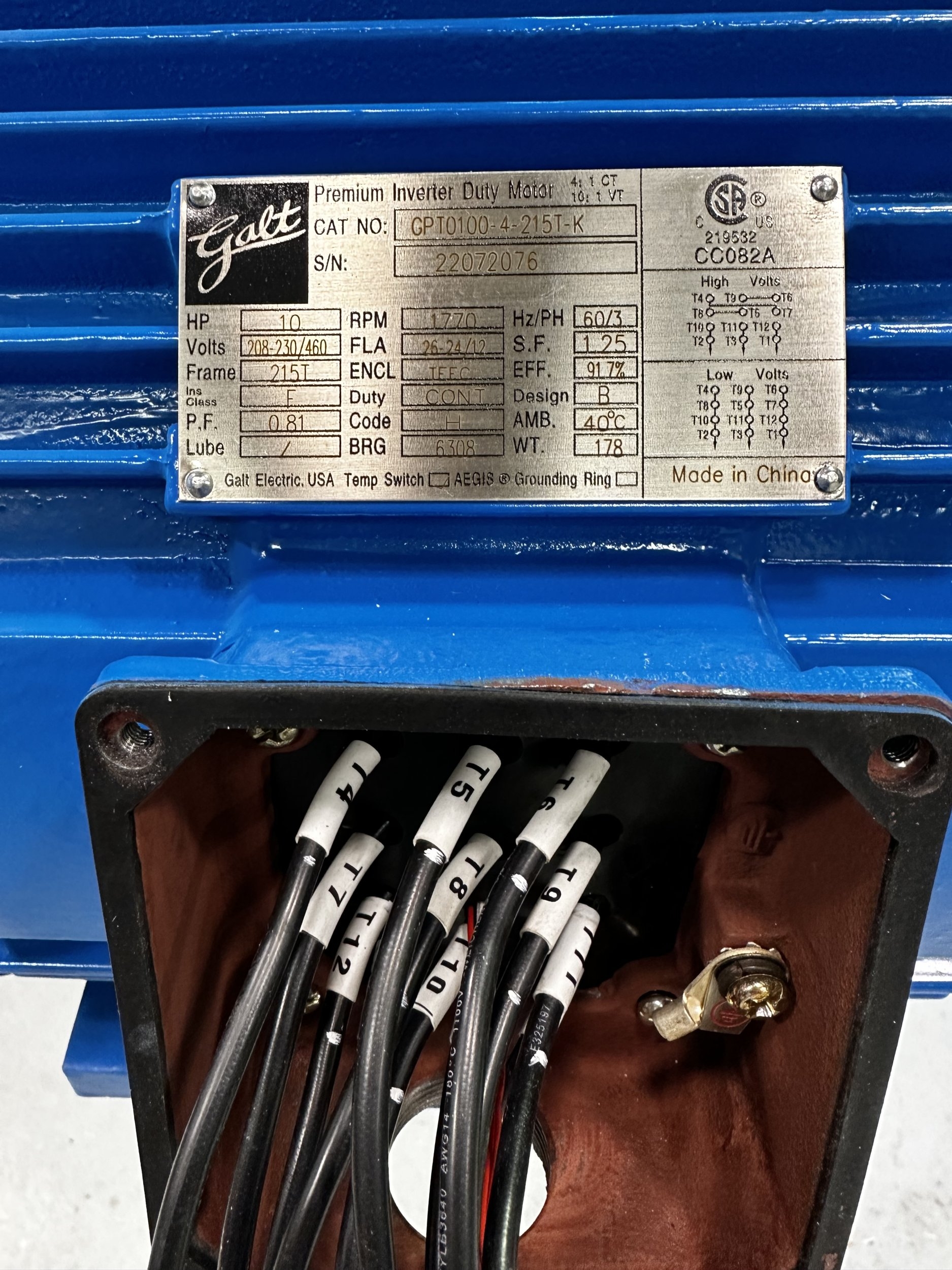

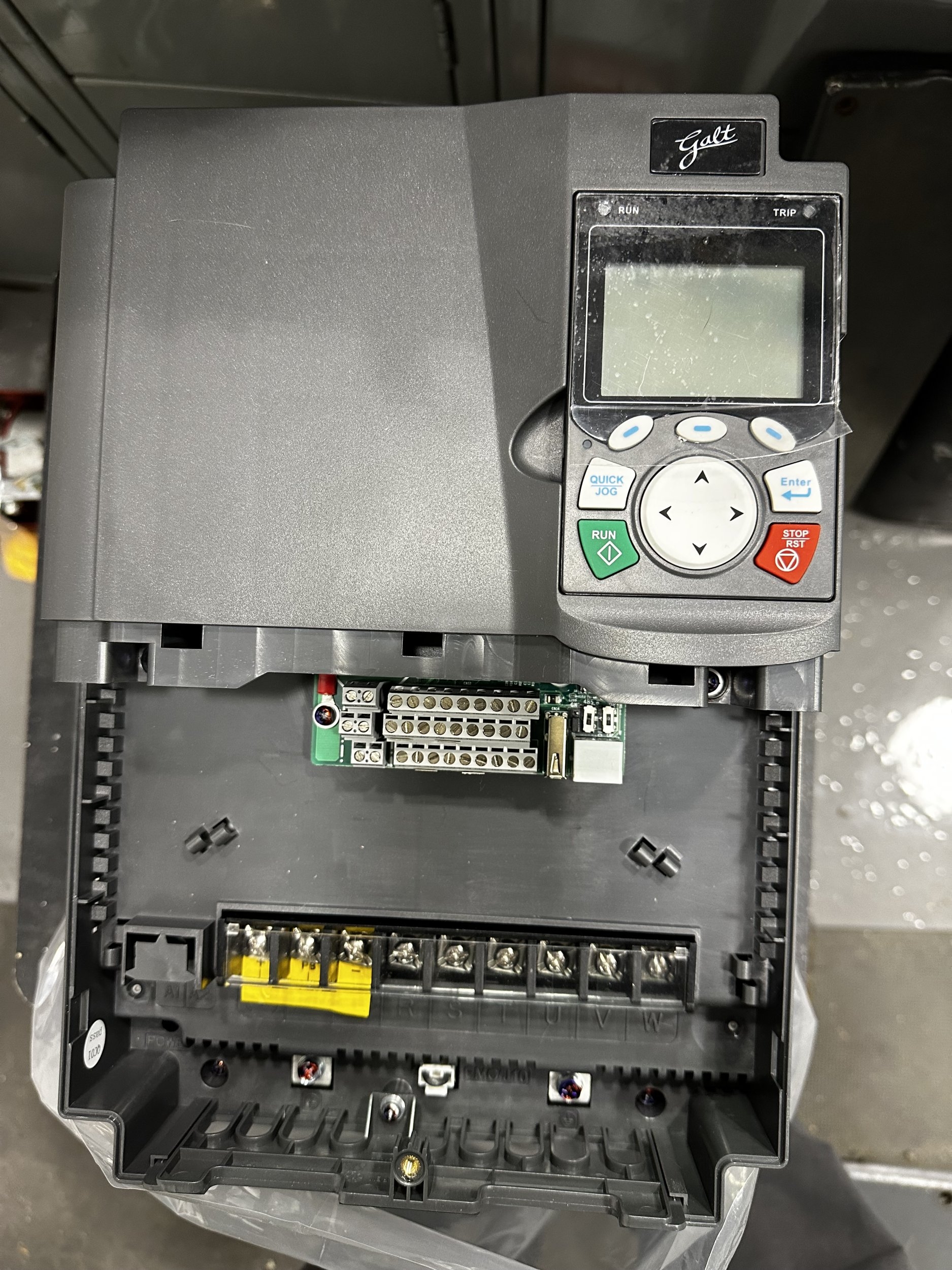

I have my lathe apart replacing the old style electrical system with a VFD. I had to change the motor for one with better insulation to handle the VFD and a braking resistor. The motor had a different mounting so I had to make a mount adapter.

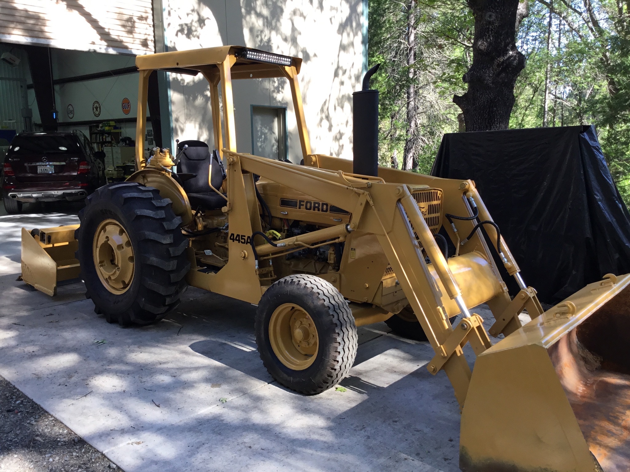

Not yet. But I do plan to do some work on a previous restoration that wasn’t finished.
This is the order of the plan.
1. Clean the shop, organize too.

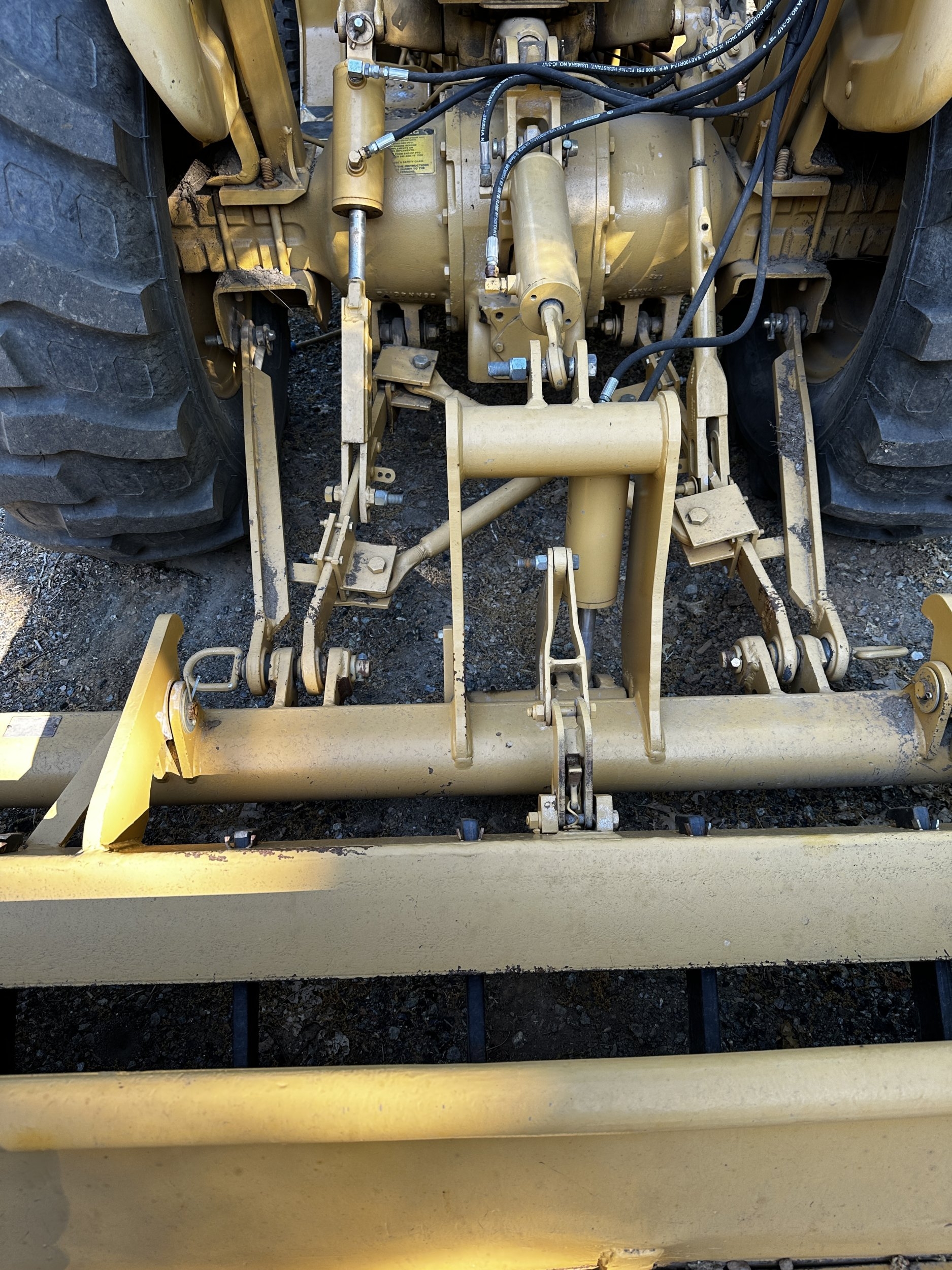

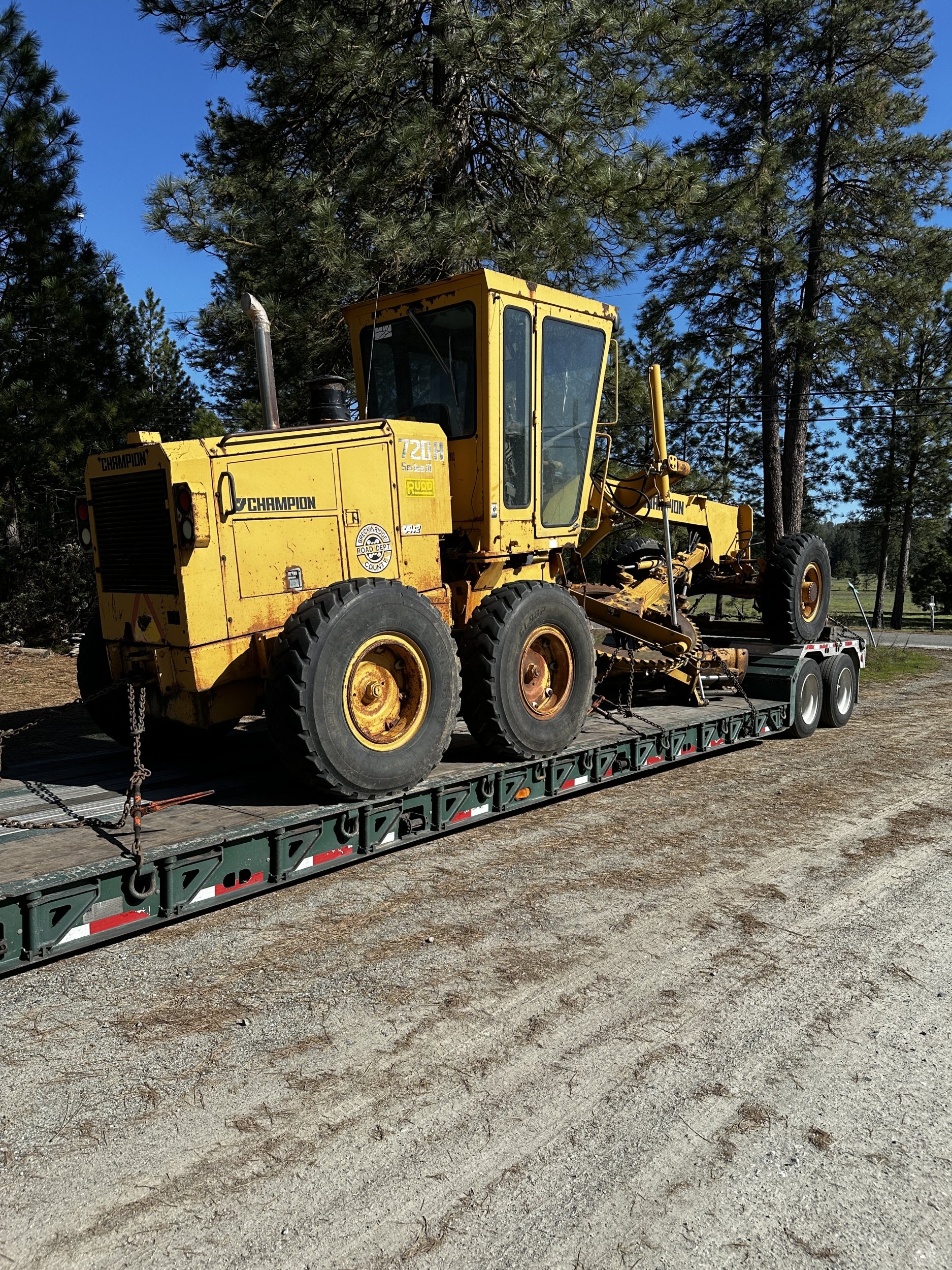

2. Rebuild the engine on my 445A Ford loader/scraper. Replace one of the two hydraulic pumps and replace seals in the three point hitch.

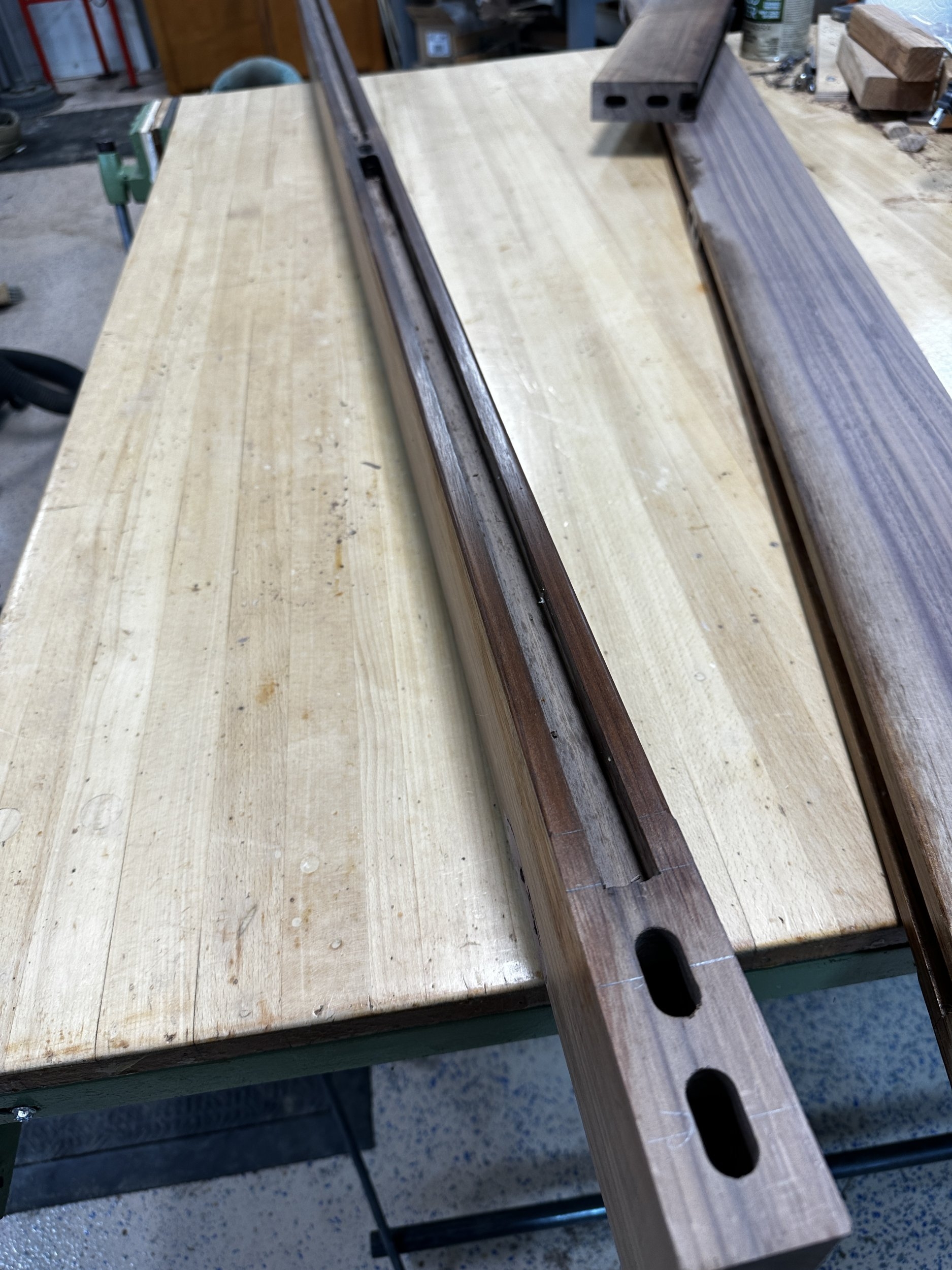

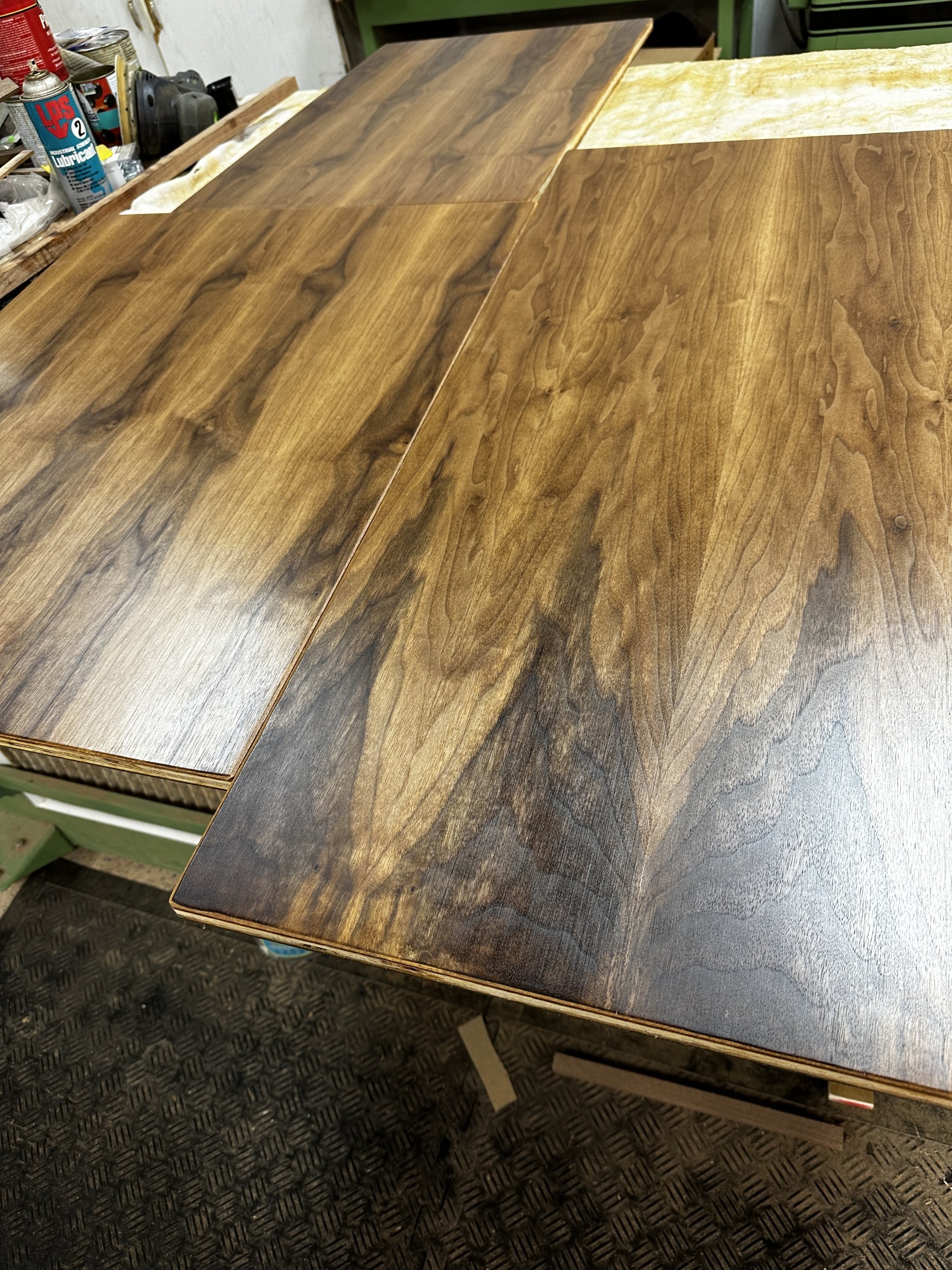

3. Make the rest of the interior doors for my house ( making two right now)
4. Decide on which two other vehicles for restoration sitting around here.
A few of the 445A and a heavy duty scraper box attachment. A couple of doors in process using 10 applications on each side of hand rubbed oil I get from the UK.

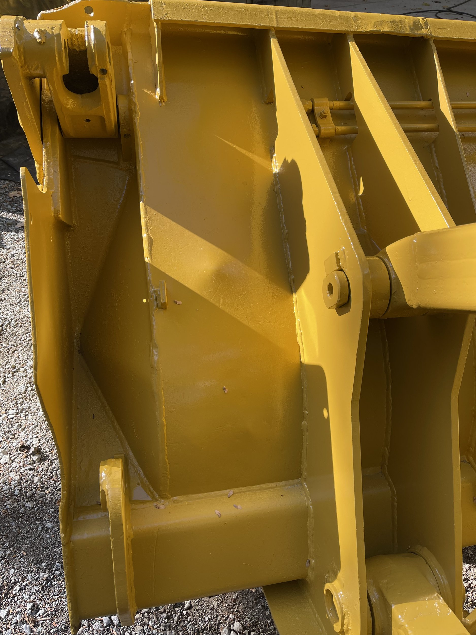

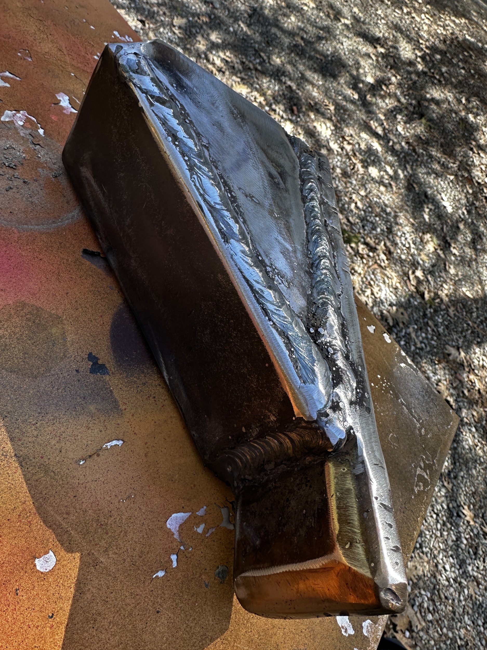

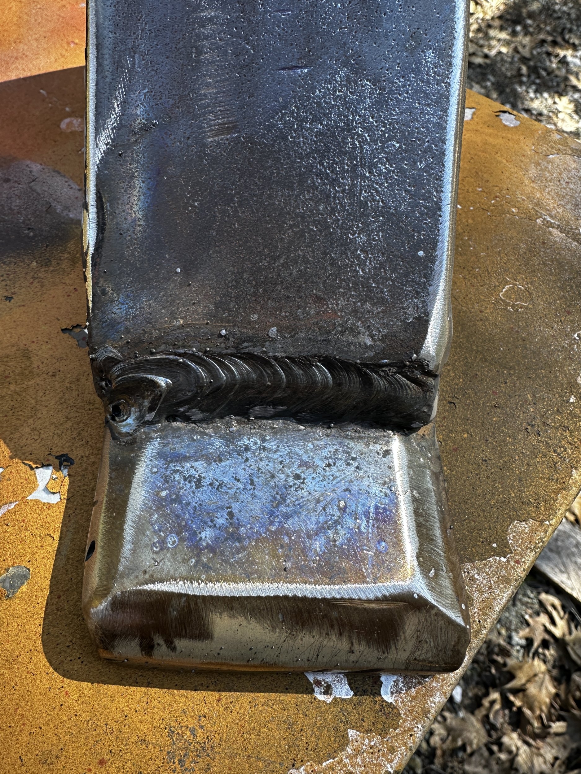

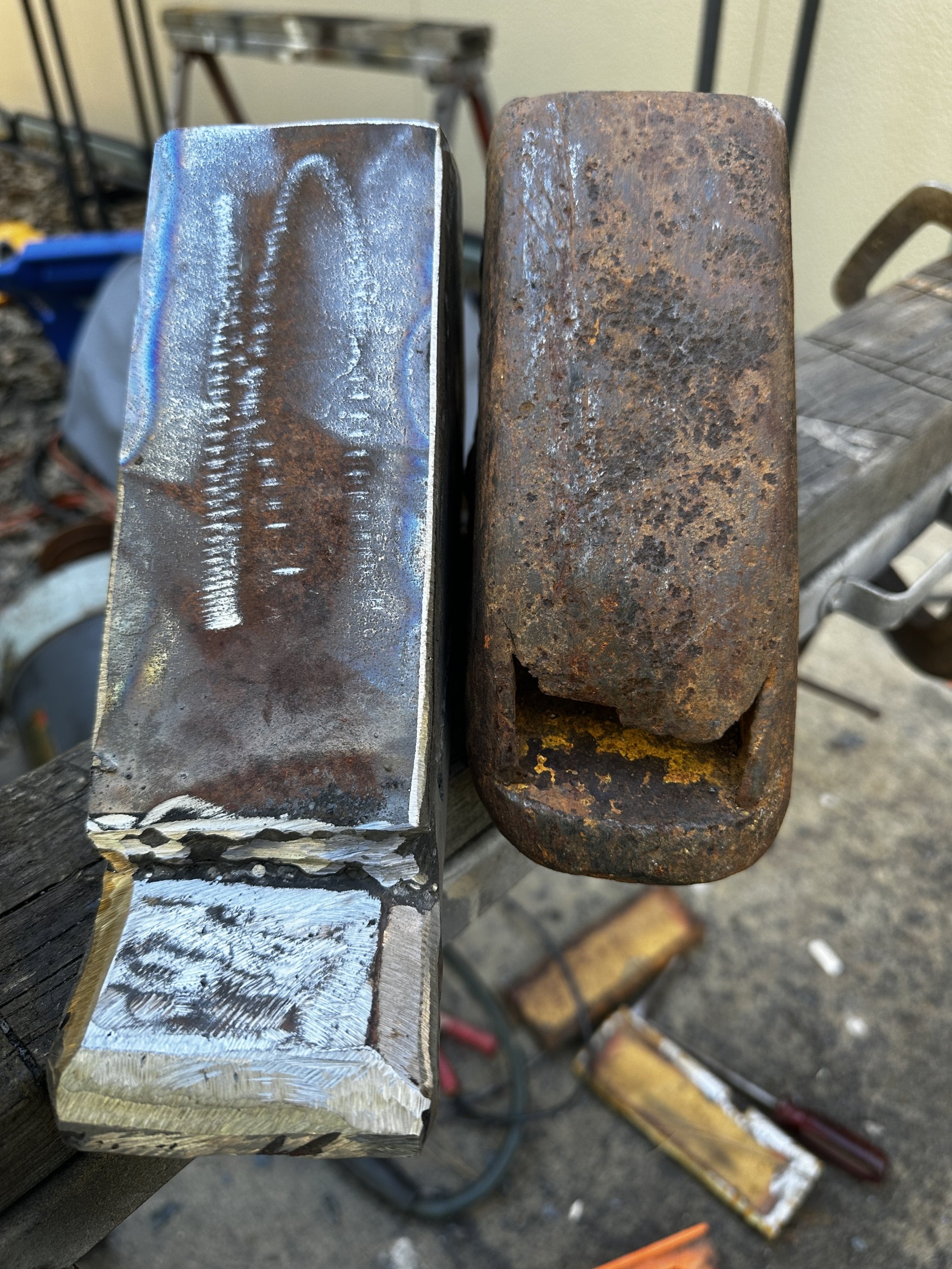

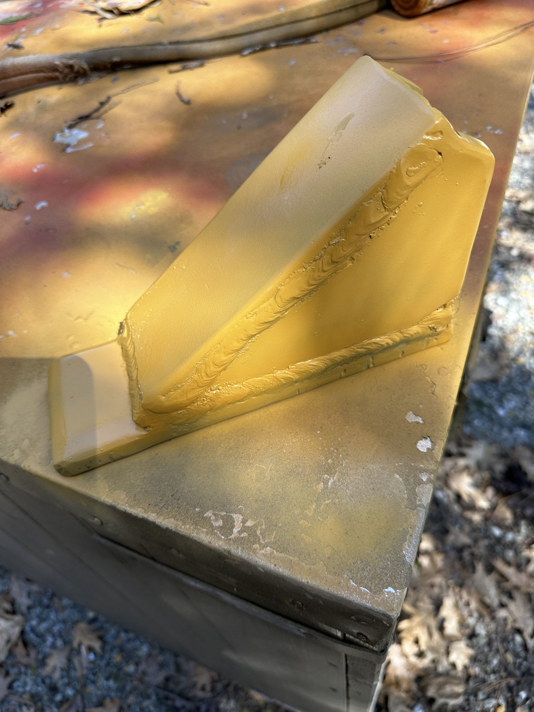

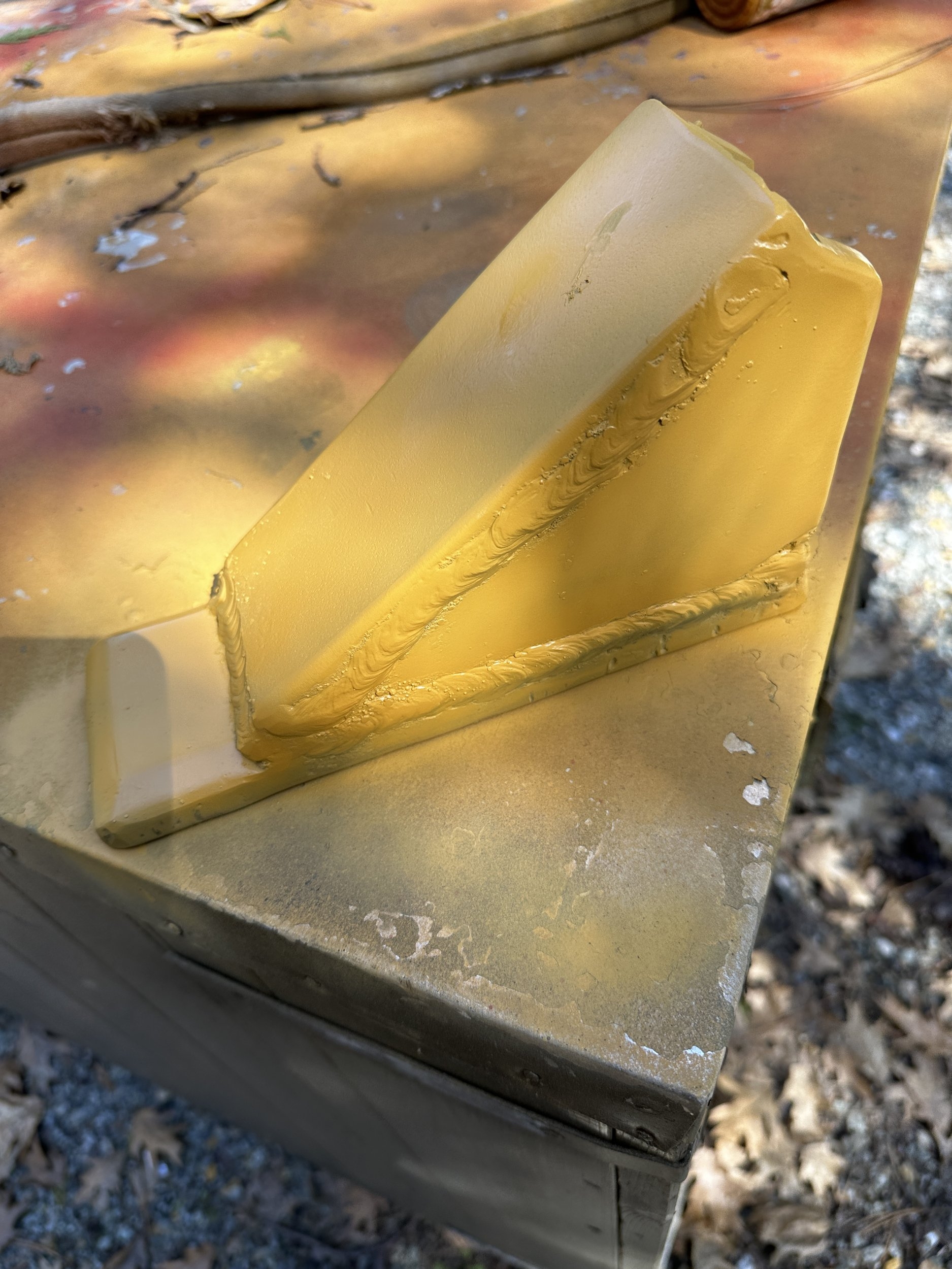

Finally getting back to the Massey. I decided to resume by starting with the ripper teeth. I don’t like to do heavy welding and grinding outside once it dries out.
I am making each one separately directly from the shank because someone has used the ripper with two teeth missing. While they may interchange I will never wear them out around my little place. They are fairly thick with the bottom being .75” and the sides and the top being .5”. Since the material is cutting edge stock it isn’t easy to grind. I weld them with my Ln-25 pro feeder. I have a few more things to finish on my lathe VFD programming and reversing switch then I can make the clam cylinder pins.

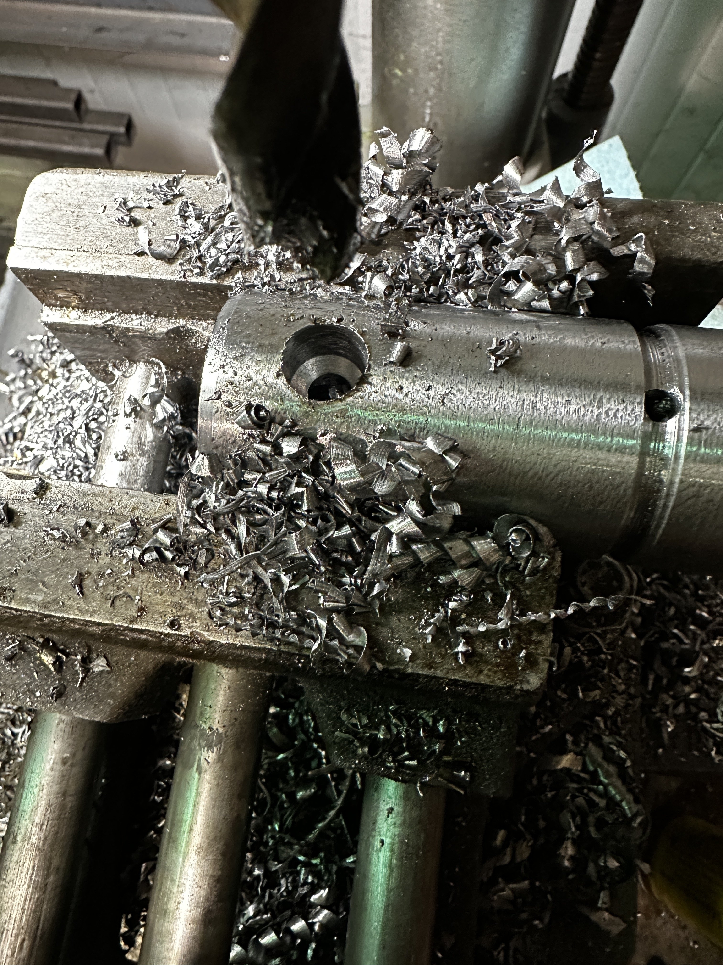

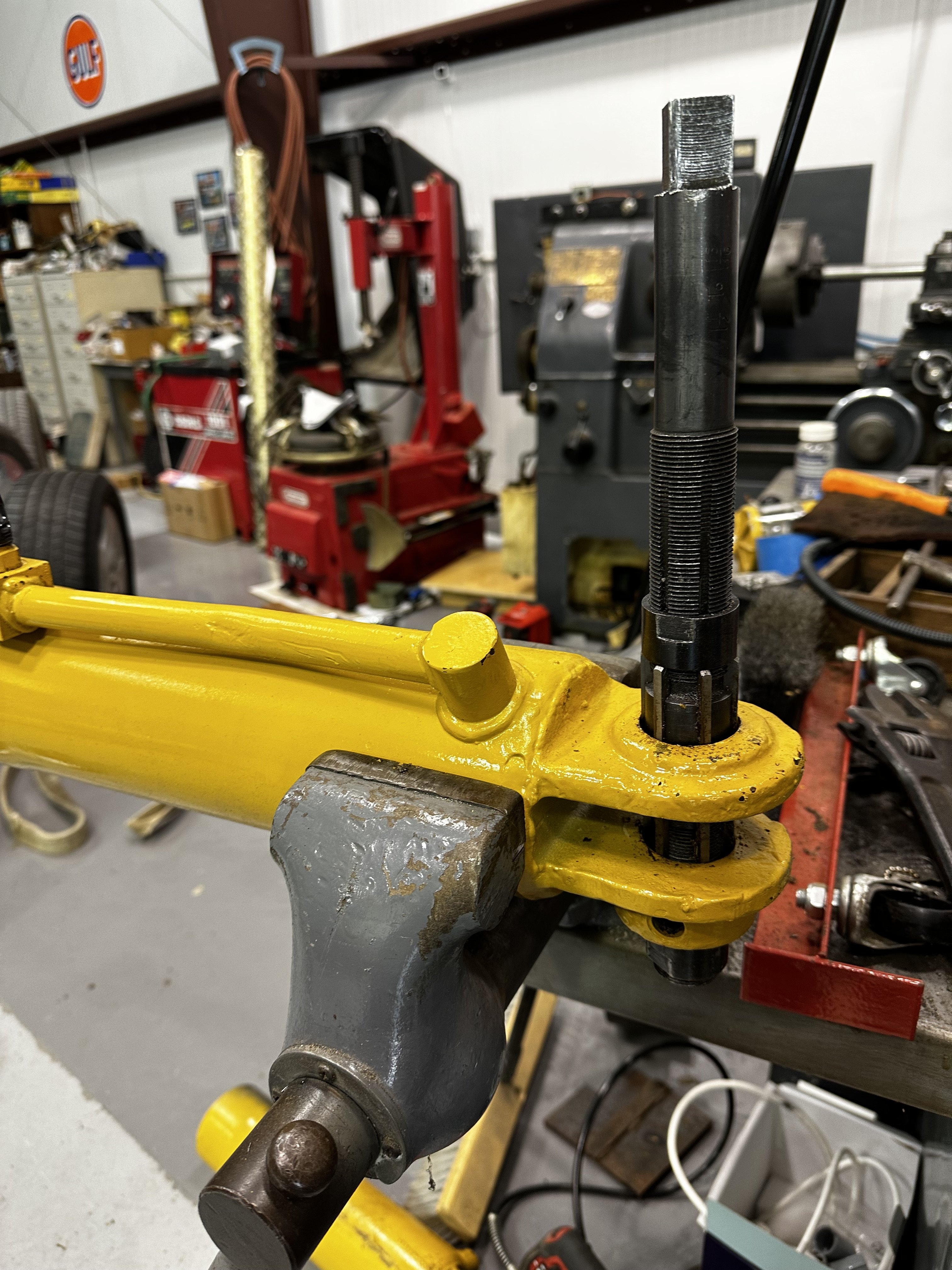

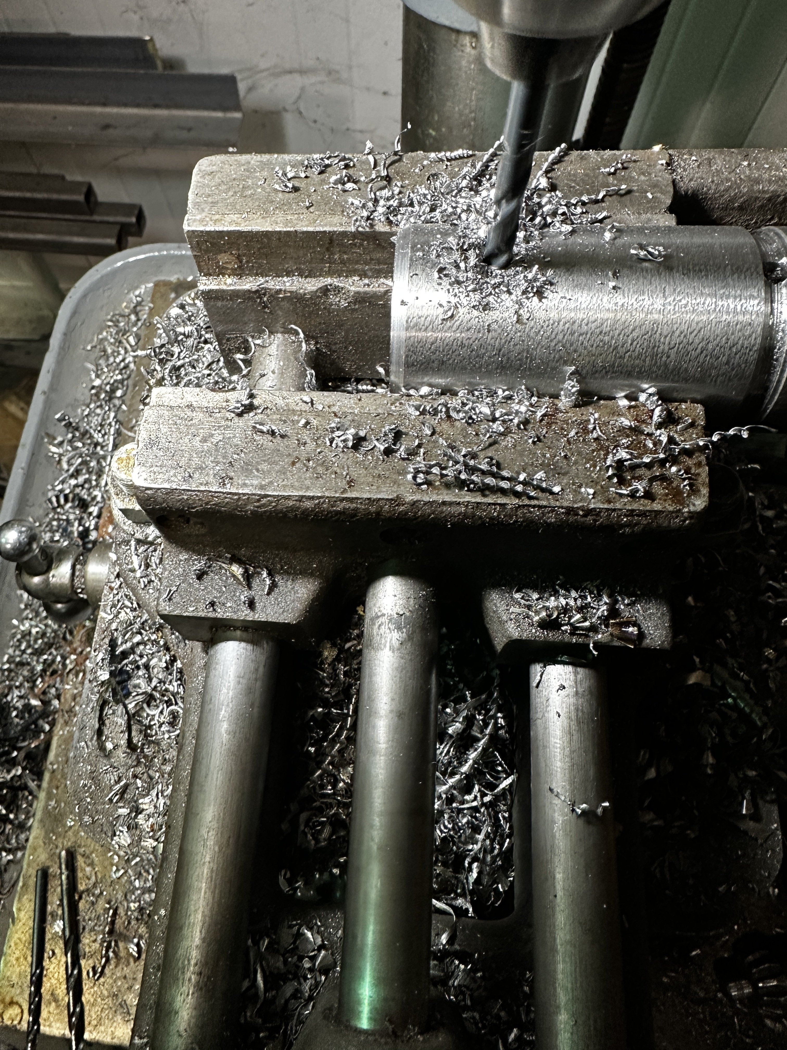

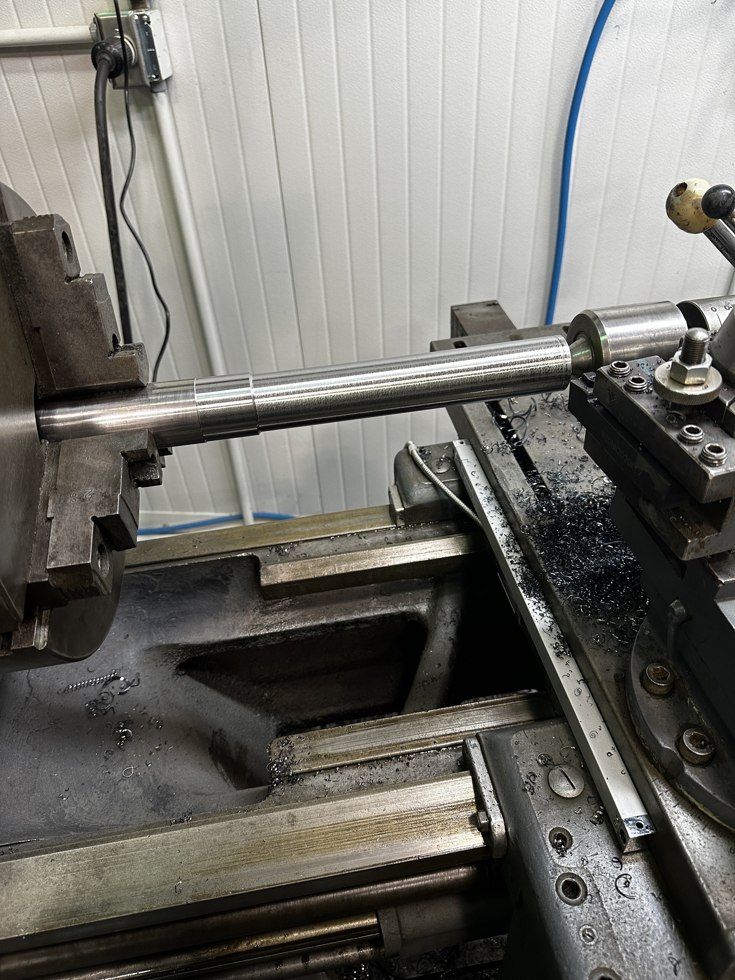

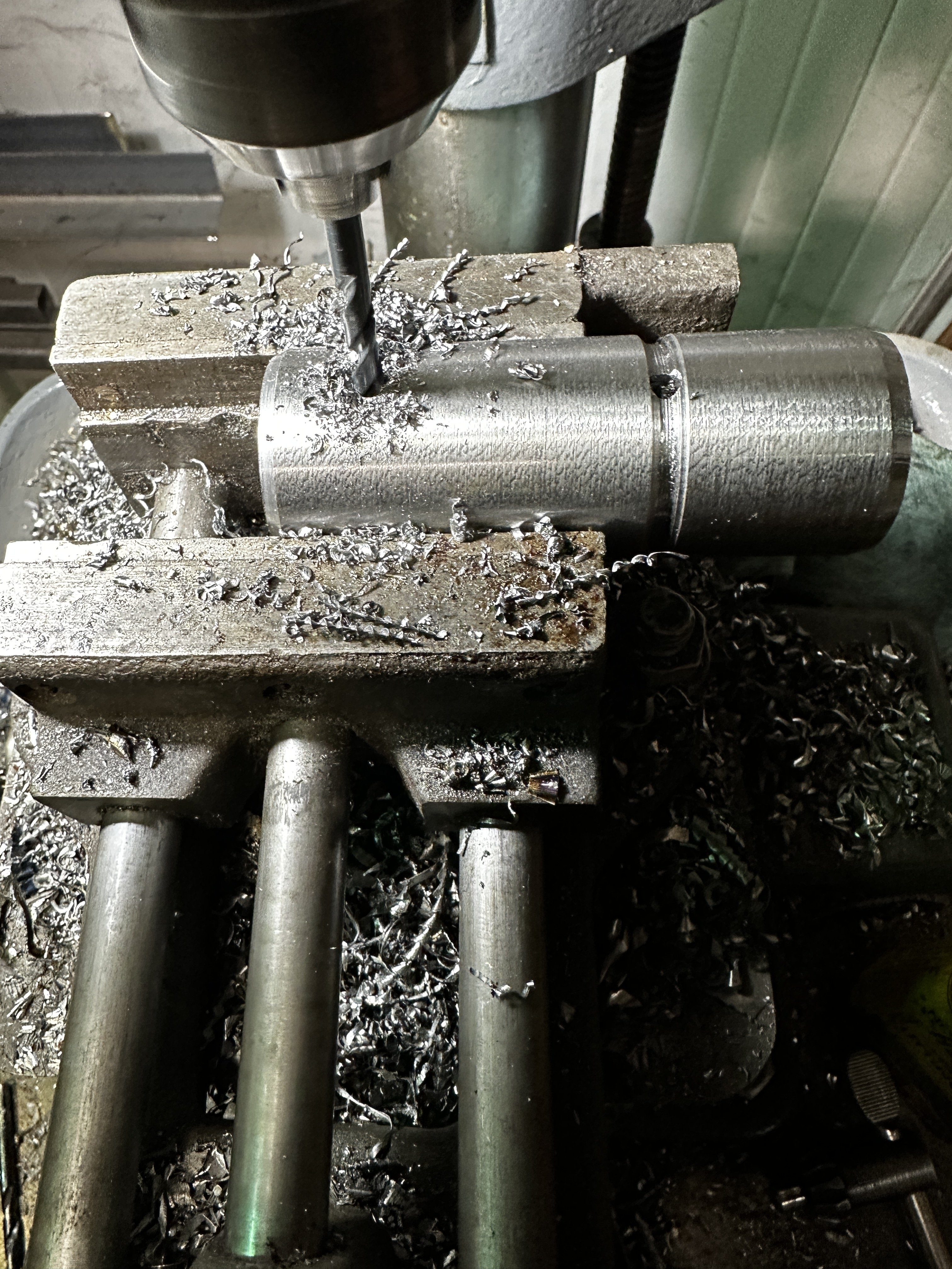

Well, I finished the VFD conversion on my lathe. So that allowed me to make the lower pins for the clam cylinders. I had reamed the worn cylinder base holes and the ears on the bucket as well. The pins are now ready made from 4160. Oversize to match the reaming and I drilled them and grooved them for grease fittings. Now to make the other stainless tube that supplies the clam cylinders.

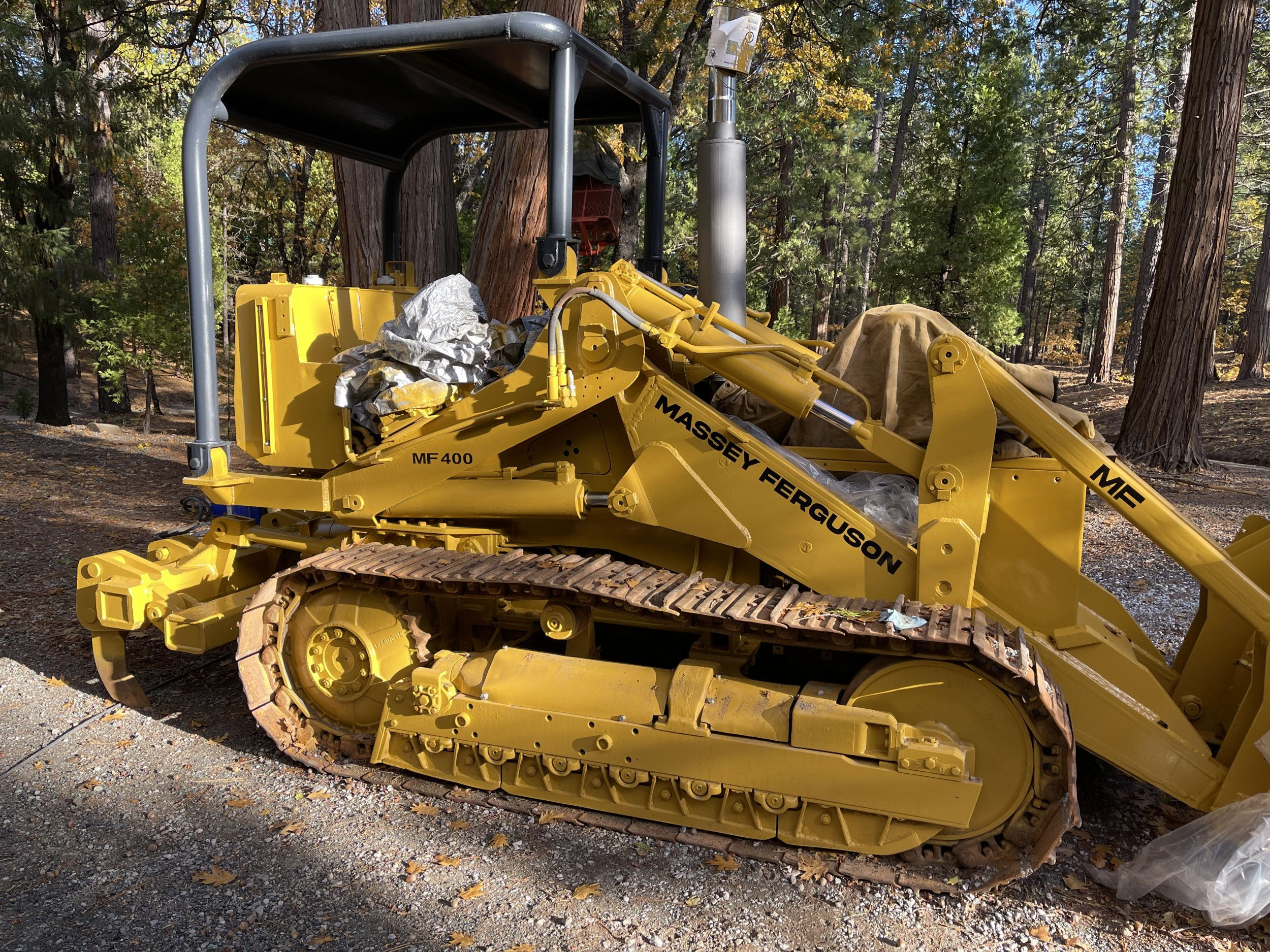

Well working on the Massey has been on the back burner. Thinning trees and burning while the season permits is a front burner item. I did install the clam cylinders and hoses. Not much but more soon. I did make a poor video of it running. No one to operate the camera but me so it’s not great quality but at least it sounds good.

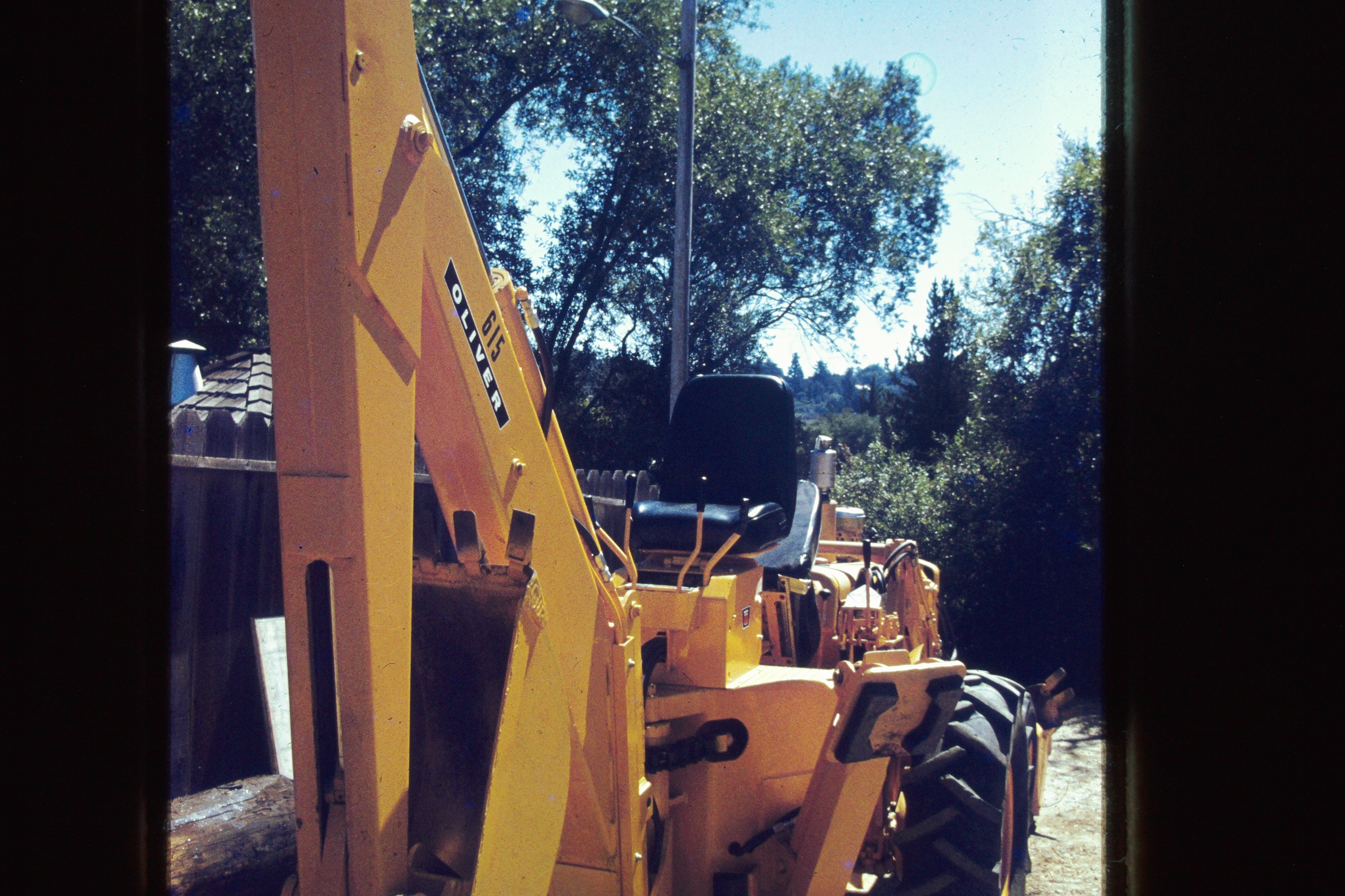

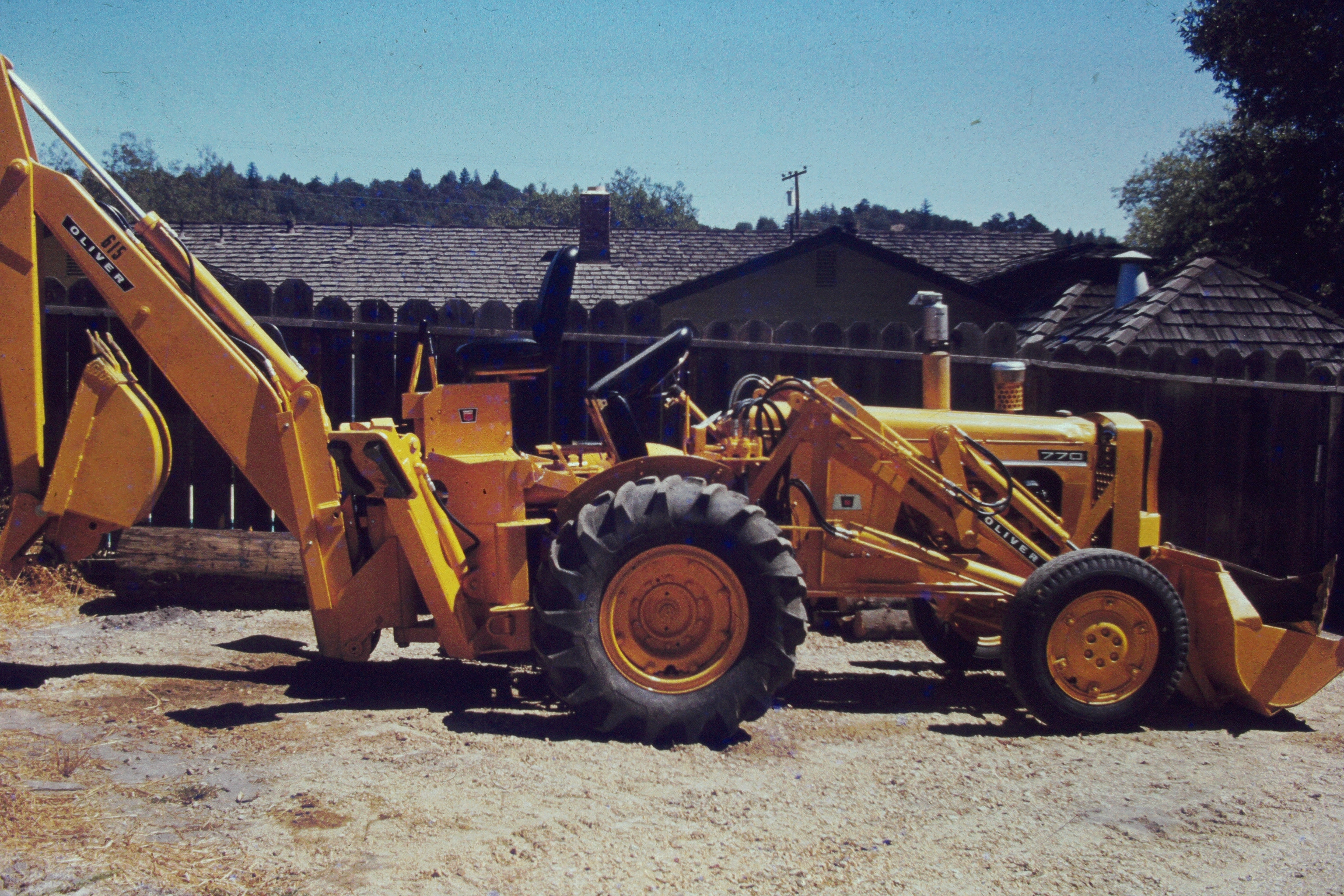

The poor Massey is awaiting my attention. Been doing stone work while the weather permits. While this isn’t a Massey it’s worth a couple laughs. This was my first restoration without many pictures since it was before the digital age. This was 1977. The original stabilizers didn’t fold up rather they came up part way then you had to manually telescope them in. So I made the ones you see including the cylinders. This was a four stick machine and I made linkage and levers to convert it. I also made the linkage and levers to make the loader one stick. Waukesha powered. The pins and bushings were so loose I cut out sections of the boom so I could put them in the lathe for repair then welded them back in.
/ Another Restoration Project #140
It scares me to see a backhoe without ROPS. Do you still have it?
