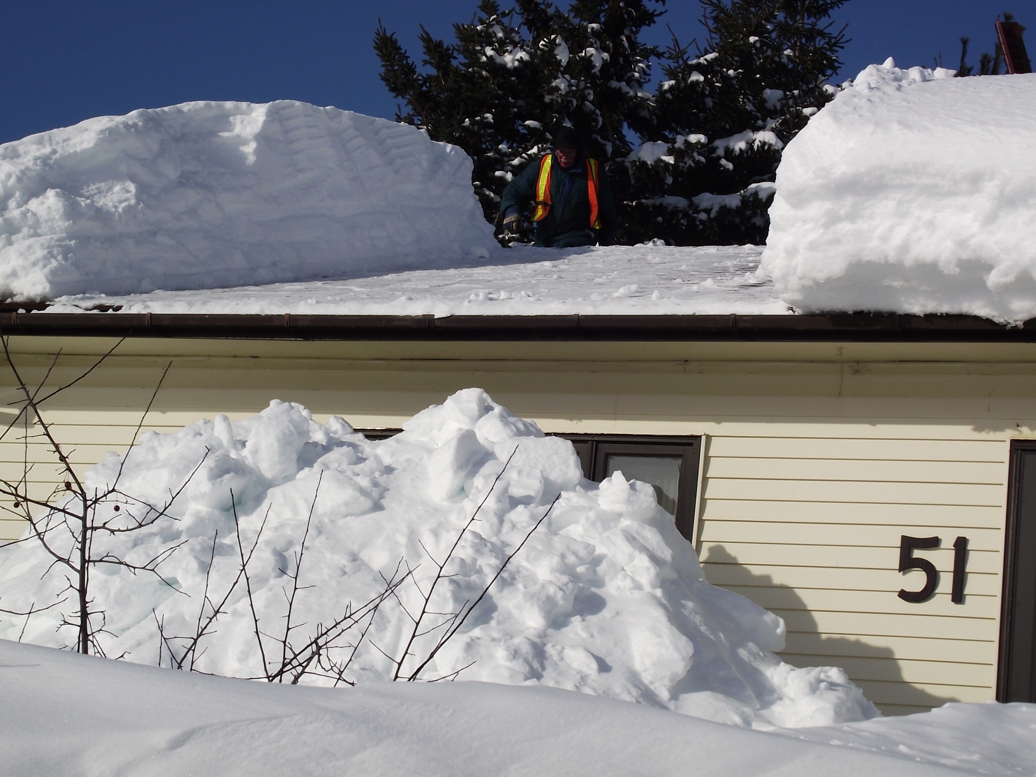

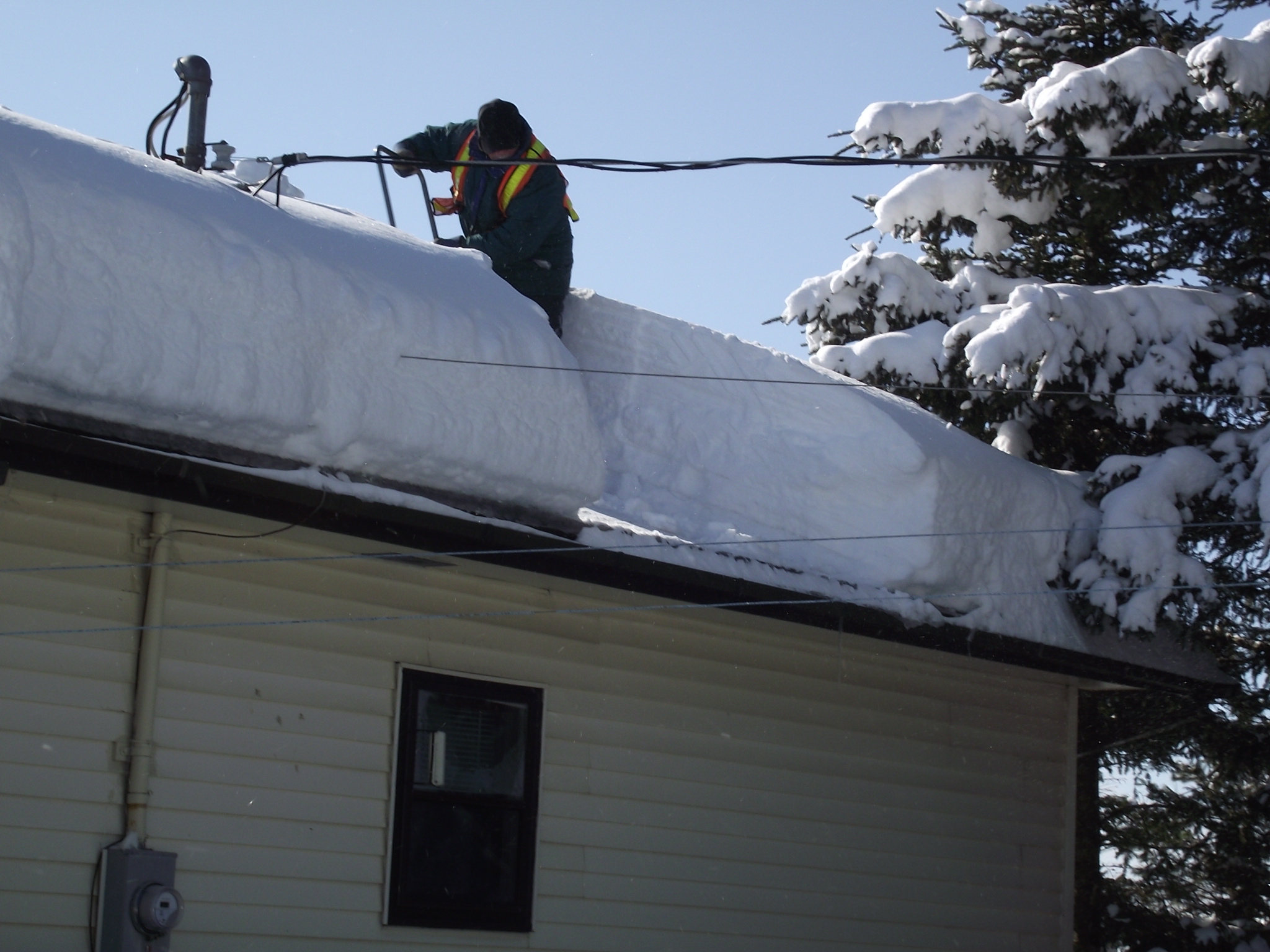

You're right there - snow is snow. I got up on the roof today and started shovelling, but I took a sample with the Arkansas coffee can method before I started just to see if it compared with my 12"x12"x12" cube. Still waiting for the bucket of snow to melt for the results on that. I'm more worried about a rainstorm coming along and wetting down what's up there now.
I got about 1/3 of the roof cleared, now I,m beat.:( More to do tomorrow, and I've got to knock down the pile in front of my south windows - that's my #1 heat source.

Gizmo - thanks for the great link. I have a good 3 feet of snow on my roof now, but my design snow load is 77 lb./sq.ft. I was concerned about how much 3 feet of snow weighs, so this morning I cut out a 12" x 12" x 12" cube of snow, packed it in a bucket and weighed it - about 10 lbs. (which is about mid-range in the Arkansas link you provided). So I have about 30psf on my roof now, but if it gets rain-soaked I may be approaching my roof design limit. Interesting!

The snow in my Arkansas coffee can test has melted and the depth has been measured - 8" of water, which works out to a snow load of 41.6 psf. This is higher than my estimate based on my 12" snow cube, I am sure because my cube was higher up in the pack and did not account for the more densely packed snow at the bottom. Back at it again today, before there's ever a chance of that getting rain-soaked.

I built this house myself in 1981 and it's based on the 1980 National Building Code of Canada. The roof design snow load is equal to the ground snow load for this locality multiplied by a factor that accounts for the roof slope. Our ground snow load here (at least in 1980) was 75psf.
I keep an eye on a bedroom door that has a rather tight tolerance with the top of the jamb (I'm not much of a carpenter now, I was even worse back then:eek:). If it starts to scrape a little more than usual, that probably means some deflection in the roof trusses above it. It did and now with the snow gone it is less sticky (1/64" or less deflection).
Both plumbing vent stacks were covered, but had melted snow caves around them. The wind turbine ventilator was also covered, but that's no big deal since the inlet grills are closed off for the winter. The chimney for the wood furnace was high and dry.
I heard on the radio that we are within a few inches of setting a record for ground snow cover. The current record is 161 cm. (63"), and that was dumped on us in two storms over five days in 1992.
I'm about 70% done clearing now, hope to finish tomorrow. The deepest I've encountered is 42", however it's only about 16" at the peak. I figure I've already shovelled close to 16 tons off the roof. Next job is the garage.:(
