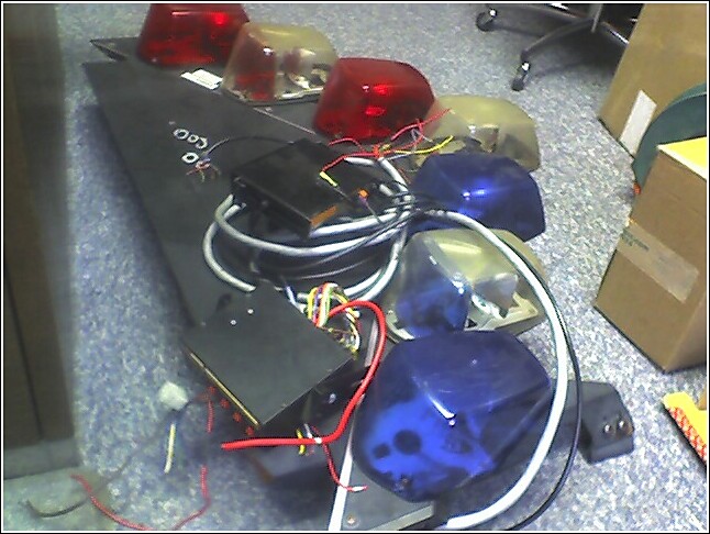

I wanted to add a "light bar" to my snowcat with a couple of rotating amber flashing lights. A police officer I know got me a used Federal Signal "Vector" lightbar with all the bells & whistles that is about 4' wide, over 2 feet front to rear and about 10" tall. It had "alley" lights, "take down" lights, a directional bar, and 7 rotators all with police issue red & blue domes. I looked into the power requirements and the lightbar and controller used something over 50 Amps when it was fully lit up! :eek:
I ended up trading it for a low draw amber strobe light. :p
Pictures 1 & 2 show the lightbar. Picture 3 shows my Snow Trac with the amber strobe that is a lot more practical for my use!
