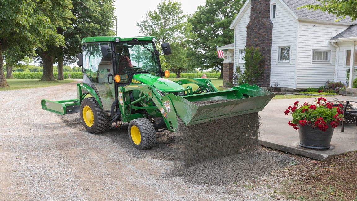

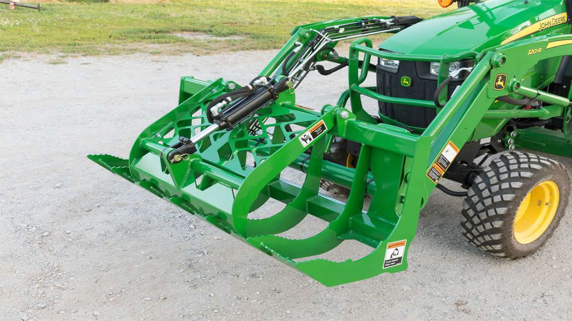

This thread on Green Tractor Talk caught my eye.
I'm considering adding either the AV20F 4-in-1 or AY11F Grapple along with the required third function hydraulics option. Not sure which of the two I would get better use out of. If the third function addon was available now I'd consider getting both (with the AV20F 4-in-1 in place of the standard bucket).
