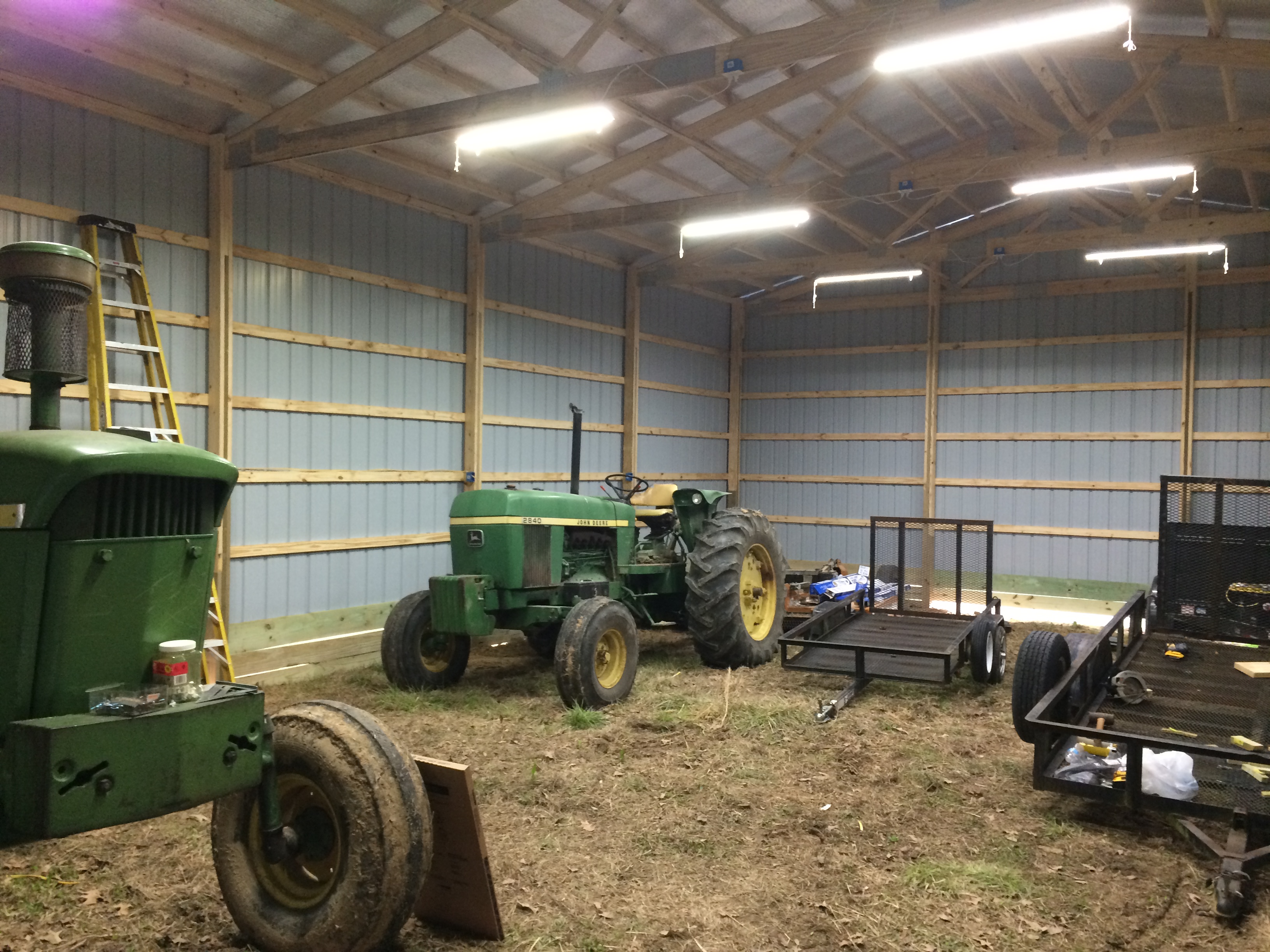

36” leds, not sure lumens but it’s bright in there.

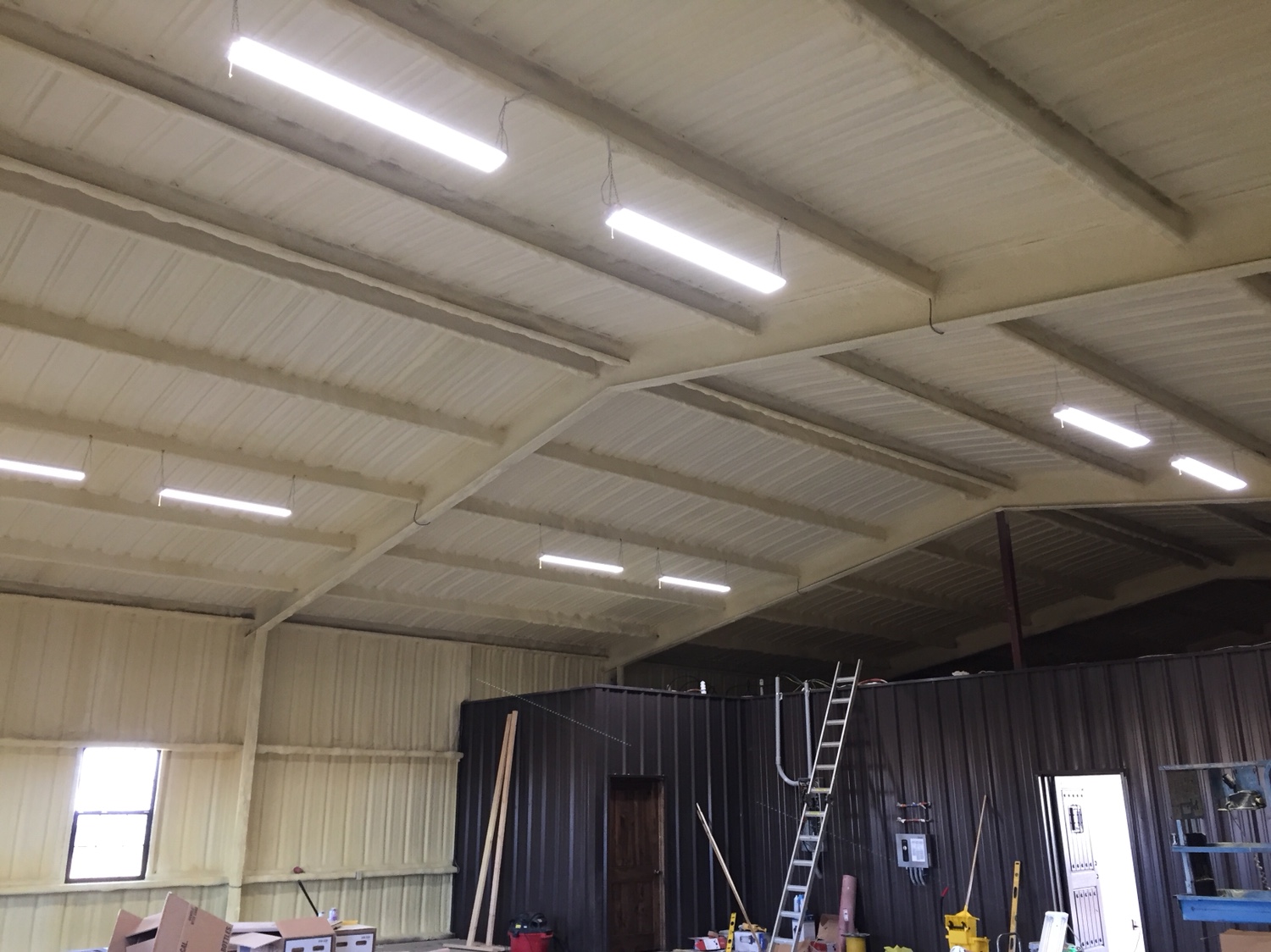

I’m def not going to miss messing with the fluorescent tubes at all!
/ Another Shop Lighting Thread #29
Me neither. My lights are 16’ above shop floor and there’s nothing about a 14’ step ladder I like. I’ll worry about them in 50,000 hours.
