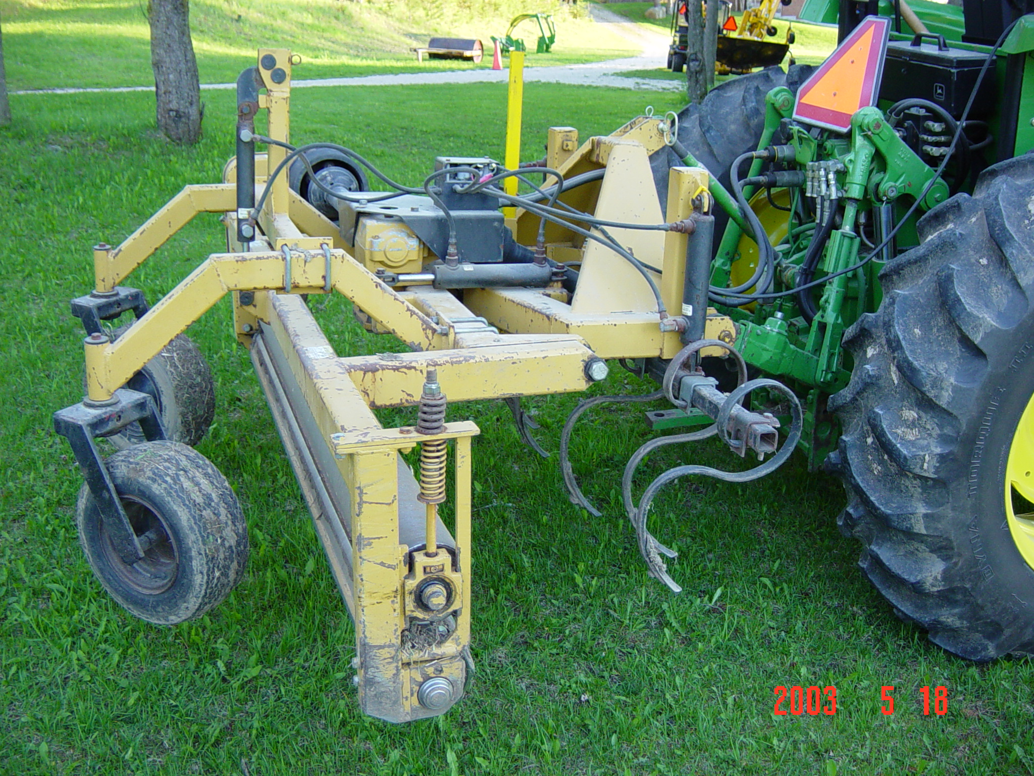

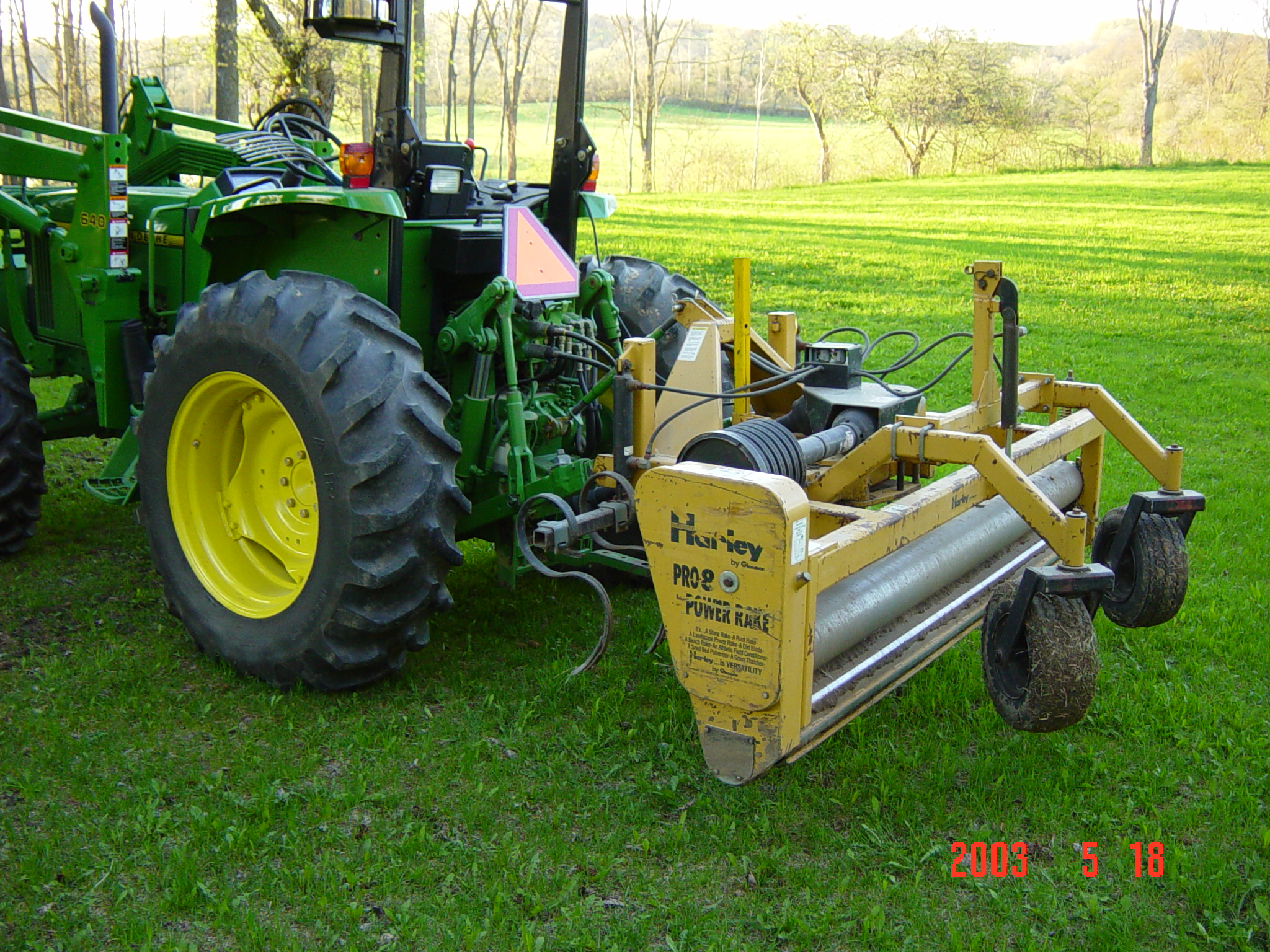

I have an eight foot harley rake. The good one, with the two rollers and S type scarifiers. Great machine, but you would basically need to start again.
It would certainly destroy your sod and windrow the debris. But depending on the area, you can only windrow it so far effectively. Then you need some way to pick up the windrow.
I have maybe a half acre lawn area, I too would like to smooth out. I would disk it first (not that own a disk) and then pull a drag around. Then use the Harley. A Preperator that goes on a SS also works well and has the bonus of collecting the debris as you go.

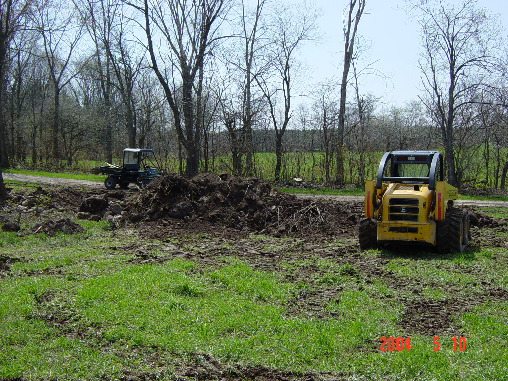

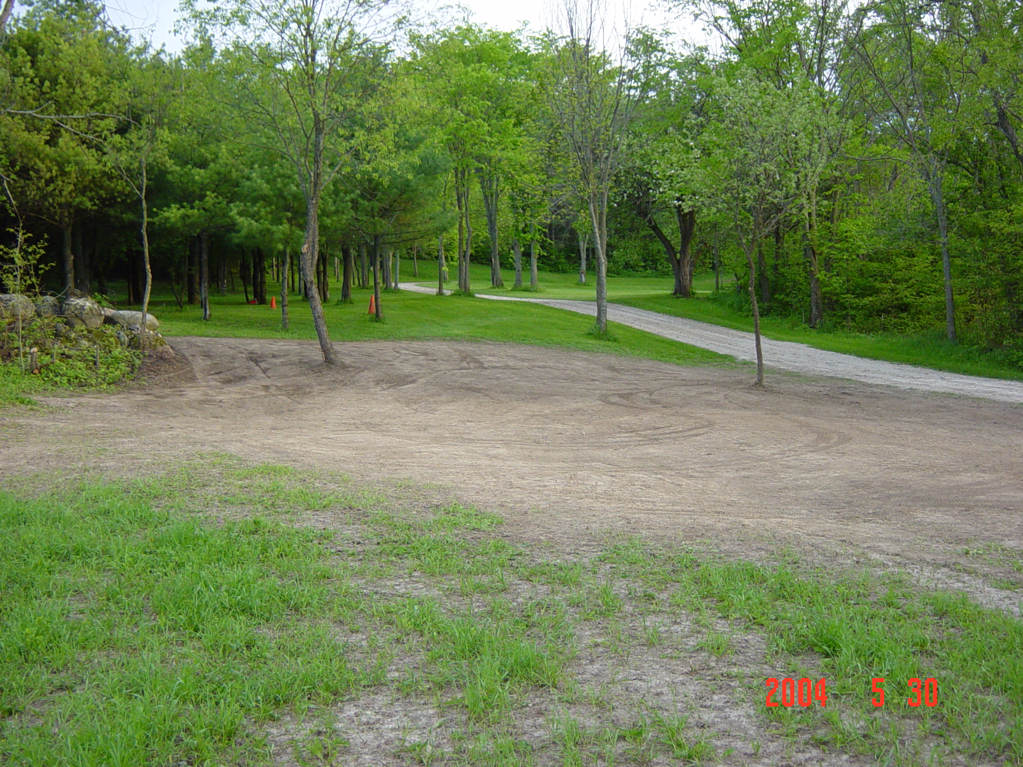

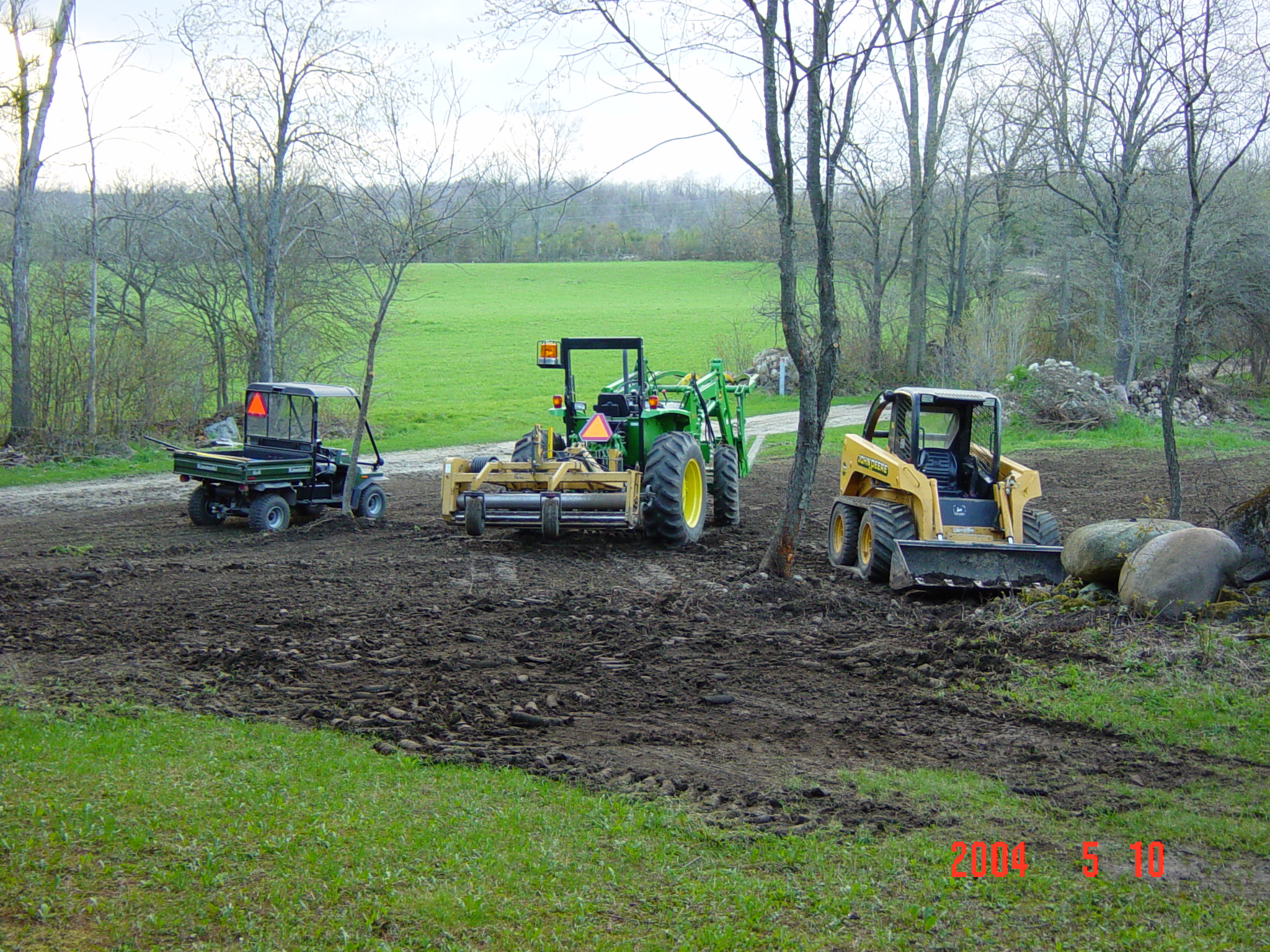

This is a job I did with the Harley. That's actually a small part of it! A bit much actually. You don't know when to stop. With the Harley, your first pass always seems the best and everything else seems like diminishing returns for the work your doing.
   / Another "smoothing lawn thread" #10
Here are more pics of a job at my place. Before and after. I think final pic is seeded and rolled. Borrowed SS.
