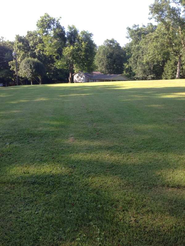

Not sure if someone posted this, but I use my box blade to level. I pitch the front up so the rippers and inside front blade are above the ground, with the back blade dragging the ground. I then place small piles of dirt/compost around the rough area and drag through them. The box captures the pile and the back blade dragging spreads and places the material in the low areas while riding over the bumps. I pitch it up so there is about 1/4 to 1/2 inch below the front blade to the top of the hard grass surface. You can go lower to trim mounds in the process, but the key is for the box to be fully resting on the back blade. I then seed and drag the harrow over on its back in a smoothing operation.
With horses I have plenty of material to get rid of and this works well without buying another piece of iron. I also have added more weight to the box using concrete blocks to get better results.
