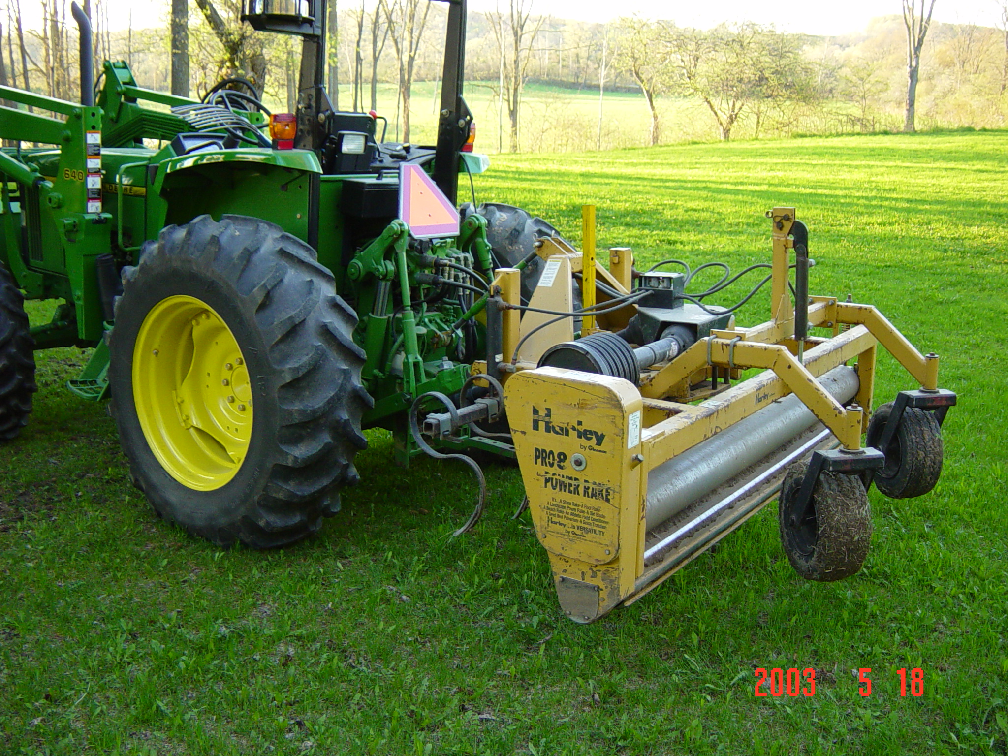

The Frontier power rake has a 250-275 RPM. Probably close to the Harley in speed but from the looks of it speed is the only comparison. It counter rotates but has a shield instead of a top roller.

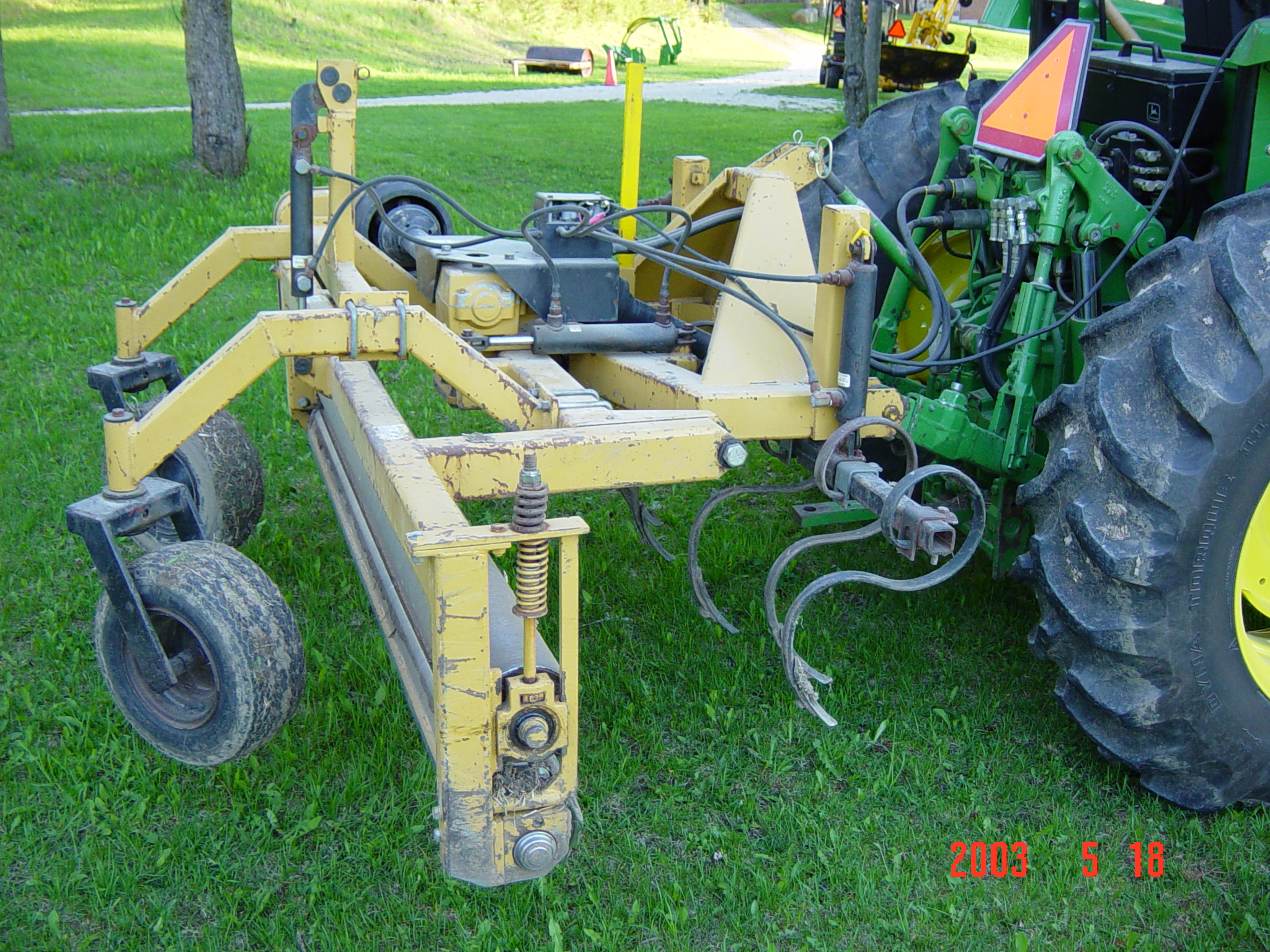

SitePrep Demonstrates the Harley Rake - YouTube
1:45-2:00 mark
Just seems a whole lot faster than 250-275?? Maybe not.
My tiller is counter rotating, (reverse rotation), and runs 180RPM. With it being larger diameter, the blade tips are probably spinning faster than the harley rake.
The tiller dont do a good job. Almost hard to believe that a harley rake does a better job with knubs instead of tines. Especially spinning that slow.
/ Another "smoothing lawn thread" #30
Watching the video it does seem faster. This one has the nubs and some I've seen have the horizontal bars and one I seen has bars formed into a slight V shape (elongated V). All of them appear to do the same job. Maybe somebody will find time to count the RPM that ownes one.
If I were to build one I'd probably opt for the one roller with a adjustable shield instead of 2 rollers. Either way it seems like it would be a dusty ride especially on a skidsteer with no cab.
