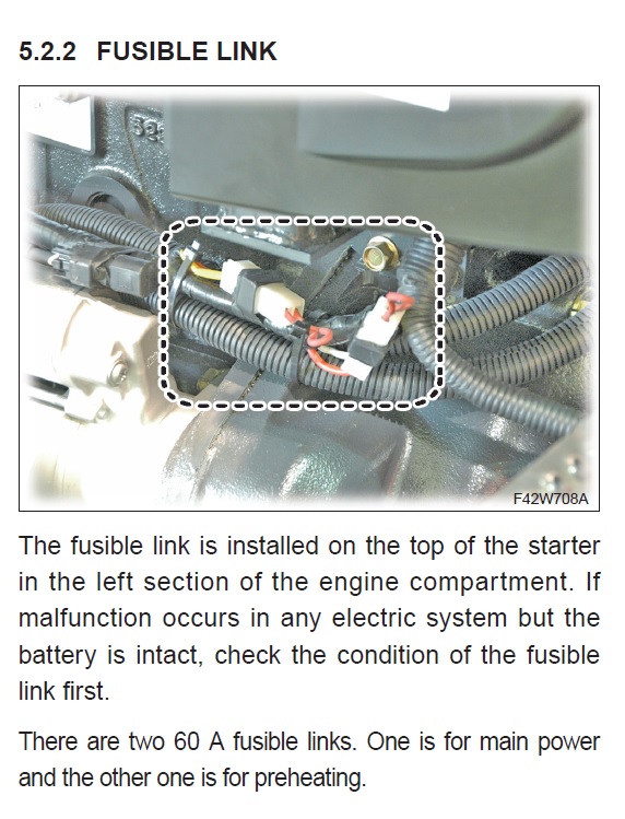

Check for fusible links.
I don't know about Kioti in particular, but Branson uses some fusible links for the starter and some other applications.
Here is an example:

if the fuseable link was inline somewhere before the starter there would be no click.
most fuseable links come directly off the battery or positive starter post to feed the fuses.
you would also have other items not working
