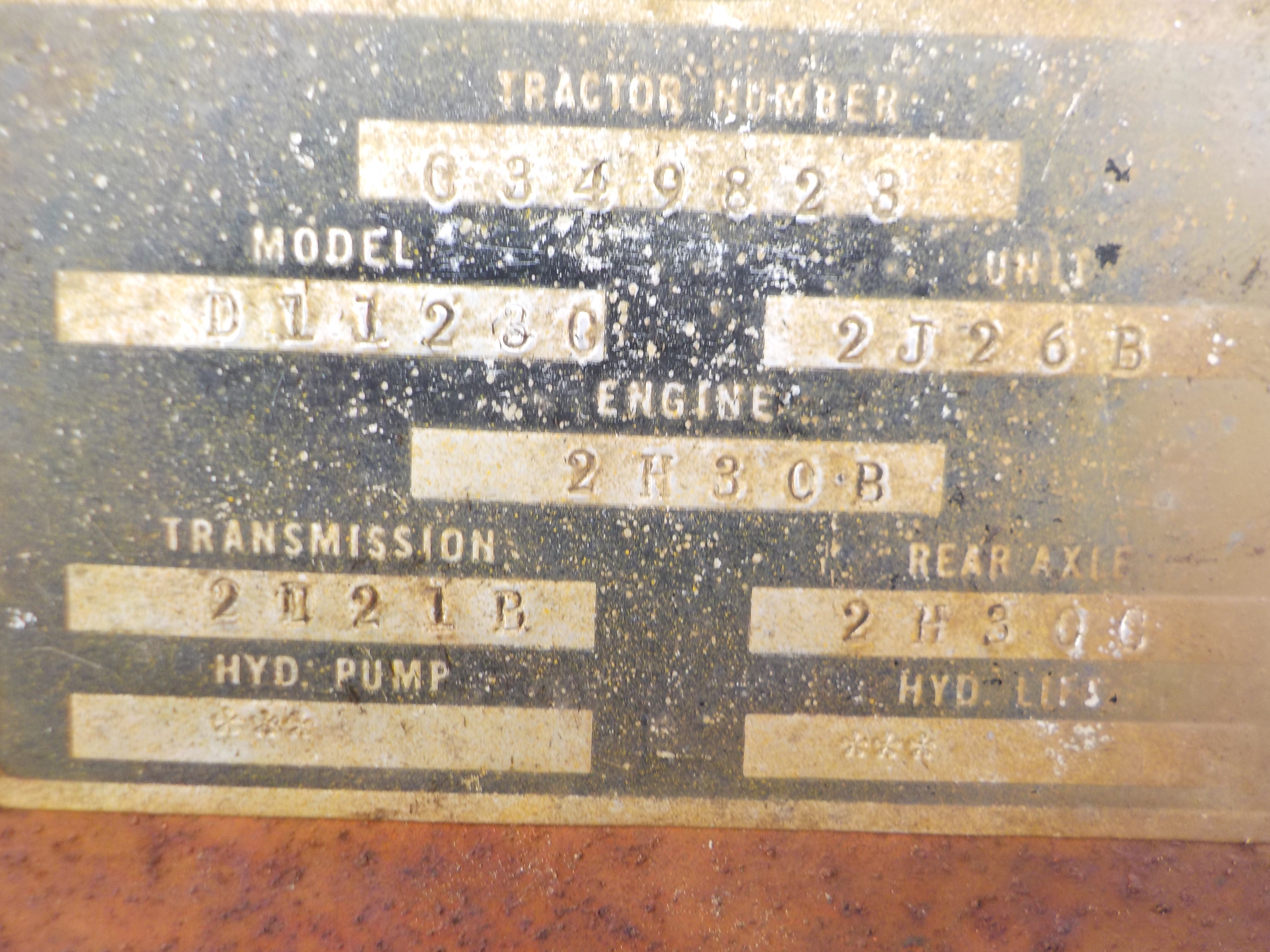

I had posted Pics in the General Tractor Forum before see this FORD Forum... I just Picked the FORD Tractor up from a neighbor. Story is, she was basically pushed aside when they got their new KOBOTA and has been sitting for 5 Years. I decided to take a gamble on it, knowing that the Rear Tires were worth the Price... I Got it for $500 DELIVERED! I am really a IH Man and know Very Little about FORDS. The attached Pic is the ID info under the Hood. I ran the #'s and NONE make any sence at all. I don't know where to look for any other ID #'s. Can anyone help me ID this Tractors Model and Year Please.

I not a square nose guy but looks to be a 4000 LCG (low center gravity)
Here's a site that might be helpfull
FORD CODES and SERIAL NUMBERS
Kirk
/ Another UNKNOWN FORD TRACTOR ..HELP PLEASE #4
Link kirk posted has all the info. Model code is D11223c
D....68 or newer 4000-series
11.....LCG (low center of gravity
2.......Gas
3.......Live PTO
C.......8-speed trans.
2J26b is the units build date
2 = 1972
J = Sept
26 = 26th
B = dayshift
Serial number confirms the date. 1972 started with C327 and ended with C367
So..............you have a 1972 ford 4000. Nice tractor if you get her running
