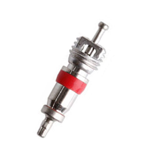

It is much easier and quicker to pop the bead on the rim if you remove the valve stem, add air until the bead locks itself onto the rim, and then re-install the valve stem. Then you can inflate the tire to its proper psi.
That’s useless if the bead is off the rim and won’t seal which was the point of the ratchet strap. The other options are a bead blaster or starting fluid but the ratchet strap is cheap and non violent.
Just so there is no confusion for the inexperienced, only remove the core from the valve stem:
If you don't have the tool, get a core removal cap:
Maybe I wasn,t clear enough in my explanation. You still use the strap in the middle of the tire, and then follow the rest of the instructions. Xfaxman added some great info as well.
Does that make more sense now ?
