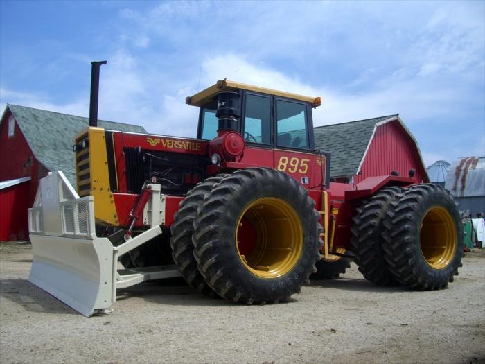

Hey All,
I'd want the county to do it with real snow equipment - you do pay taxes I assume. Otherwise I've no real idea but it better be a snow eatin and blowin machine cause in a bad winter your not gonna pile that much. Just for fun though this unit is about $33k for 4wd and 310 hp. Buy chains for all 8 tires and your good to go. Oh even has new AC! :D
-Ed-
