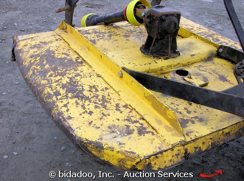

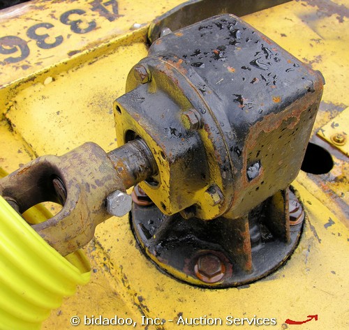

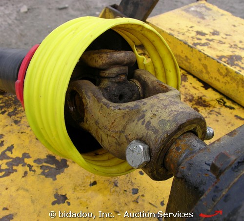

The rust appears to be mostly cosmetic. The unit is bent up pretty good on the left side it looks like. I would go maybe 200 at the most. The first thing you need to do if you get it is take that bolt out that is holding the pto shaft to the gear box and put the appropriate shear pin back in there. (I would imagine that is what is supposed to be there)

Yeah I noticed the "Shear pin"bolt. There is about 1 more day left on the auction. LIke I said I really don't need it but it is fun to bid on things and get a good deal once in a while. It does look like it has been well used.. Let's see aluminum is going for .25cents a pound. So at .17 cents would be about right for scrap iron:eek:
/ Another what's this worth question #5
From here that looks like a Cat 5 bolt for a shear pin which as you said is a problem. Of course on the other hand, I'll bet you don't have to replace it that often.

I thought the PTO shafts with shear bolts had the shear bolt on the front part of the shaft with a fitting with bearings in it. That way if the bolt breaks the shaft isn't flying around all over? If not I would be putting a clutch on it.
Lee, it may not be the right bolt, but it's in the right place. The end of the shaft coming from the gear box should have a groove with a split ring retainer that keeps the shaft from coming loose if the shear bolt breaks.

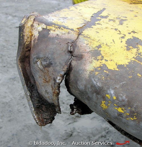

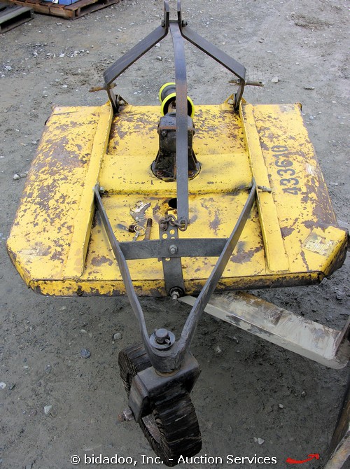

Yes the bidders do wait until the end sometimes. Right now it is at $102. It does have the stump jumper wheel. Here are a few more shots. You can see the metal that has been torn. That probably could be welded up easily enough. If the price goes for more than about $150 or so then I will pass. I can borrow one from a friend that is about 20 minutes away if I need one.

I bought a really nice used Ford bushhog for $300, and that was back before the economy went to pot. I'd look for something in good used condition used and bargain. This thing looks like every part of it is bent. The drawpins look like they're bent, actually the whole support frame looks bent. The tail wheel support looks bent. The frame area under the gearbox looks like it's pushed down, sort of like it's been oil-canned. Maybe some of this is an optical illusion due to parallax in the photo. I wouldn't pay $80 for it unless you're looking for a hobby fixing it up.

Just as well. . . . What caught my eye was the oily top of the gearbox. I have lots of gearboxes, but none with oily tops. That indicates to me that they are adding/spilling oil on top of the gearbox as they add oil, probably everytime it is used due to a leaking seal. Heck! I wish you were closer. I have a lot better looking KK 5' cutter I'd sell you for $200 and you wouldn't even have to bid on it. Mine needs a tailwheel axle bolt and it's good to go. If I go to the trouble to fix it, I'll probably put it in the local "shopper" magazine for $250. . . or maybe $300 and come down so the buyer thinks they got a good deal.;)
At first glance I thought that was oil or grease on top of the gear box. Looking closer it looks like black paint. It is peeling off in a layer. Thanks for the offer to sell me yours.. Let's see if you are following one of the other threads about putting tractor motors in cars or trucks and I got about 50 miles per gallon. Driving round trip to Texas would take me about 80 gallons?:) Maybe I will keep looking locally. My 1988 Chevy get's about 7 miles to the gallon :eek: and the 2006 Dodge Hemi is getting about 14.
By golly, I think you are right.:eek: The water beading up kinda threw me off. I still don't think you lost much by not winning the bid. Too darn bad you aren't closer.
