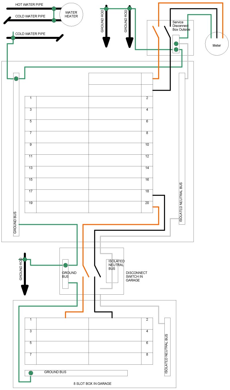

I'm hoping you can answer one more question for me here. The 2" galvanized riser pipe going up from the meter base to the weatherhead extends about 9' above the roofline on a gable end. It's strapped to the building below the roofline but I want to secure it against the weight of the service line from the transformer pole. I don't know whether they'll use #2 or #4 but it's about 125' so some weight will be involved. Add to that some snow, ice and high winds and I forsee the need for additional support.
What I wanted to do was run some type of cable from the riser to a big I-bolt in the top of the 6x6 at the peak of the roof. The run from the transformer pole to the weatherhead is probably 20 degrees off from the line of the gable end and is over the roof edge as opposed to away from the building.
If I haven't confused this totally by now, here's my question. Would the plan I outlined work and if so, what kind of cable should I use? I'd thought of galvanized aircraft cable with a turnbuckle but didn't know what size I'd need.
Thanks for all of your help on this.

Yes you definately need some rear support there. Preferably about 3' down from the top. I would imagine a 1/4-5/16" cable would do the trick. Make sure it's anchored securley to the roof in as straight a line as possible with the service drop. May even want to do 2 of them at angles. Just my opinion without seeing it.
/ another wiring question #49
Jerry, I just wanted to thank you for all of your help on this and tell you I'm calling for the inspection first thing Monday morning. /w3tcompact/icons/smile.gif
I strung 1/4" galvanized aircraft cable from near the top of the riser to a 6x6 near the peak of the roof. I'd guess the angle is no more than 15 or 20 degrees downward from the riser. I'm probably 30 degrees off from the line of the service drop but that's where the transformer is and I couldn't move it or the building. /w3tcompact/icons/smile.gif
To attach the cable I ran one end through the mandated support for the power company drop from the transformer pole. I mounted that near the top as it has to have the support cable from the transformer cable attach to it. I attached my support cable on the riser using a wire rope thimble and secured it with a cable clamp. I then drilled a hole and ran an I-bolt through the barn exterior and through a 6x6 and attached a turnbuckle to it and the cable to that. I had the turnbuckle extended to the maximum, looped the cable through the eye on one end, pulled it as tight as I could and secured it with a cable clamp. Then I tightened the turnbuckle to bring it really taut. It worked pretty well. /w3tcompact/icons/smile.gif
