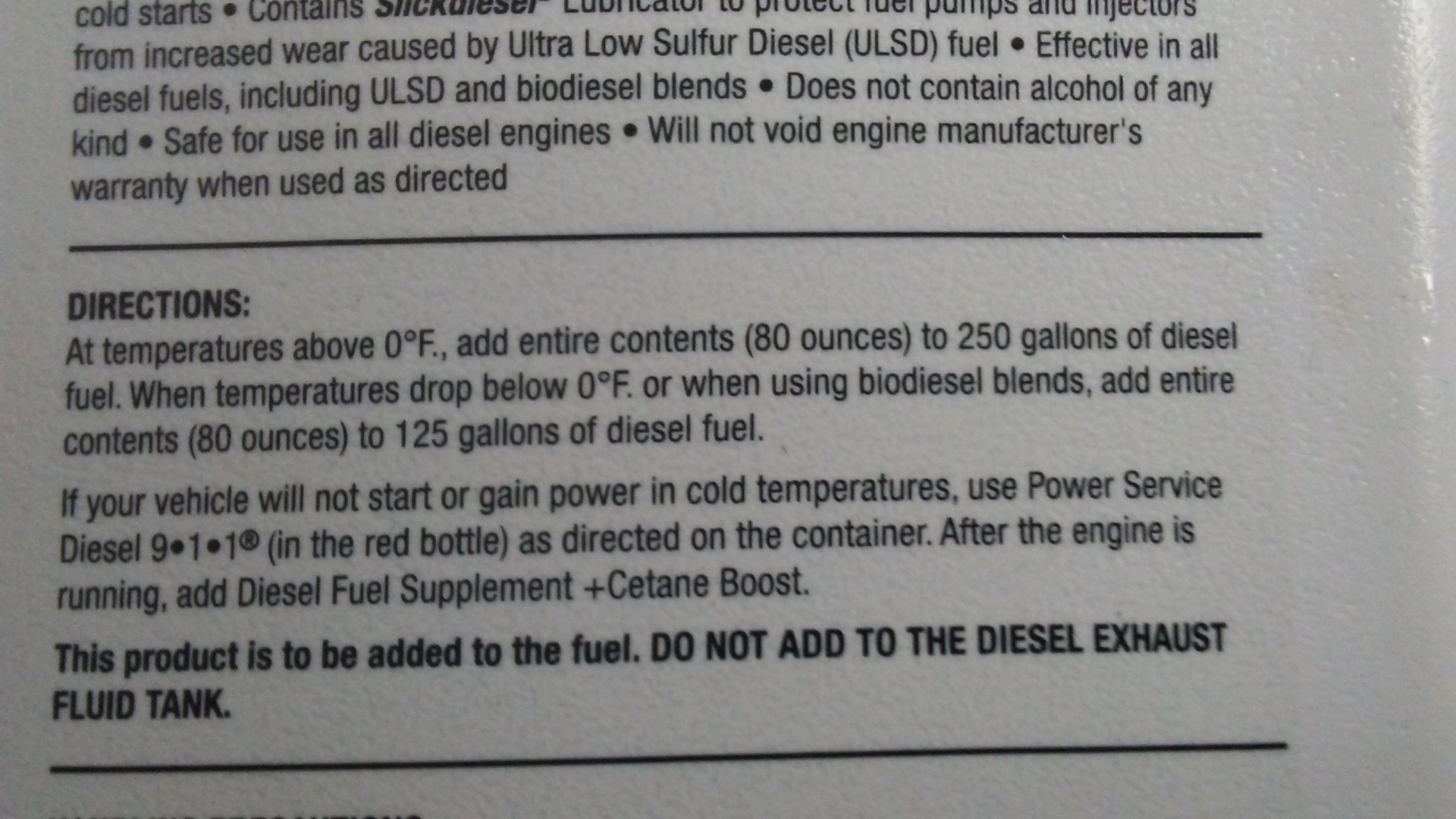

For sure, I got to the 3.2 oz per five gallons of fuel by the only figures listed on the bottle. The entire 80 oz bottle will treat 125 gallons of diesel at temps of zero or colder. It works out to be 3.2 fluid oz of PS per 5 gallons of diesel fuel.

Howes was recommended to me by a heavy construction equipment O/O. It surprises me that PowerService does not also have a recommended additive amount for different temperatures on the bottle or website that I have found. Somewhere I read that adding more additive than recommended would not harm the engine. I believe that applied to only PowerService White bottle; maybe the grey/silver bottle as well.
Not sure about smaller bottles but the 80 oz. bottles of PS I buy do recommend different doses for weather below 0 F. Pretty much double the amount.

I'll admit, a few years ago I thought about changing from Howes back to Power Service. There I stood in the store, a bottle of PS in my left hand and a bottle of Howes in my right hand, comparing the directions. It didn't take long for me to realize I could read and understand the dose on the Howes bottle much easier AND without my glasses. Sold!
