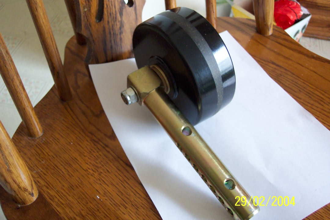

I finished one wheel of my version of the solution this morning.
This attachment is the wheel as it arrived from Castercity.com. Hat bushings are for a 3/4" axle. After finding it impossible to find off-the-shelf 3/4" axles that would step down to the OEM threads, I decided to go with the OEM axle, so I ordered more parts.
See folowing posts.

woops. pic did not attach.

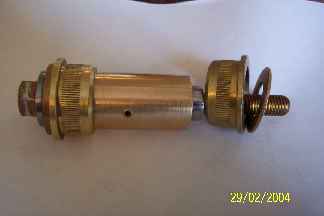

I ordered 1" by 3/4" sleeve bushings from McMaster.com.
Surprise....when I removed the original hat bushings from the
wheels this morning, I found out the the ID of the wheels is actually something like 1 3/16".
So, to get creative, I decided to use the hat bushings and sleeves together. To make them fit, I bored out the hat bushings from the original 3/4" to 7/8" (largest bit I had) on my drill press. Then, I mounted the sleeve bushing on my drill press and sanded the OD from original of 1" down to 7/8". ALso, I mounted a new OEM axle on the press and ground/sanded the axle OD down to 5/8" (removed ~0.004" according to moweraxle's SAE/metric conversions).
Attached is a pic of this step of the process completed.
Note that I have already drilled a hole in the sleeve bearing for greasing later. I bored all the way through so there are 2 holes. Note that there will be a hollow space between the hat bushings that will be full of grease at all times.

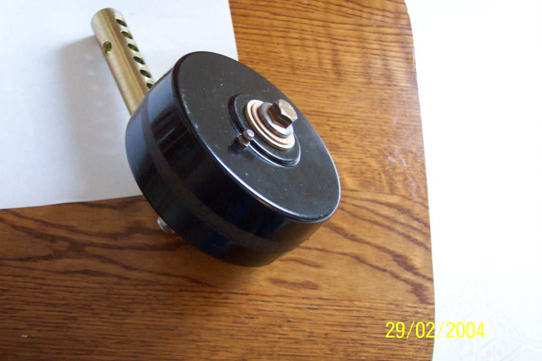

Here's a pic of the completed wheel, including grease fitting.
There's a 1/16" washer bushing on one side and a 1/8" washer on the other. I had to grind/polish the 1/8" washer down to ~3/32" to get a good fit. There is only a TINY side to side looseness to this assembly and the wheel turns freely. I wanted minimal play in hopes that will help keep dirt out.

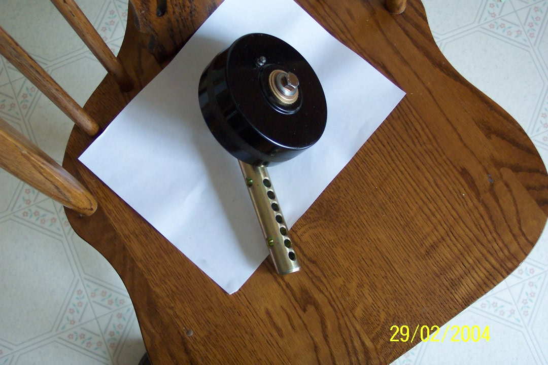

Another view .

last view
   / Anti-Scalp Roller Mod's?
#80
Re: Anti-Scalp Roller Mod\'s?
Forgot to mention another thing....the hat bushings are VERY snuggly friction-fitted to the spanner bushing (think hammer and 2X4). There is no movement between those bushings.
Obviously, this is a 'make do with what you've got' solution since I had already bought bunches of parts and did not want to go order more.
This solution will work great if we do one of 2 things below:
1) Find hat bushings that will reduce from the ~1-3/16' ID wheel to the OEM 16mm diameter. Then, installation would be a 10 minute job.
2) Talk Moweraxle into machining new axles with 3/4" axle dia. and OEM threads for attachment to the column. Actually, the threaded end could be made slightly larger, requiring only some minor boring of the columns. I think this would be the best of the best solutions. Then, we would have a vastly superior wheel, larger (stronger, more wear resistant) axle, and minimal work to install.
Moweraxle, got time to machine me some axles if I provide some dimensions?
roger
comments?
