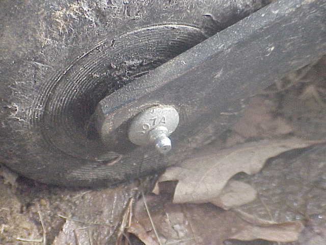

Your modifications are impressive. The only fly in the ointment that I can see is the sharp edge on the wheel itself cutting into the turf on turns. I believe that is why Kubota built the wheel the way that they did.
What I don't understand is how is the grease going to get from the grease fitting to the inside of the bearing to the axle. I understand that you are filling the cavity, but how will you get sufficient amount of grease between the bronze bushing and the axle itself to keep it properly lubricated? Wouldn't it have been better to put the grease in /forums/images/graemlins/confused.giffrom the center of the axle? I am certain that if I had it in my hand, I could figure it out, but I believe that there is something missing in the pictures. Or.... possibly, it is one of my senior moments in time that is confusing me..... /forums/images/graemlins/blush.gif
/ Anti-Scalp Roller Mod's?
#82
Re: Anti-Scalp Roller Mod\'s?
Junkman,
Refer to the attached pic.
See the knurled fittings of the hat bushings on either end of the tubular bushing? (2nd hat bushing is not installed because I have to install the wheel 1st before pressing on the 2nd hat bushing). See how the OD of the knurled section is larger than that of the tubular section? The knurled part is what friction-fits into the wheel ID. So, since the tubular part (where the holes are drilled) is smaller dia. than the wheel ID, there is a ~1/8" doughnut void that is formed. The
grease fitting will supply grease to this doughnut area. Once the doughnut is full of grease, additional pumps of the grease gun will force grease through the holes drilled into the tubular shaped bushing....where the axle is located.
With a little luck, as the wheel bearing area heats up during use, the grease in the doughnut area will warm up, expand, and additional grease will be forced through the drilled holes into the axle area.
I e-mailed Moweraxle a while ago to see if he would be willing to make me up some 3/4" axles so that this installation will become a piece of cake. Will update later.

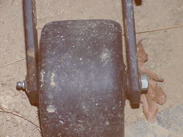

As I said in my previous post.....been there, done that. I tried steel hub, rubber wheels, phenolic wheels, and finally, plastic hub with rounded rubber tire and stainless steel roller bearings.
I've used the plastic hub, rounded rubber tire, stainless steel roller bearing wheels now for a year and a half. They are holding up fine....a little grass stained and maybe some dog doooo, but other than that, they have been great....and yes, I run them on the ground all the time. They don't have grease zerks, but I packed the bearings at the beginning of the mowing season and they just keep on rolling.
I tested the steel wheel, rubber tire combination, however the tire was more flat with squared corners and the corners or edges seemed to take a lot of abuse from an occasional rock or the edge of the sidewalk, etc. The phenolic wheels are also succeptible to chipping, gouging, breaking the edge of the wheel.
It has been my experience that the plastic hubbed rounded rubber wheel combination has been a very good solution. I would think that with the addition of a drilled and tapped axle this would be the answer the the anti-scalp wheel solution.
Attached is a picture of the plastic/rubber wheel. They also have an aluminum hubbed wheel with rubber tire with grease zerk and stainless steel bearings. The only fault of the aluminum wheel is the flat tread and squarish edges....as stated eariler, the edges tend to take a lot of abuse.
As for me....I'm going to stick to the gray rubber wheels. After a year and a half there are still no gouges, nicks, etc. A little stained, but they are still round and roll nice and quite when crossing paved areas and have given me absolutely no problems.
I think I've got an extra set....maybe I could send them to moweraxle to look at and see if he can work some magic to come up with a drilled and tapped axle for these things.
