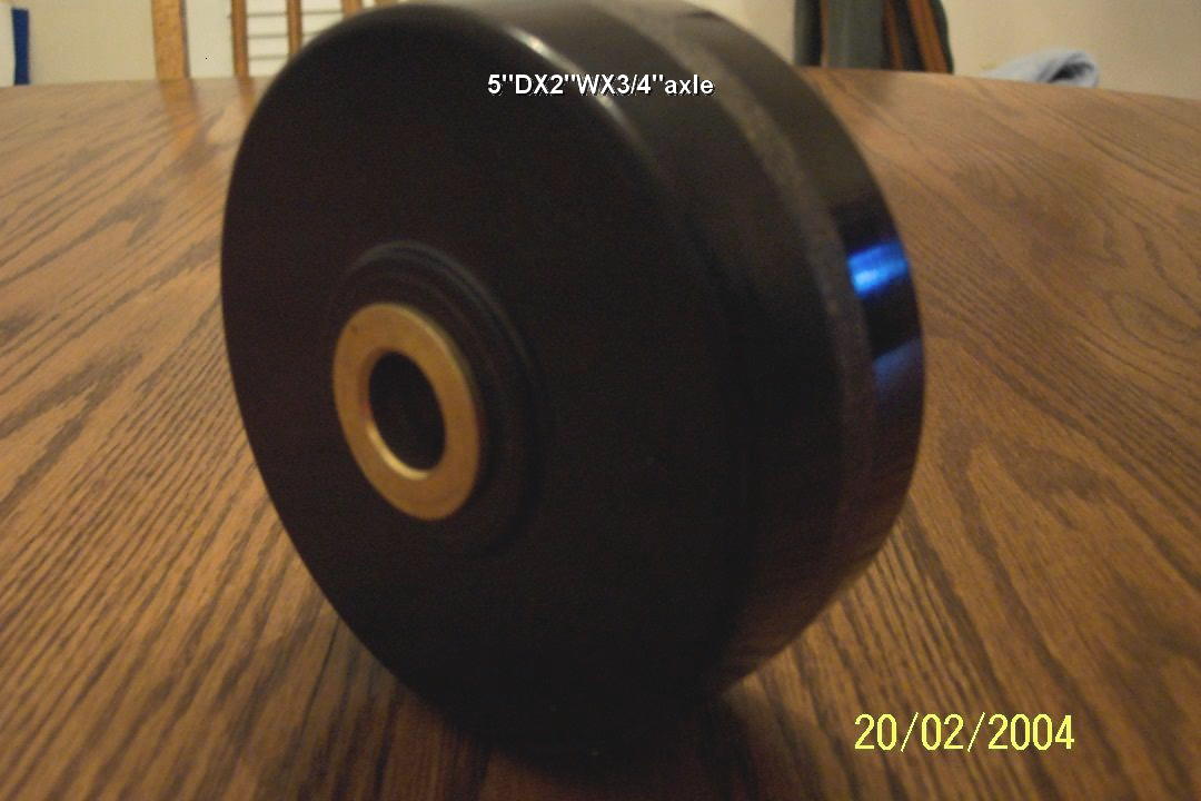

I just got my wheels in from Castercity.com today. Attached is a pic. These are some SERIOUS wheels. 1000 lb load capacity. Resin impregnated with ground up canvas for strength/chip resistance. 5"dia X 2" width X 3/4" axle. $15 each, including shipping. The bore thru the wheel is 1", but the brass 'hat' bushings bring the ID down to 3/4". NOTE: If the bushings had brought the ID down to 5/8", then the OEM axles would be the PERFECT fit...OEM axle has just enough length to allow for a couple of washers.
I'm leaving to fly down to Fl. to spend a week with Mickey Mouse early in the morning. So, I won't be able to do anything until the week of 3/1. I'm going to try to find a suitable axle on the web before bedtime tonight and get it ordered so I will have it when I get back.
These wheels are the real deal....I'm very impressed. The owner of the company included a personal note in the shipping box asking for me to call him and let him know how things are going. He sold me the wheels at a loss just because he got interested in this application.
Happy Mardi Gras!
Be back week of 3/1.
roger

The flanged bushings on the wheel pic on previous post are 1"od by 3/4" axle.
Well, I decided not to go with the 3/4" axle. Will go with the 5/8" OEM axle. Can't find a 3/4" axle that steps down to the OEM 3/8" threads. If I bore out the OEM threaded hole to 3/4", then I'm not left with much metal for strength.
So, just ordered 1"OD by 5/8" ID bronze sleeve bushings and a variety of thrust bushings (i.e. washers). Should be here by the time I get back from Disney. If this all fits, then the total cost for 4 wheels should be in the $90 ballpark. Should be a LONG time before I wear these brutes out.

Re: Anti-Scalp Roller Mod\'s?
RET the OEM axle bolt is not SAE, it is metric 16mm body with 10mm thread. 16mm is .6299 dia in inch. 5/8 is .625 dia in inch. I had to buy a special size reamer to ream the bronze bushings in my wheels so we could use the OEM axle bolt.
10mm dia. is .393 so a 3/8 (.375) thread will work, may be hard to keep tight. Good luck

Moweraxle:
Why buy a sized reamer when you could get an adjustable one?? Better yet, just chuck the wheel and bore the bushing. That is, if you have a lathe with that much capacity. /forums/images/graemlins/confused.gif
