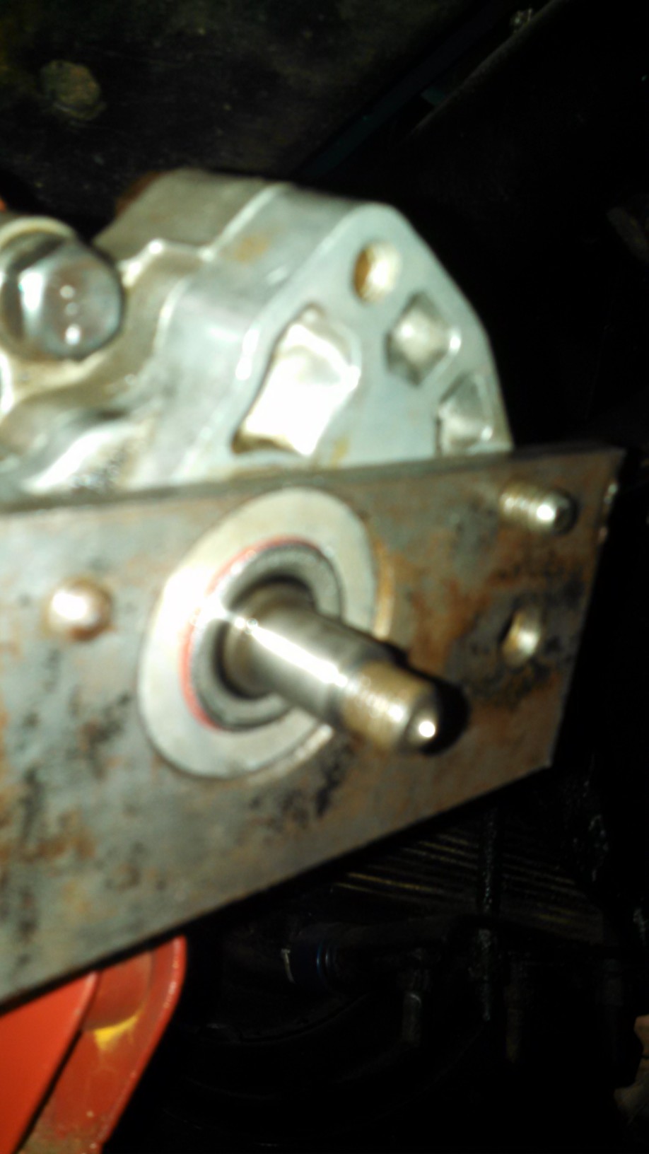

Removed the coupler from the pump shaft and the seal was blow completely out of the pump! The first time I thought I hadn't seated it properly so was careful with this seal, but this time the seal could be pushed around with my fingers.
Hard to tell from the picture, but the red is edge of the seal. I'm assuming the excess pressure just pushed the seal out. Going to have to figure out how to put in a different control valve (after the weekend show).
