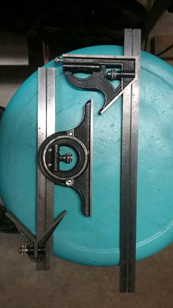

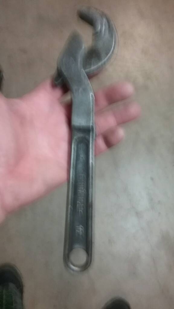

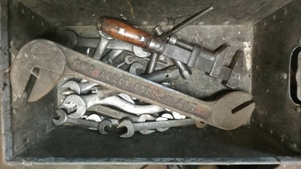

I have lots of Grandads tools, some I'm not sure what they are and how used. Several torches, did they use kerosene? I have lots more...these are a few. I know the open end wrenches but why the large one with small slots? We used it to bend metal. One threaded, grease fitting one end? Punches different symbols, one a ********. Brass stencils lock together.

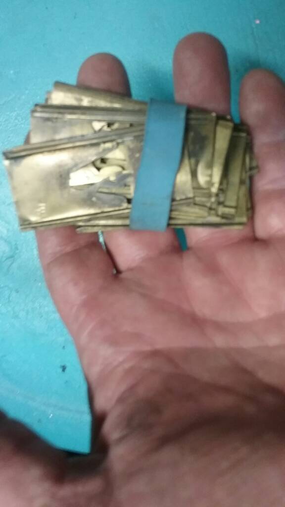

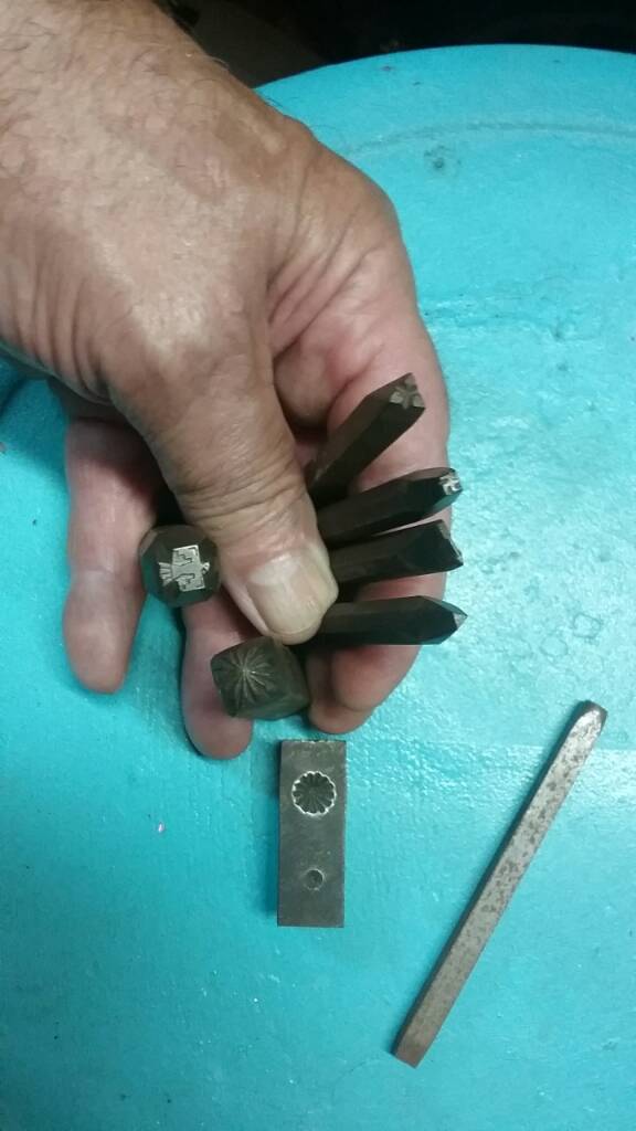

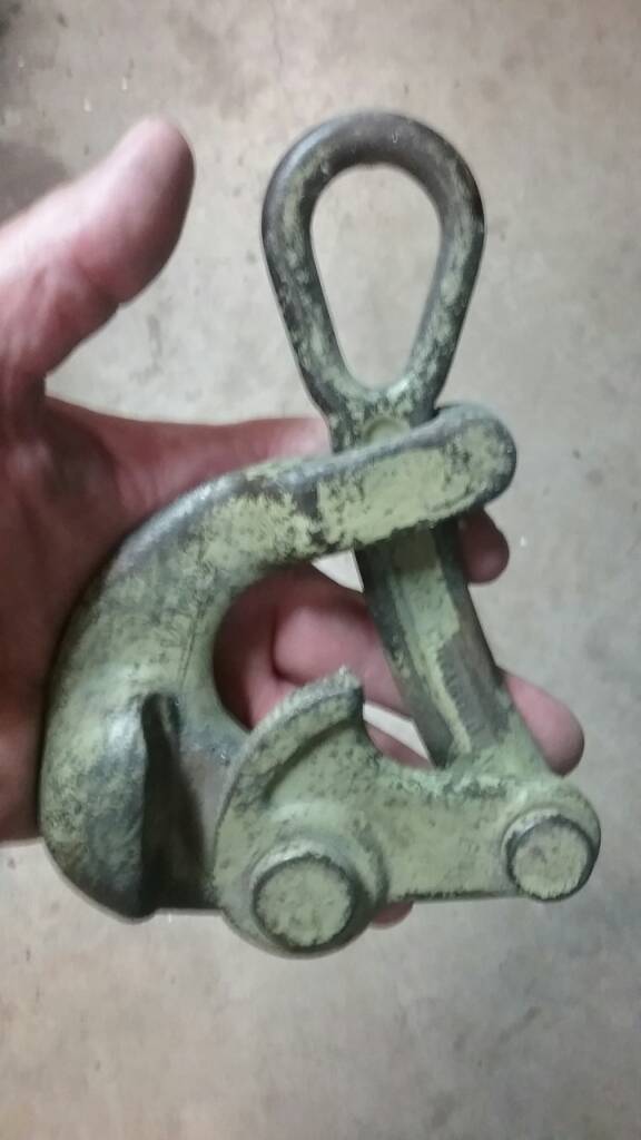

Stencils slide together to form a word template to trace or paint. Second last one is to pull cable or wire (we used one to stretch fence). I would image the punches are for proof marks. The combination squares are common and still made today.

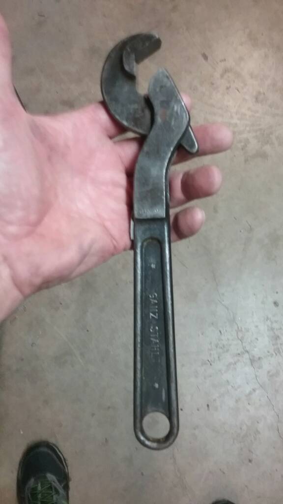

1 not sure what a fixed wrench with that size opening would be used for. Probably specific for working on some machine.
I have 2 of the adjustable flat wrenches with the wood handle. Mine were made by Coes Wrench Co. in Worcester, Mass.

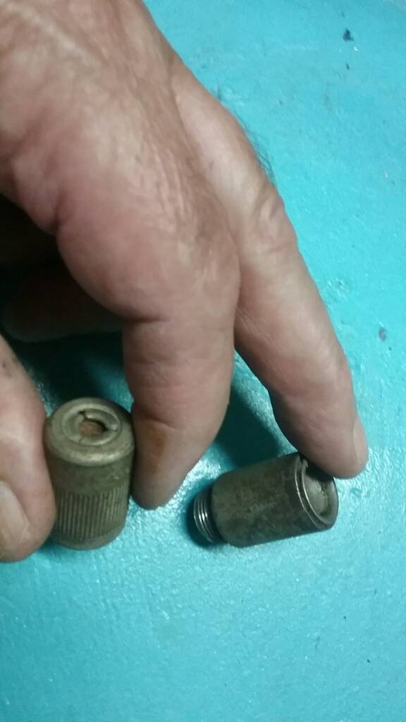

2 looks like tips for a grease gun.
4 are squares, one has adjustable angle.

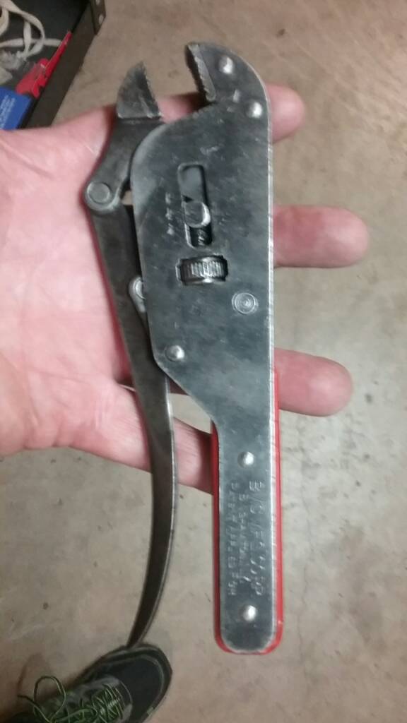

6 is an older version of today's vise grip pliers.
7 is a spring loaded adjustable wrench.

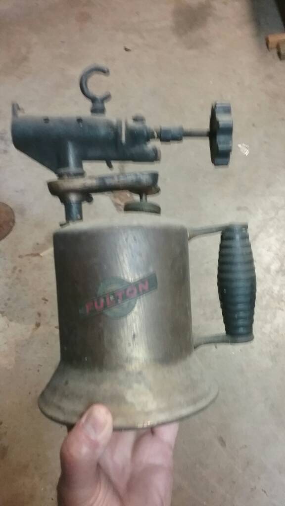

8 is what was used as a torch.
9 is a cable or wire puller.

I'd agree about the stencils and punches are for proof marks.
As a machinist he probably made some of his own tools as my father did. He probably made the proof mark punches as his identifying mark to stamp his tools.

Thanks. What was used in torch, fuel oil or kerosene. I think only Moe Howard used gasoline.

#7 and #10 are "Adjustamatic Ratchet Wrenches". Lots of torque with the ratcheting action for faster tightening/loosening.

The "blow torch" which when I bought it at a garage sale had a non working pump but the accelerator pump from a Rochestor two barrel carb provided the seal...just had to do a little machining to make it fit. Huge amount of cheap heat from one of those but they need a bit of warm up time first.

I've a couple of the spring loaded jaw speed wrenches. I bought the first one new back in the 70's, a 10" one, and used it at work on a power line crew, very handy!
The square on the left is a machinists square with a center finder so you can mark the center of a shaft. Looks like yours is missing a locking bolt on the protractor part.You can rotate it to have the ruler at an angle through the base. Mine is a Starrett brand and the price of it new would shock you. The one on the right is a fixed 90[sup]o[/sup] angle but adjustable leg so handy also. You can still get both new and much cheaper than the Starrett one.

7 and 10 also get used to remove the copper caps from resistance spot welder electrodes

9 looks like a clamp for lifting sheet metal you hooked the eye on to crane and placed the V opening over edge pf plate and then as you lift the cam tightens on plate never trust them! Especially old one's!

9 is a cable, or wire puller.

I'd suspect #1 is a tool to bend or adjust flanged material such as the lid or lip of a metal box, again perhaps the flanges of vehicle fenders.
