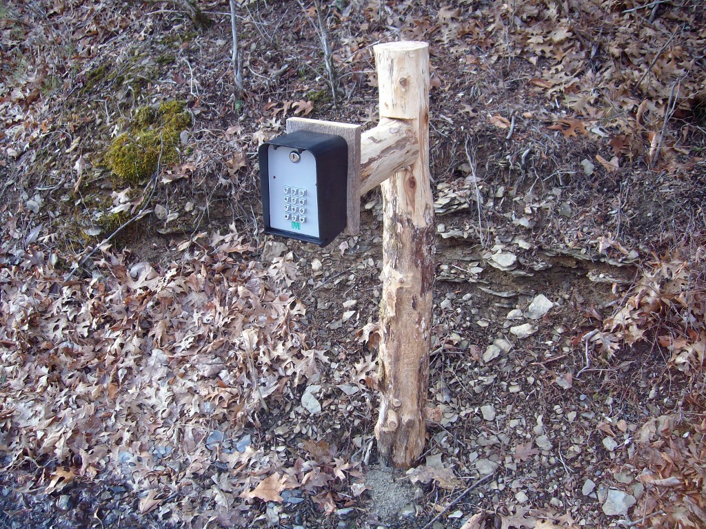

#13
I musta caught mine just in time. The edges of one of the boards are a tiny bit swollen, but after cleaning, everything works. Everything about the keypad EXCEPT the boards is now saturated with Ortho Home Defense and Triazicide. I mounted mine on a nice "rustic" cedar post. Perfect environment for the ants. This may be one place where the standard steel pole is better.
