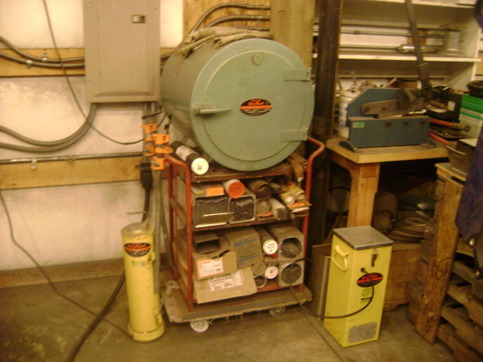

When I seen that ad this morning, I spit my coffee all over the screen of my monitor.:mad:
I paid $25.00 for the one on the right.
