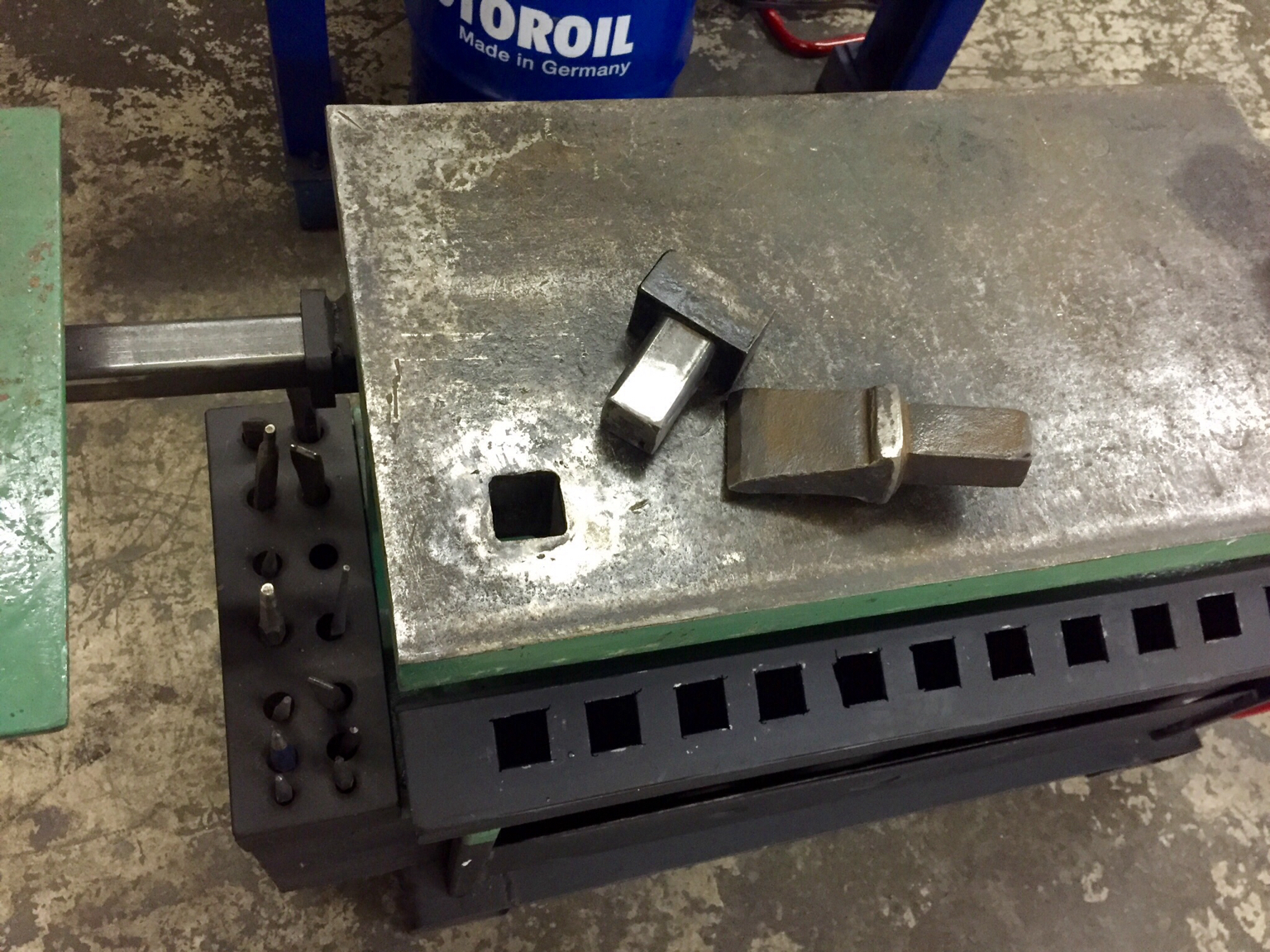

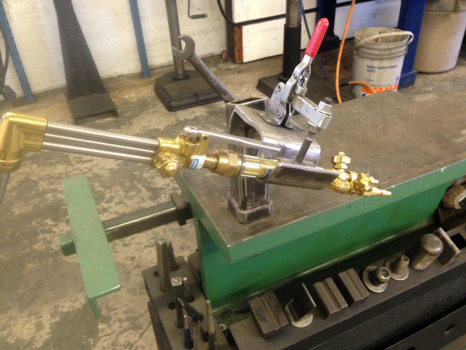

homemade anvil.. Pretty cool. How did you make the hardy (hardie) hole in that ?
I torched out a 1 5/8" square hole so that I could drop and weld in a short length of 1 1/14" square receiver tubing.
I've standardized all my hardies and accessories to having 1 1/4" square shanks.

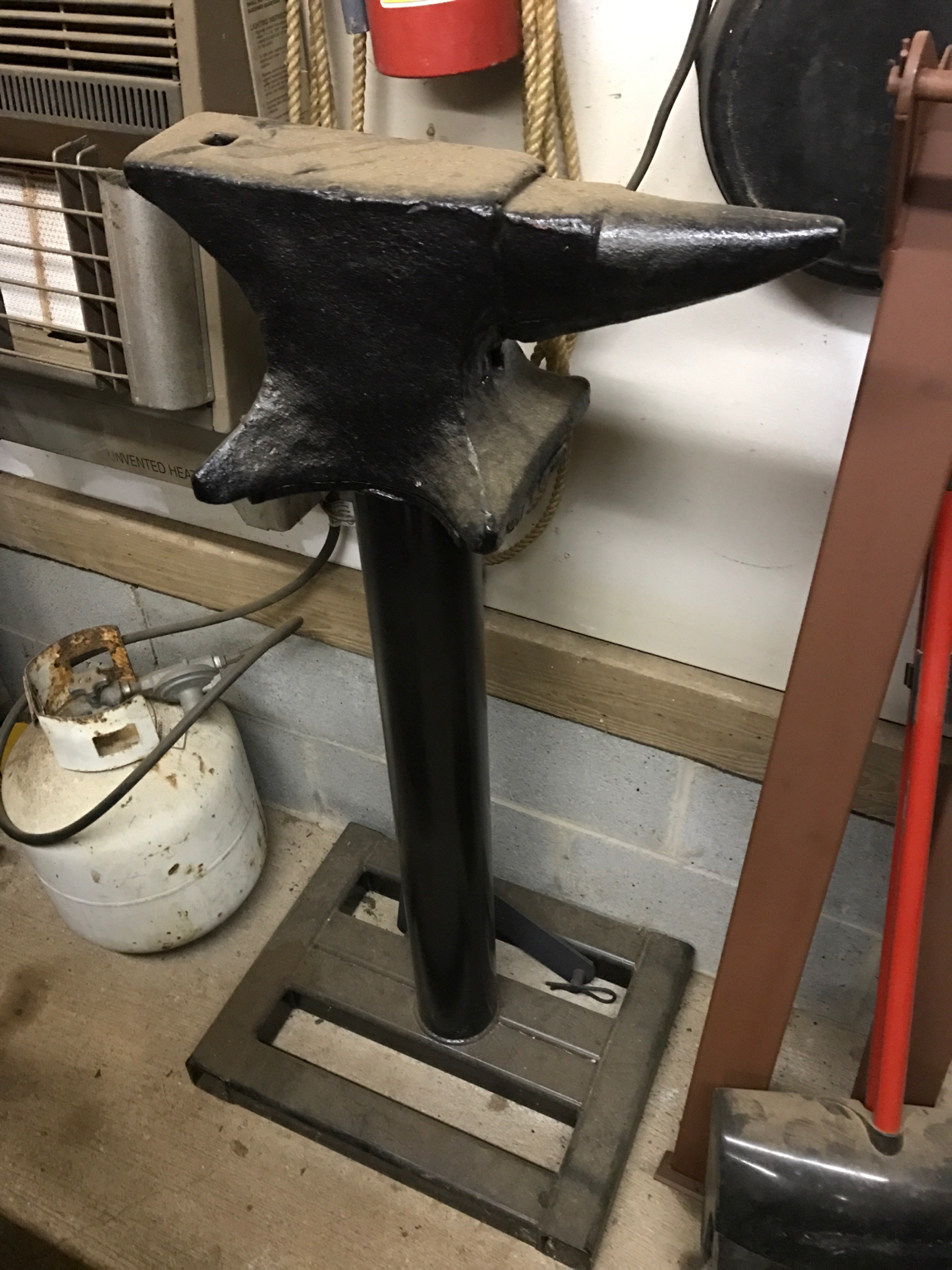

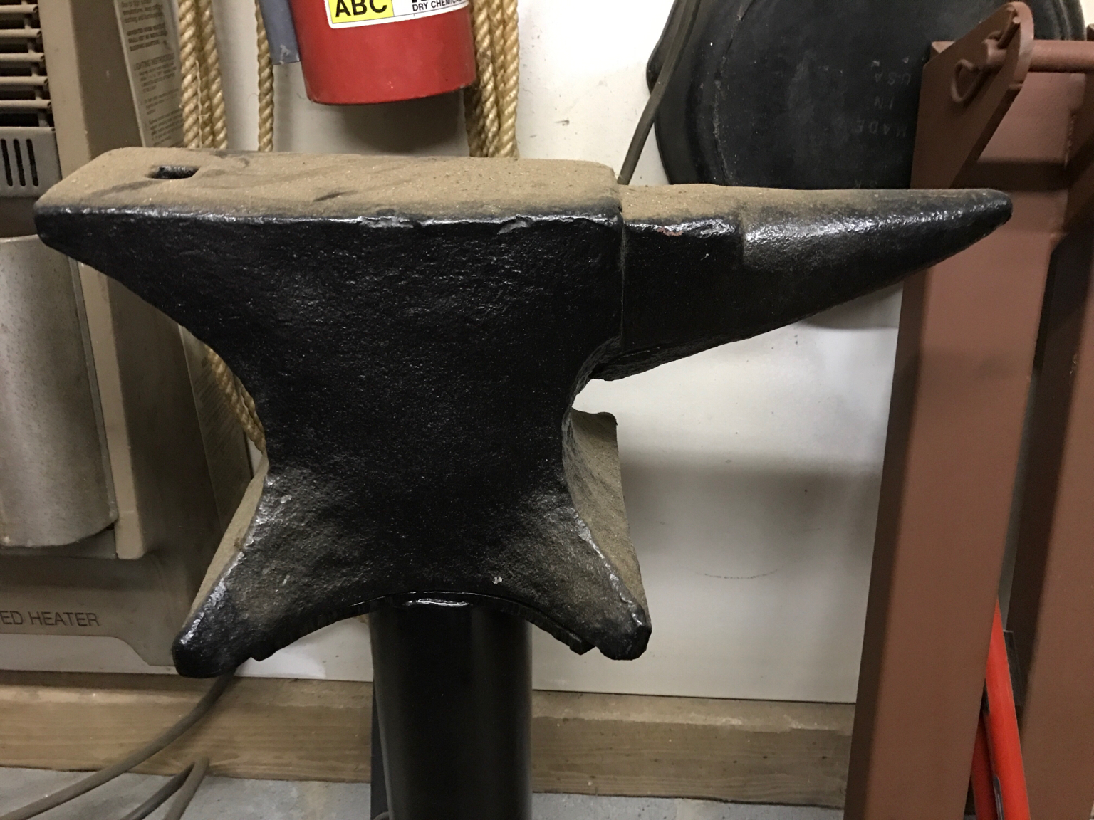

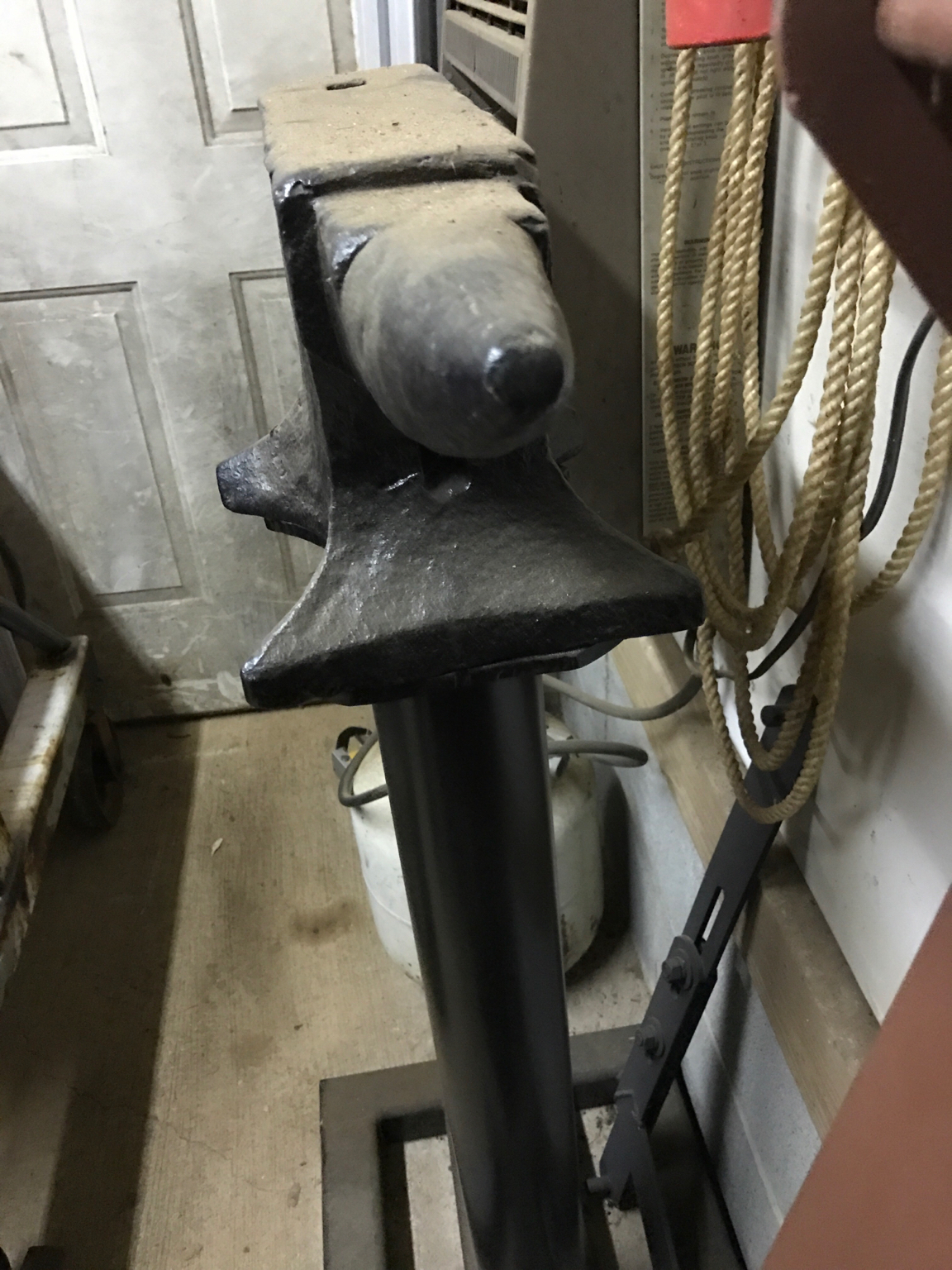

Here's ours. I can't remember the name on it. I cleaned it a couple years ago and rattle canned it black after making the stand for it. The stand has a square peg welded on it the anvil sits on, that's the only thing holding it in place.

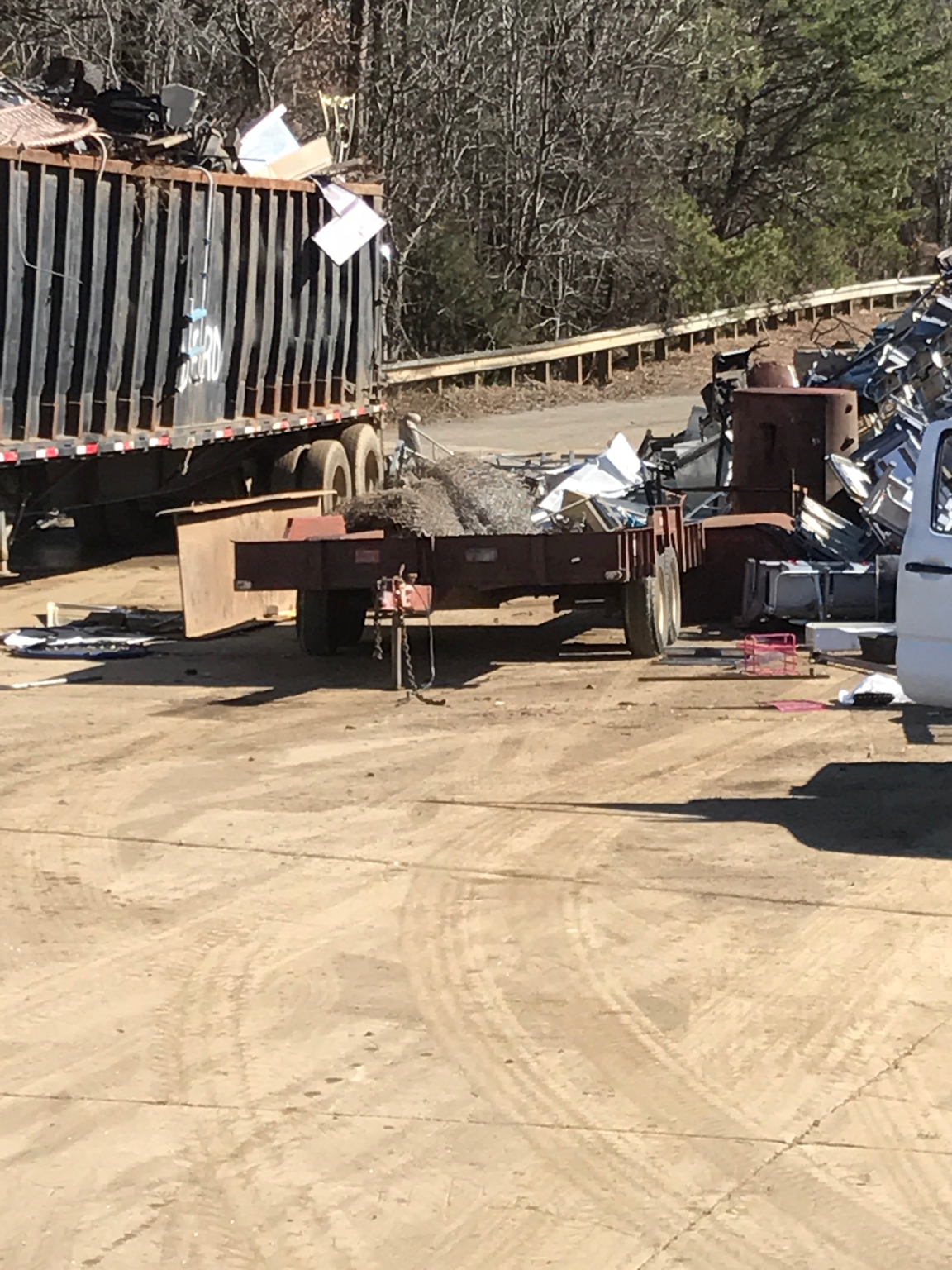

I took some scrap today and they had this Hardee trailer sitting at the scrap pile. I ask if someone brought it for scrap, they said yes. I ask what could I buy it for? They said it has to go through the shredder, we don't sell things otherwise. It was a decent trailer, I sold one just like it years ago for $2,200.00. I felt sick to my stomach thinking about it going through the shredder. They just unhooked it, still had air in the tires, safety chains hanging etc.

Do they require titles for trailers in your state ? May have something to do with it.. Other than that. I have no idea why they couldn't have sold it to you for scrap price
