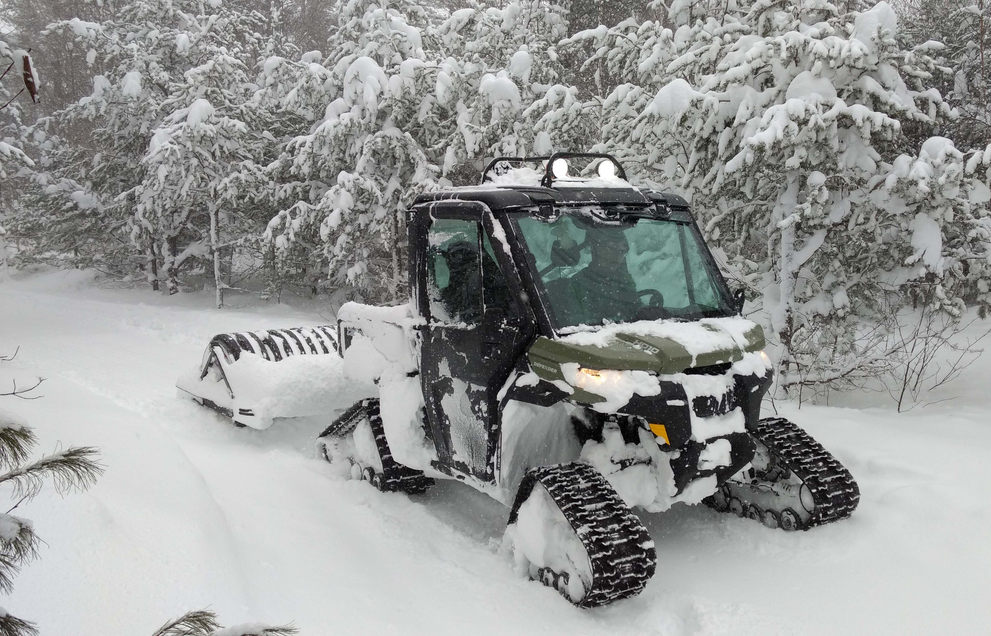

I operated the 1st years production HD10 for three years. Did have some grief with it but seems BRP fixed them. I'll assume you'll not be installing pods on it, so you should do fine with the 8. I did write a review of it here. We think I dealership's service is paramount.
   / Any Can Am Defender HD5 or HD8 owners Reviews wanted
Correct, what ever I get will not have pods/tracks. I am sure they must test the running gear to it's limits.
