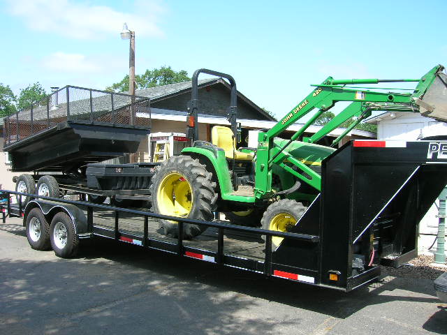

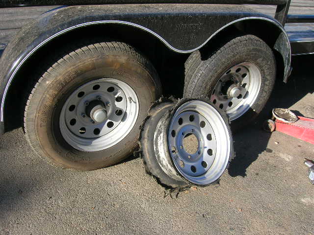

I just towed my JD 4210 with FEL and hydrualic dump trailer on my 24' gooseneck trailer last night. This morning the wife noticed that one of the tire was missing. Sure enough, I must have had a blow out during the 125 mile trip home but didn't even noticed. Goodyear tires are 6 month old. Being that the tire is gone, I guess there's no way of going back for warrantee replacement :( .
Oh Lordy!!! :eek:
I think that whatever that surviving tire was on that blowout side... that made it all the way with no help from its destroyed partner... should be the tire that we BOTH should be using!!! :)
But I am a bit confused. :confused: I see a Taskmaster and a Goodyear. What brand tire blew and what brand tire did double duty without complaining??? Am I correct in understanding that a Goodyear blew... another Goodyear did the double duty... and the Taskmaster replaced the blown tire?
