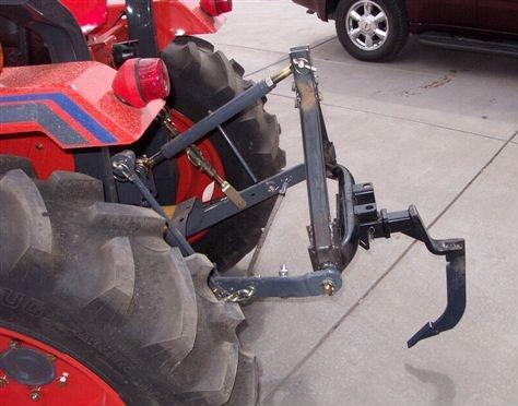

I built my ripper to attach to a 3pt receiver hitch implement I built. I used an old trailer ball receiver and welded a shank on it.
   / Any Deep ripper ideas for 3ph #5
This one is after I beefed up the attachment to handle the load.

Nice setup Tom. Did you make this yourself? I need to make something like this to rip small roots from a stand of sumac trees in my feild so that I can mow it again.

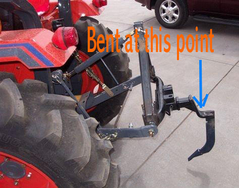

Yes, I made it myself using a trailer hitch from a 2002 GMC Sierra. I was able to easily pull it with my Kioti 3054XS through the dirt and even pulled up some rocks. Unfortunately, I bent the drop down trailer hitch that I welded the shank to at the 90 degree angle when I tried to rip some roots of an old scrub oak bush. /forums/images/graemlins/crazy.gif I need to figure out a way to bend it back and than weld some support in the web.

Neal,
It's hard to tell from your picture but I was wondering if your device would penetrate full depth without extra weight if you changed the point geometry.
While that welded on chisel looks like it would penetrate in the photo's position, as the 3PH rotates down to the full depth position the chisel orientation would become more horizontal and lose its burrowing ability.
John
