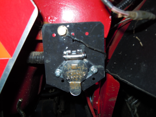

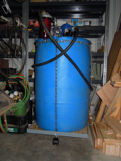

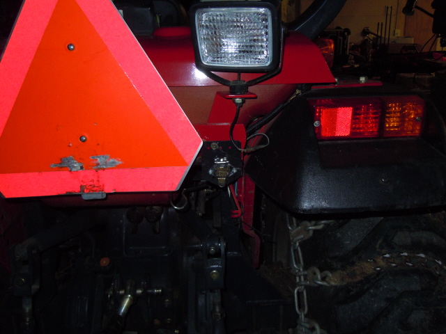

Here is my fuel station. The barrel sits on a platform with casters. I don't have the fuel delivered so the chains are used to lift the barrel on a trailer.
I installed a four prong receptacle on the back of the tractor. One prong has constant 12V on it. One prong has 12V switched from the operator platform (used for a sprayer) and one prong has ground connected to it. When fueling I just plug the fuel pump cable in the receptacle, put pistol in the tank and start the pump. The pistol has automatic shut off.

Is that gas or diesel?
Wedge
