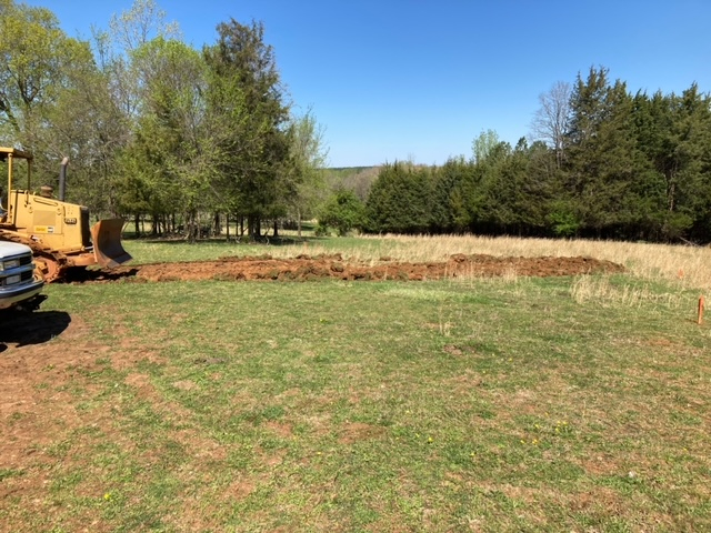

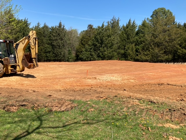

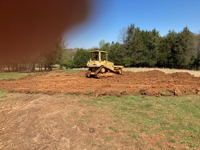

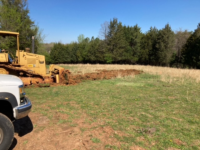

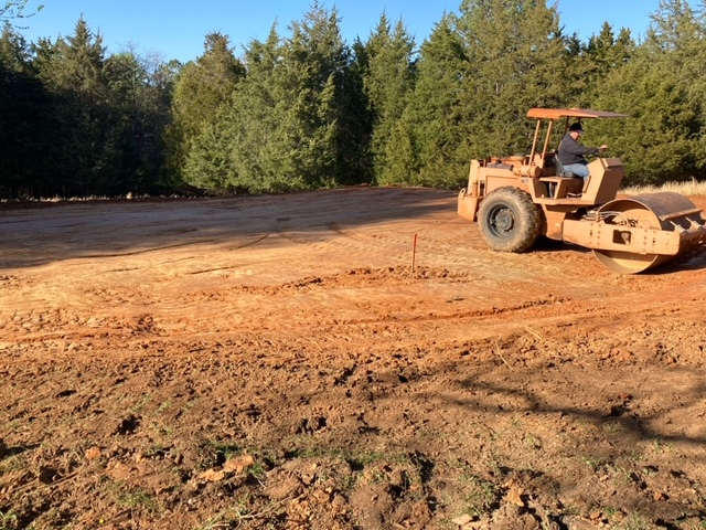

I am in the process of getting a 48' x 36' tractor shed. Had a local company come out and prep the site yesterday. Took off top soil, built up and leveled the clay pad, and rolled it. Tomorrow, he will be topping it with 4" of crusher run and rolling that. Pics of progress so far:
