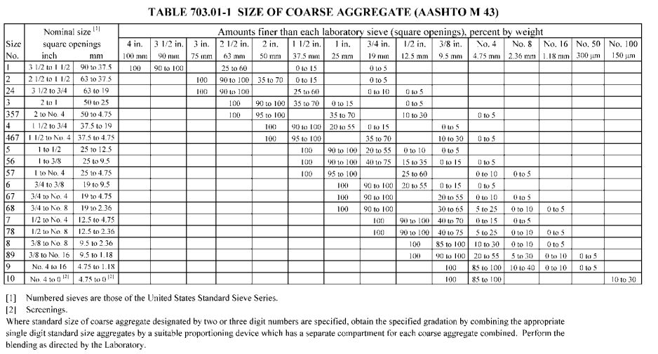

Well this has turned into a wild and free roaming discussion. Here are a couple insights that may or may not have value. As others have noted, a numerical code (#57 aggregate, #8 screw, #6 wire etc.) sheds absolutely no light on the size of the object in question unless you know the code. Regional lingo only adds to the confusion when there's a national discussion (like this one).
Most aggregate codes for road construction have a foundation in AASHTO (American Association of State Highway and Transportation Officials). One of the attached tables is from Ohio but it uses AASHTO coding. Note that this table is for coarse aggregates or base course material and these are "open graded" meaning the small particles do not completely fill the spaces between the larger ones and as such they don't set up all that well. They are not great for directly receiving traffic though a layer of the finer specs on top of coarser ones would likely work OK for a parking area - not so much for a road surface.
Contrast the AASHTO coarse aggregate table with the other one from US Forest Service. These gradations are for the surface course of aggregate (gravel) surfaced roads and this is the layer intended to see traffic. You'll see pretty quickly that the surface course gradations have a lot more fine material ("dense graded") intended to fill the spaces between the larger particles and interlock. Sieve testing is particularly important for aggregate intended for surface courses so you don't end up way long or way short on some of the sizes. When that happens you get a road surface of marbles when short on fines or it ruts when too long on the finest material.
Here's an interesting bit of history since the Romans have shown up in this discussion. The Romans were quite aware of the need for compaction. Our present day "sheepsfoot" roller designs grew from the Romans practice of running bands of sheep back and forth over areas to be compacted.
