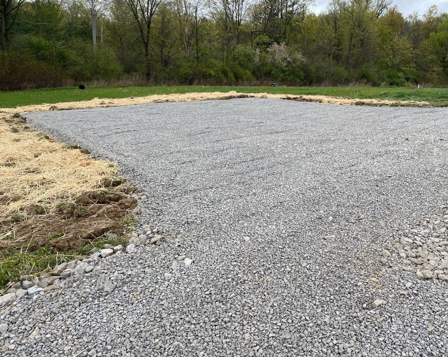

OP here - thanks to all that commented. This thread helped me learn some good information about gravel driveways/road building.
The project was recently completed and here is the result:
Organic material was stripped
Geo fabric was installed
Base of #1 and #2 limestone was created
Layer of #304 limestone was laid out
Compacted
Layer of #57 limestone was laid out
Compacted
Some fine tuning of the landscape needs to be done around the gravel pad. The weather was cold and rainy while the work was being done, so getting the excavated dirt spread out around the pad was a challenge.
Overall, it turned out the way I anticipated and will serve its purpose.
