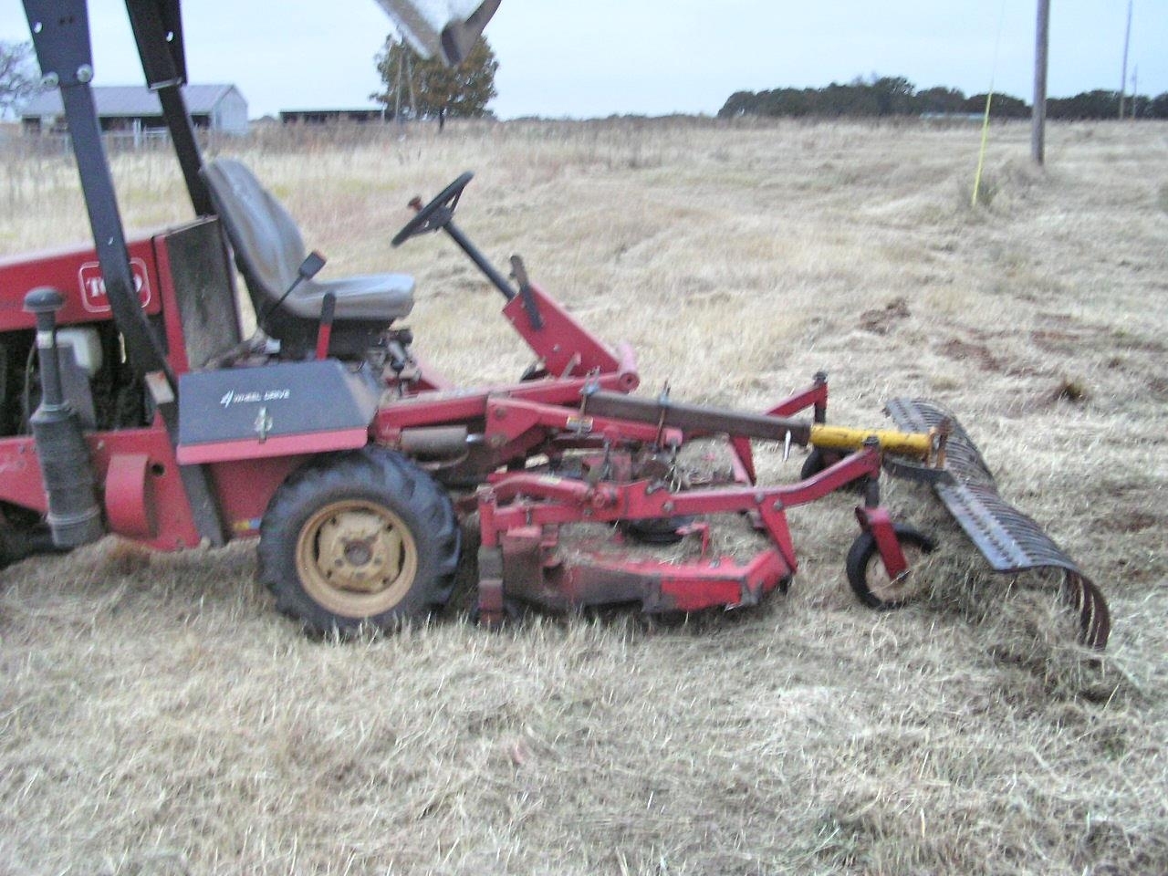

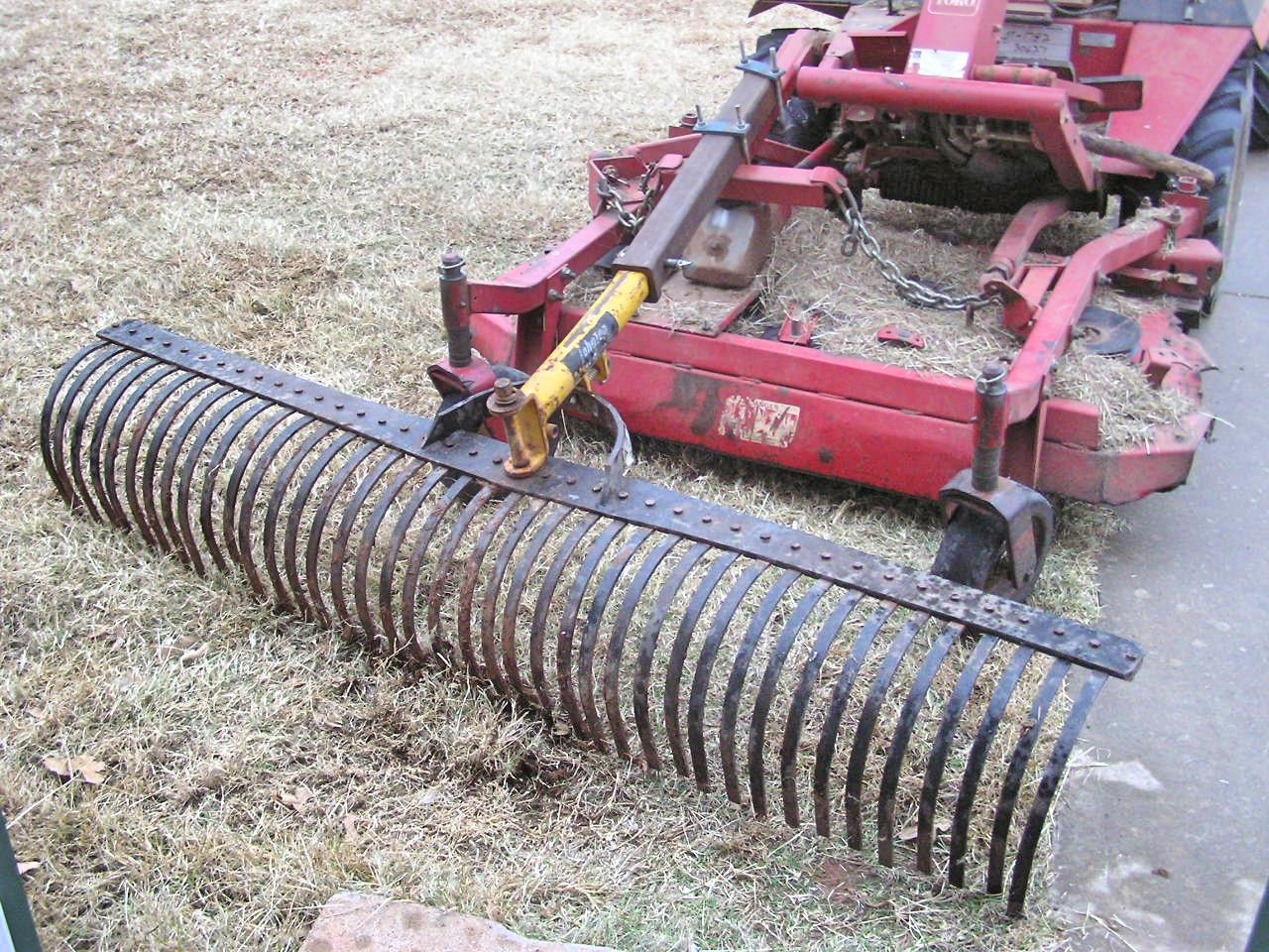

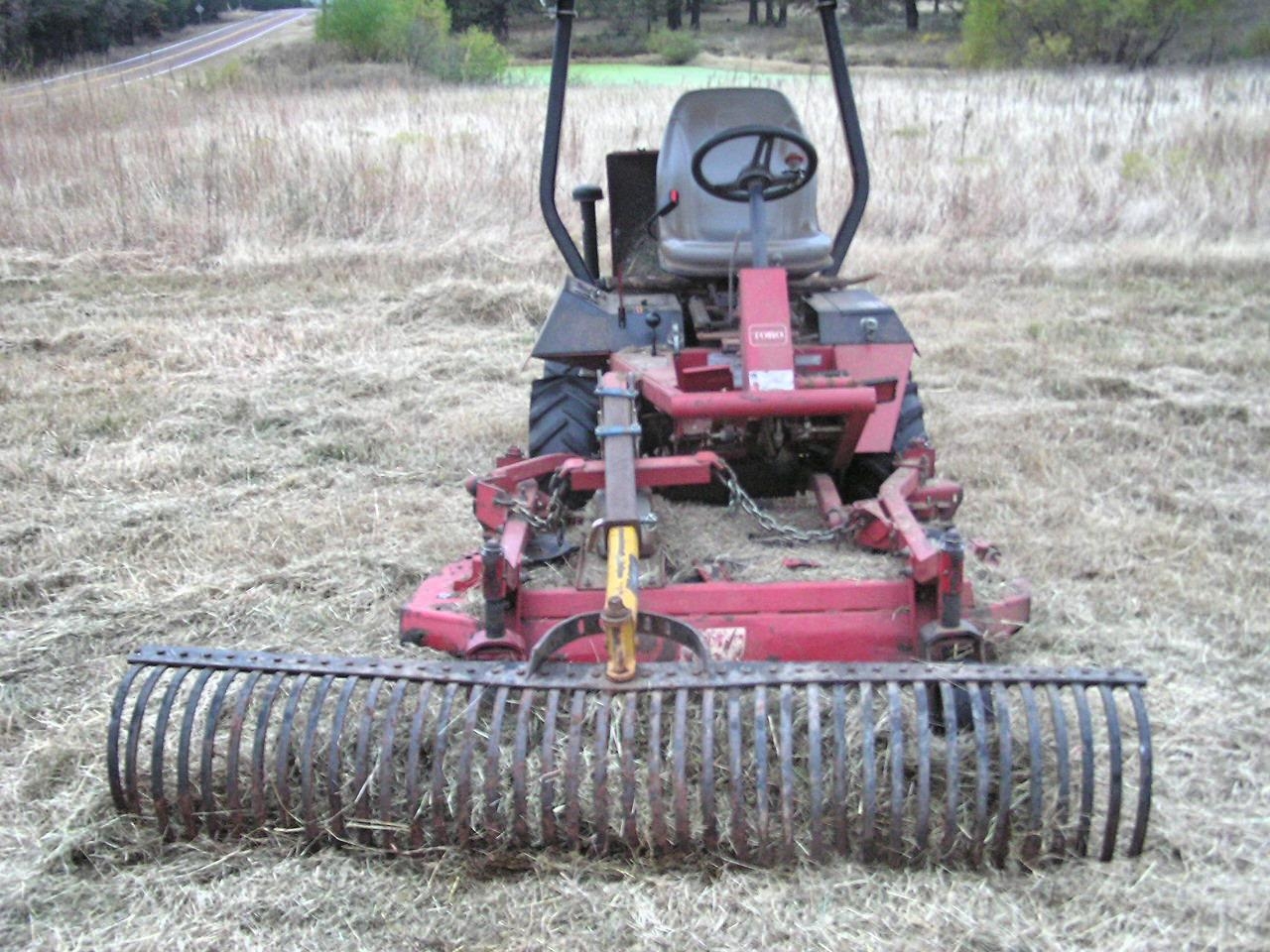

I've got an old 7 foot BH rake. Bought it from the neighbor for $200 20 yrs ago and added a cylinder last year to change the angle. Best modification. This rake is used for surface rock collection.
