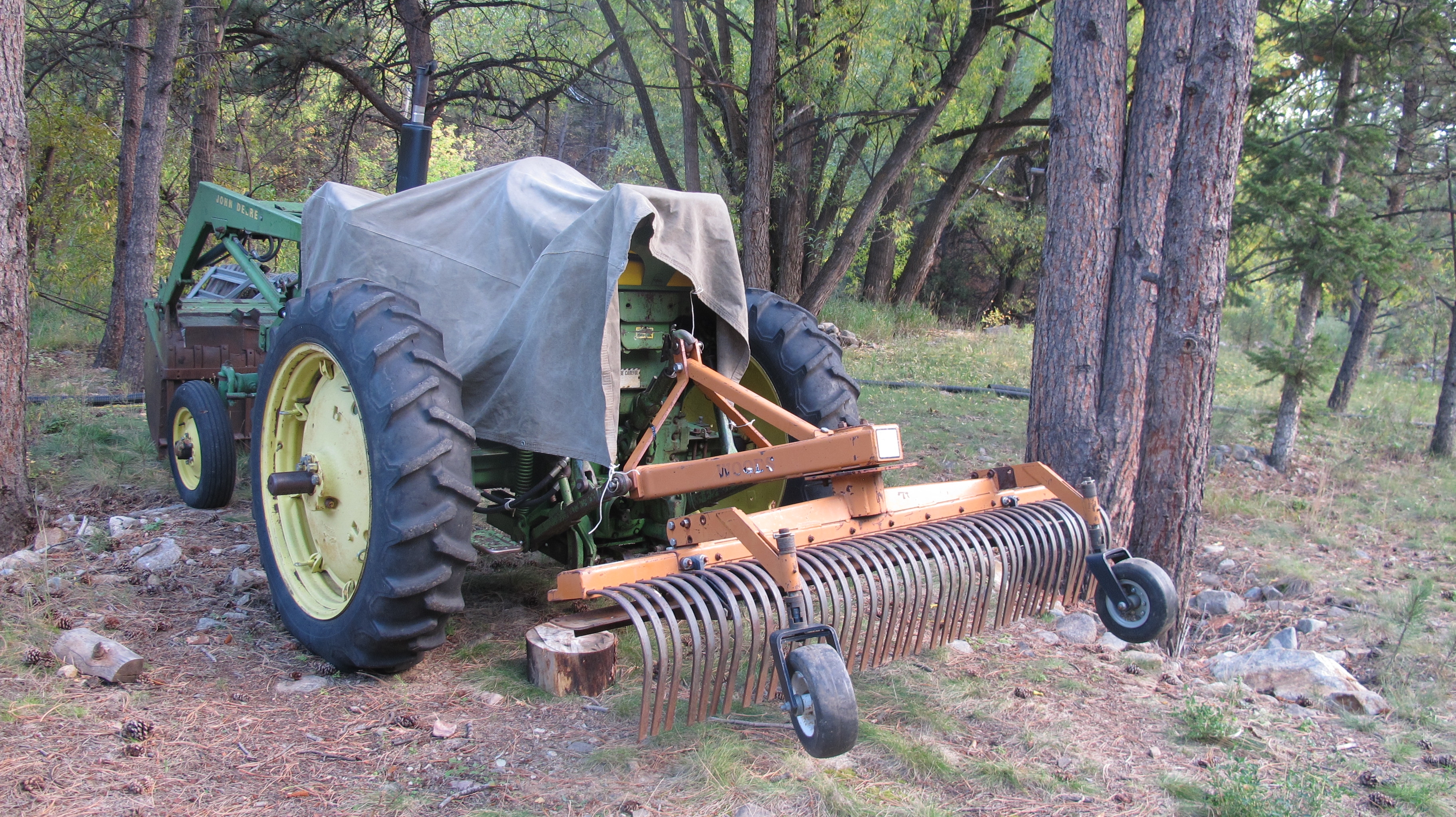

This definitely works. Sht Happens, Sht burns, and Sht now flies. Don't use max rpm on the pto. Makes nice windrows from multiple passes, then a pass with a bucket. I suspect that a traveling grain elevator (with paddles) could make a neat pick-up device going into a trailing gravity wagon after its windrowed....
