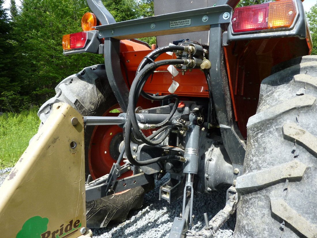

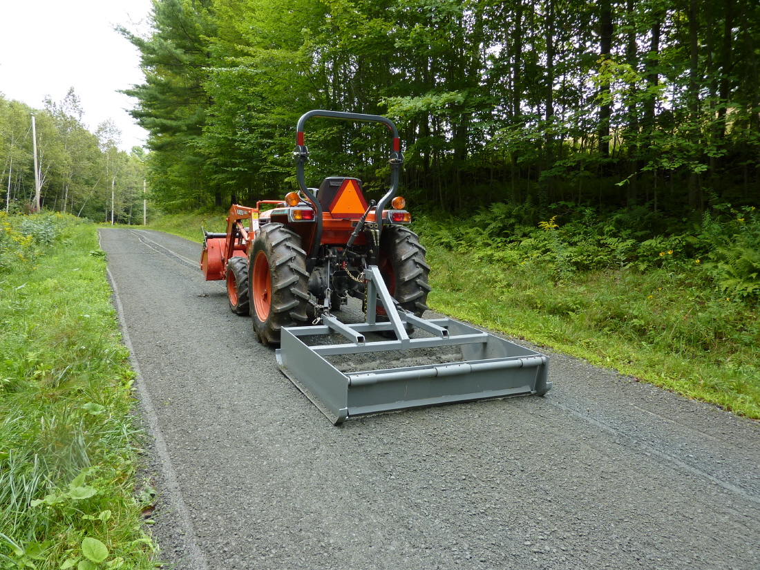

Gordon, do you find that you prefer to grade without your top link, or do you use it both ways depending on conditions? :confused3:
   / Any GradeMaster owners here? #15
Brian, that is an old picture, taken before I got my hydraulic Top and Tilt from FitRite Hydraulics. :)
I used to grade the road with the fixed top link ( you can see it sticking up in the pic ) and once I had the surface all softened and remixed and I was sure there were no snags in the road that would make the scraper kick up on me w/o a TL, I would make one more pass with the chain top link just to even out the little places where I should have adjusted the top link but didn't. I haven't used the chain since I got the hydraulic top link. It is so easy to make TL adjustments as I go now. And I don't have to make that extra set of passes with the chain.

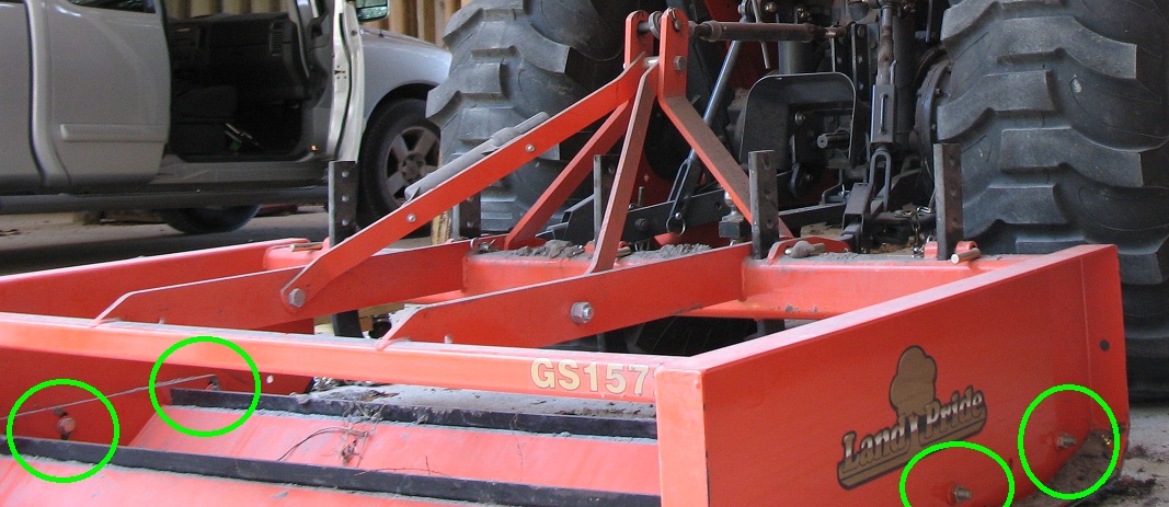

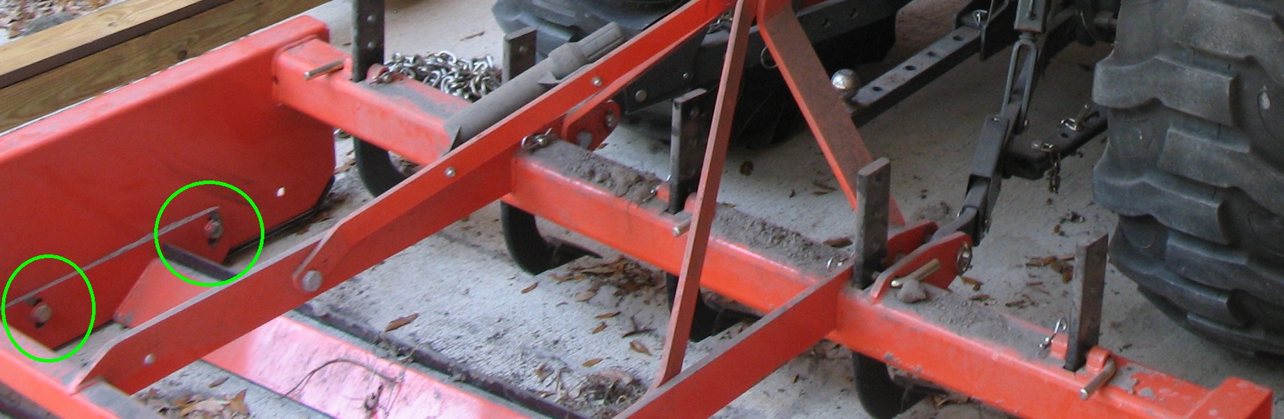

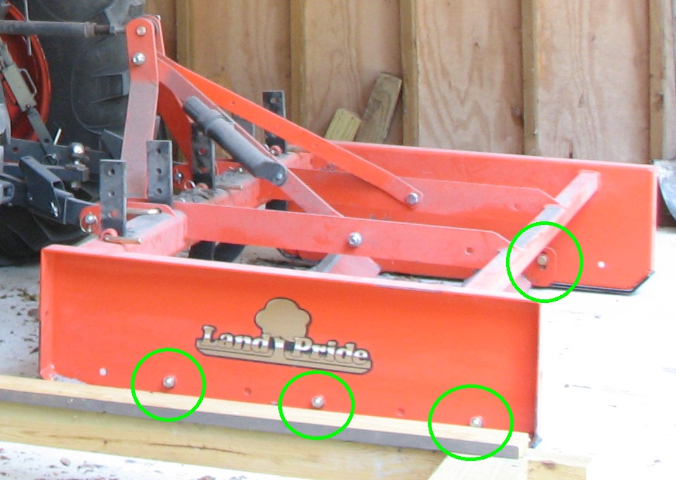

Mine adjust on both sides via 3 bolts (I think) on each side. I don't have any pics I took just to show this, but here are 3 that kinda do:
   / Any GradeMaster owners here? #20
How do you like to set your adjustments up ? Do you change it much or keep it the same way all the time ?
