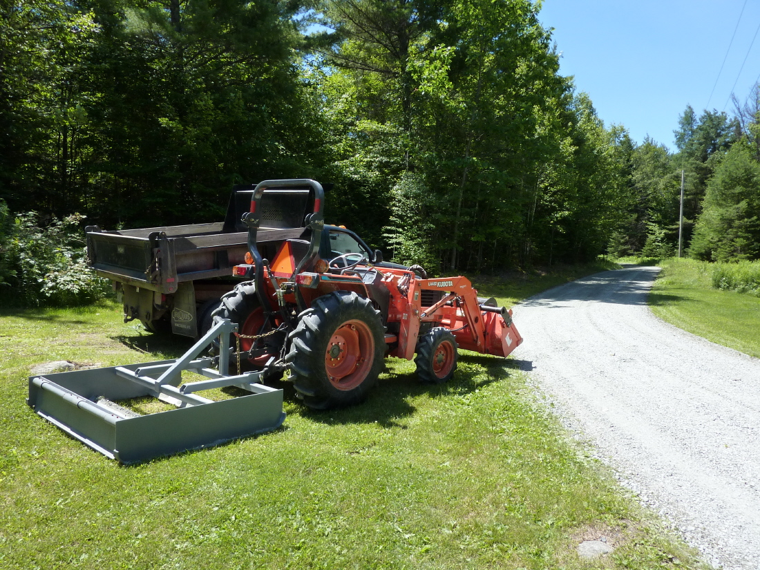

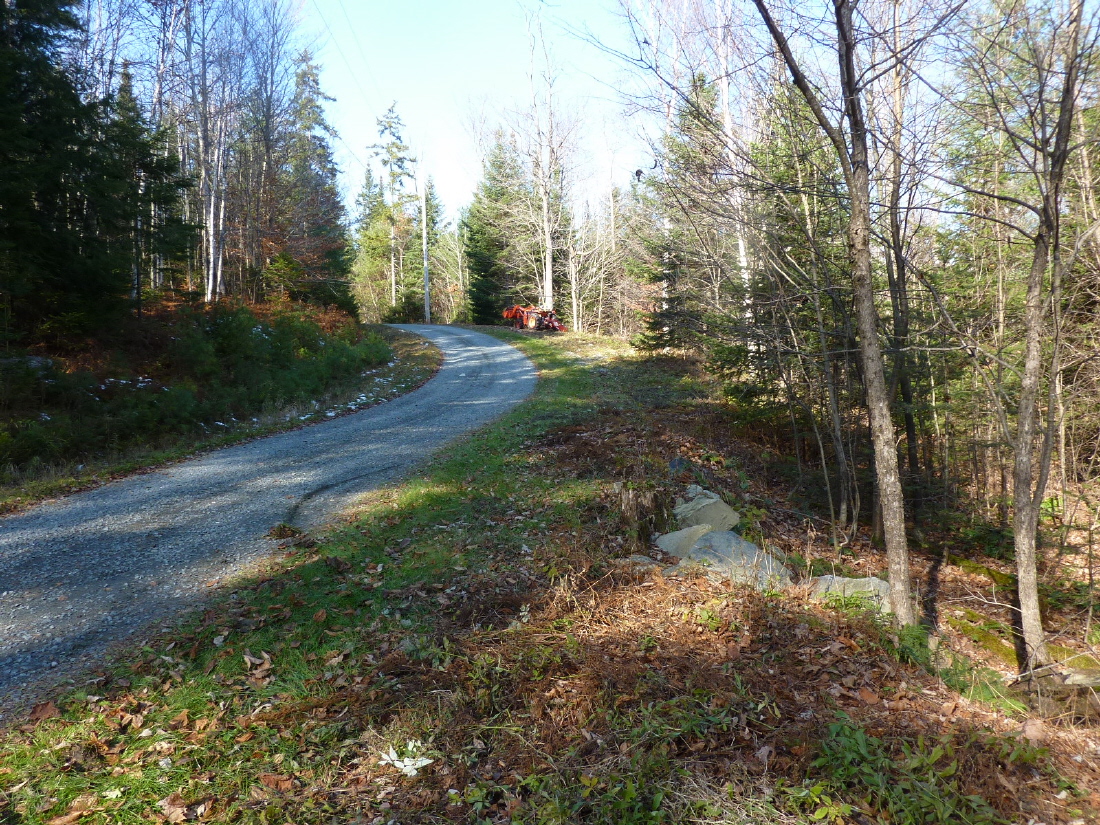

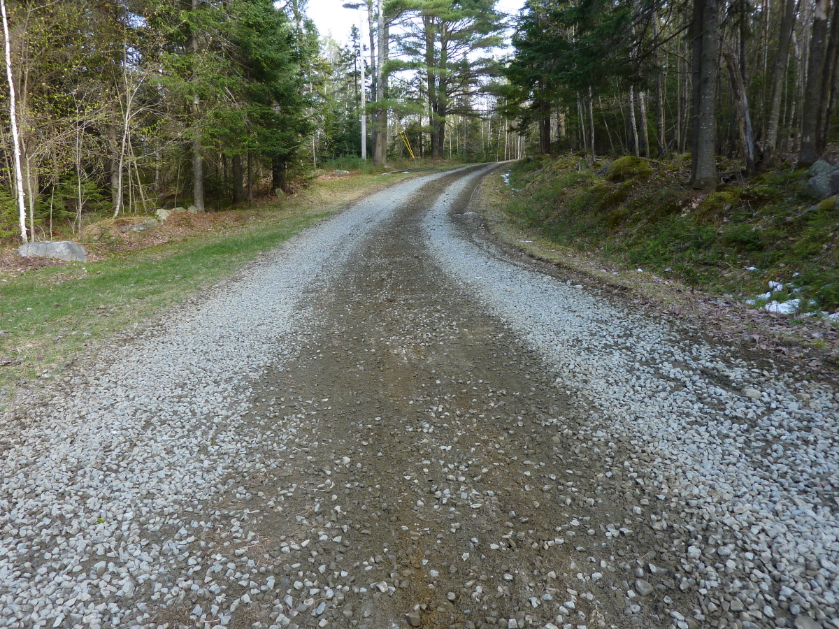

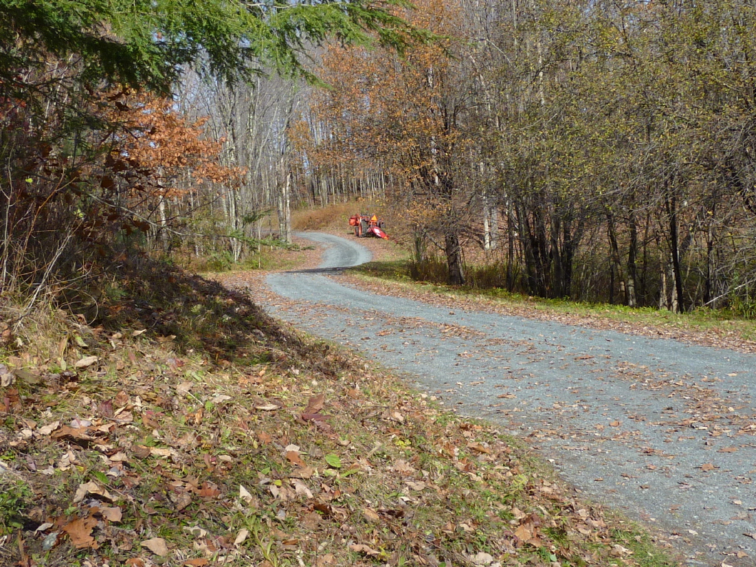

Motor, that is quite a road. I see why you have so much seat time. Looks like you do a pretty good job. But I realize that you have to in order to keep it from washing.
My road is long, a mile, but not as hard drainage wise as yours. My road also varies alot in quality along its length. It was a logging road when I started. Once I got it passable I started improving it section by section. A little each year. The first ten years I only had a rear blade. The scraper grader was a great addition for me. I am sure you will feel the same.
