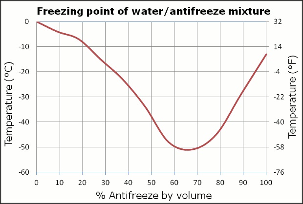

I wonder by how much.
I found this on the internet, but don't know if its: True, ....or for propylene glycol or Ethylene glycol, ....but at 10% mix this says you can get freeze protection down to about 25F which might be fine for many parts of the country.
I would suspect that graph is for Ethylene Glycol.
I did a crude freezer sample test several years ago, and was surprised at how the effectiveness of Propylene Glycol decreased when diluted, by only 25% water.
At 75% water with 25% Propylene Glyco,l there was no freeze protection.
Diluting propylene glycol with water just raises the freezing point. It doesn't work the same as ethylene glycol which requires 30% or more dilution water in order to lower the freeze point. You can also taste the difference. Just tasting it isn't going to kill you. In fact, I'd say that's a good diagnostic tool.
