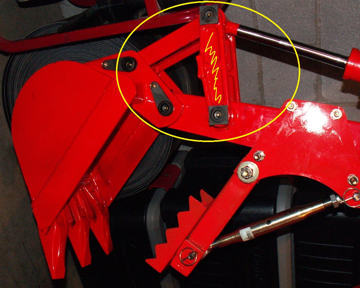

Yup, that would be the LA240 series. What I notice about it is the distance between the lower and upper mounts is only 4". That certainly doesn't give you a lot of curl advantage but on the other hand you have a rather stout 3" curl cylinder which may make up for the lack of mechanical advantage.

The 3" cylinder does have a whole bunch of power, but because of the angles most of it is wasted and the mounting plates (in the middle) are oversized to put up with the strain. I stole this image of the BH from another thread. If the design had these same plates (with the yellow lines drawn on it), you could get more power with less stress. The only easy way I see how to do that is to go to two dump cylinders.

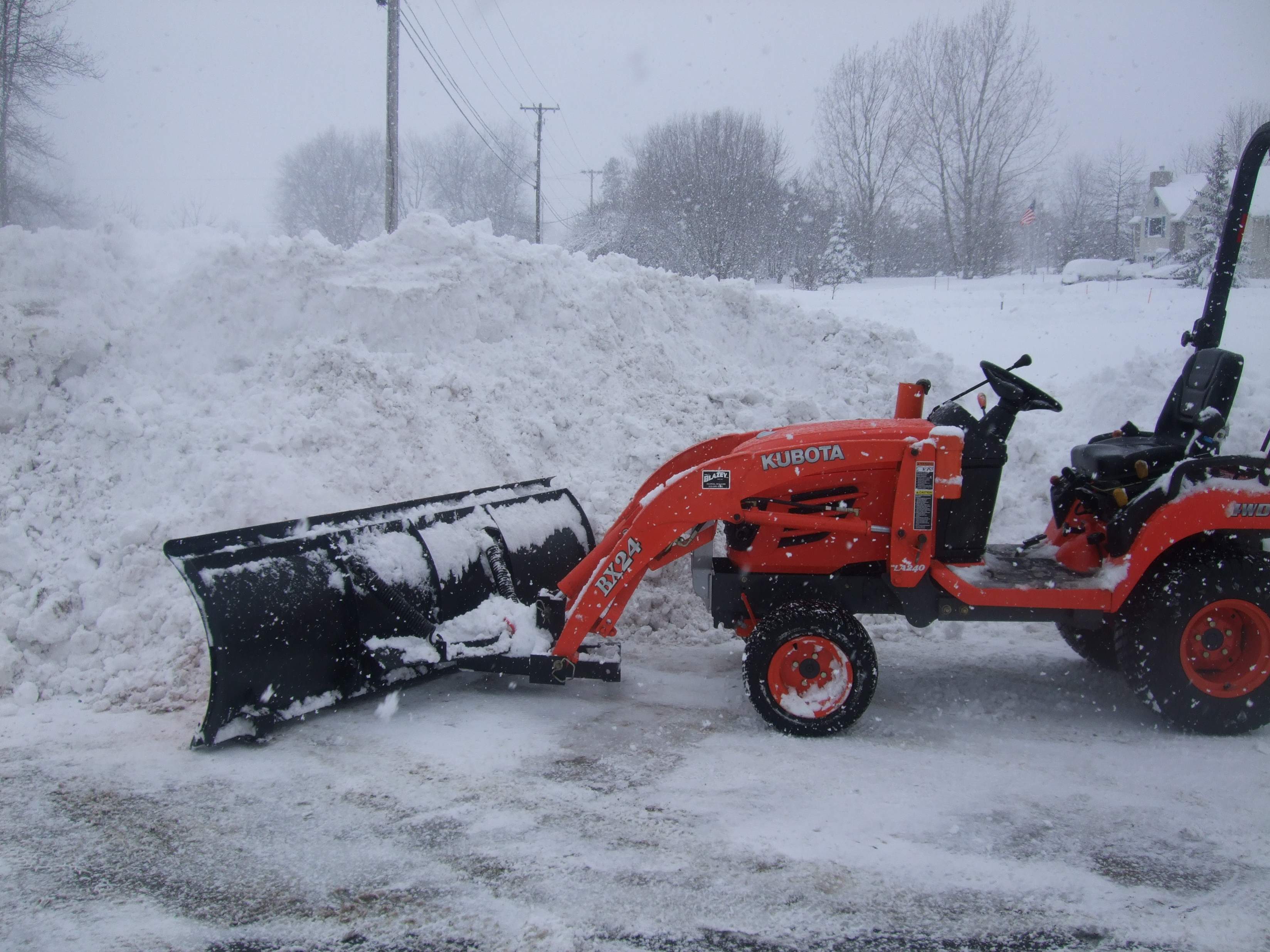

Sorry guys- I gotta side with kenny on this one. I really don't think its that hard to pin and repin attachments. I modified a truck plow to take my FEL arms and can swap between bucket and plow anytime I need to. Its only 10 mins, but I dont really need to swap all the time. I dont use the bolts anymore that locks pins in, but use the locking pins instead just fine.
nice setup -- any more details/pics on what you did there?
