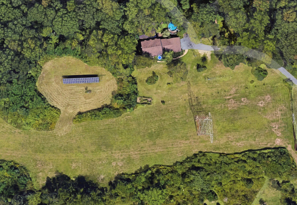

Subtract all the tax credits/subsidies for the mandates...would it still make sense?
It would be 20+ years to break even
paul
Question often asked but only matters if they don't exist. If they do, that needs to be factored into the decision.
For example, many people are in the home rental business just because they aren't taxed 15.3% for Social Security tax on 'unearned' income. Credits/subsidies/tax differences exist, so it must factor into business decisions.
My utility offered a 10 year buy back of 10 cents OVER retail for solar power to encourage small installations (cap on size). They have scaled it back now, so new installs only get a fraction of that. My 50 panel system produces about all our power needs + about $1,000/yr income due to that initial contract. The next 10 years, there is no incentive pay, just a credit of excess production against use.
