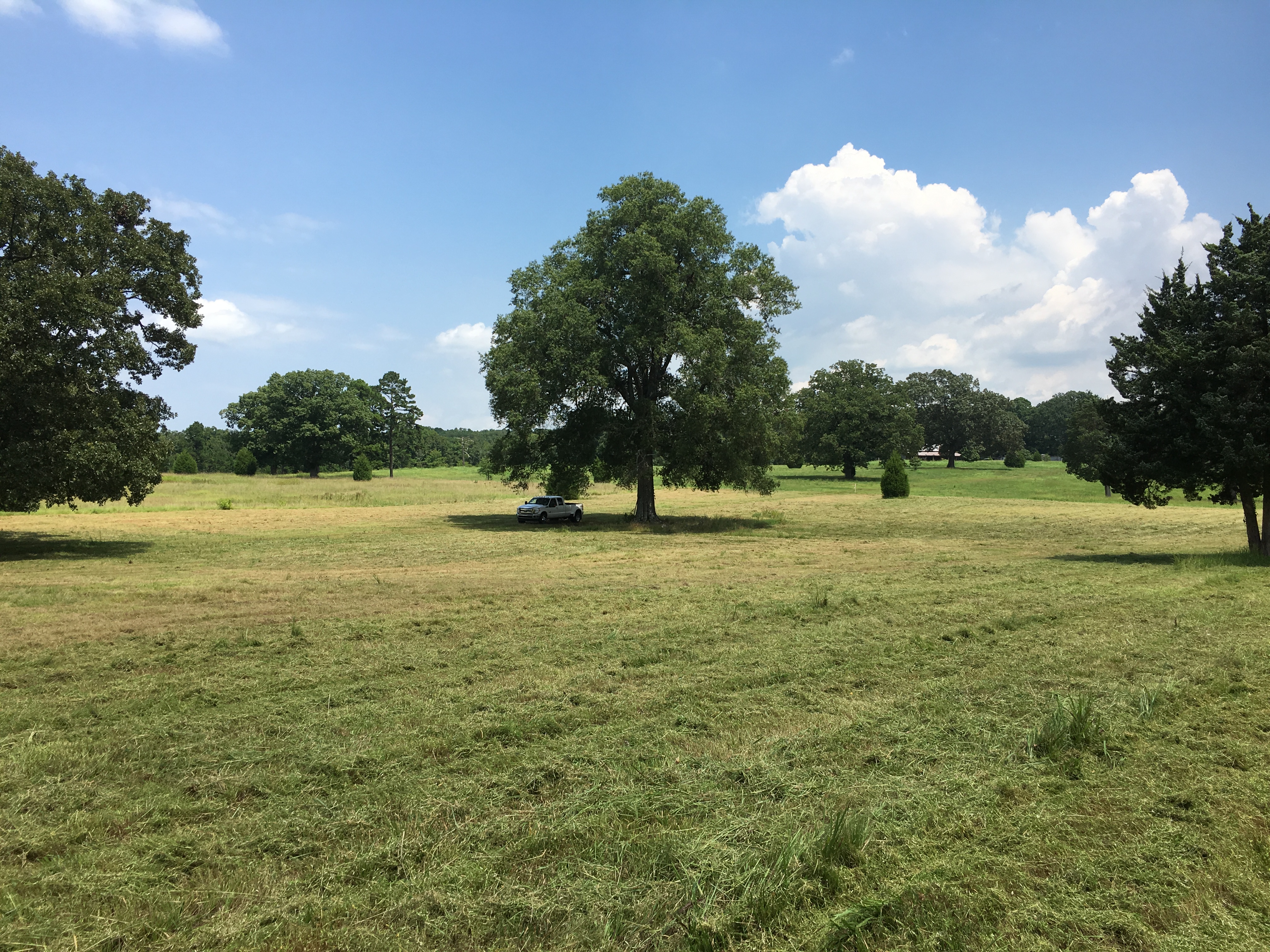

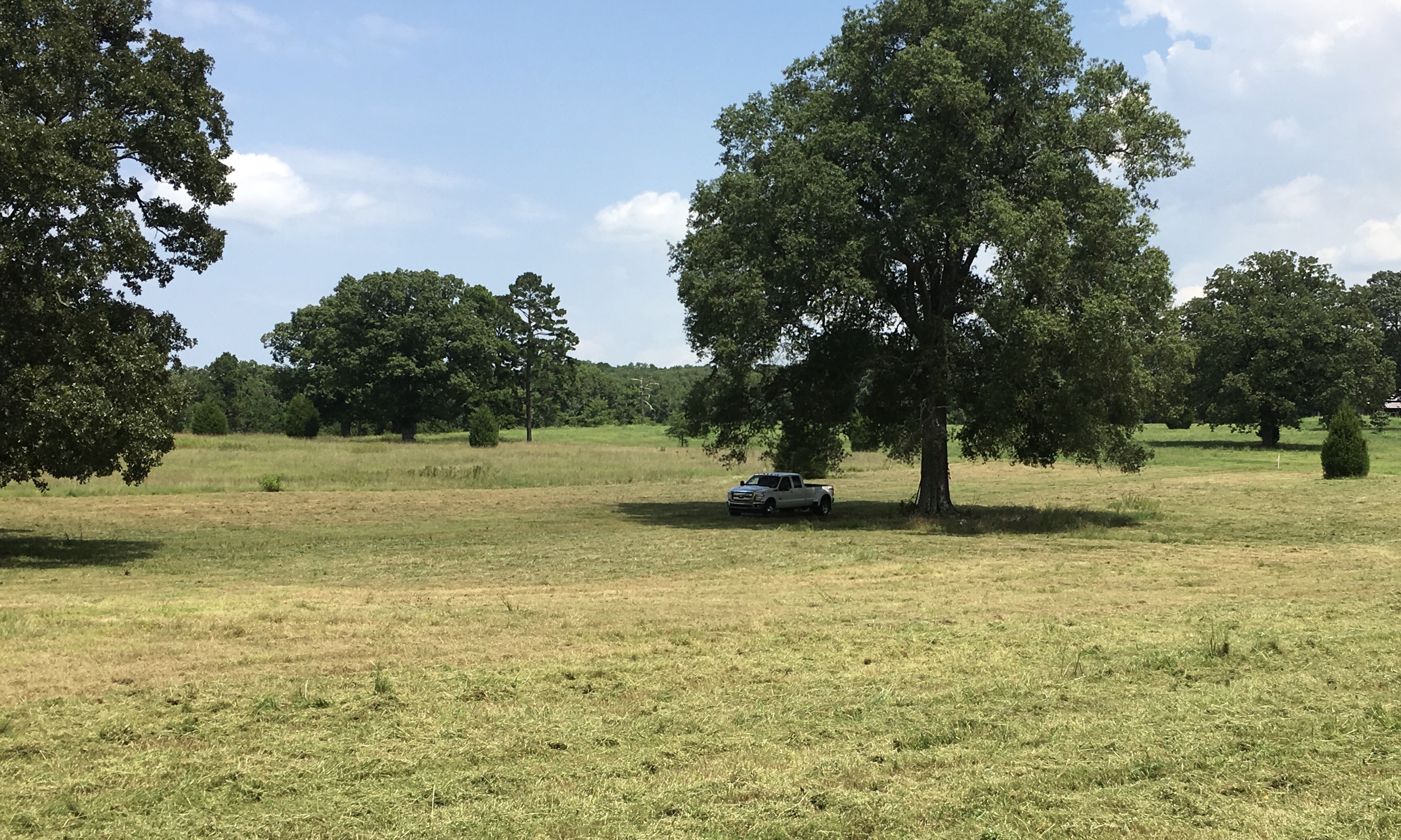

I couldn't resist, here's a shot of the property, the pin oak is so big it dwarfs my truck!!

That photo, and your property, are absolutely gorgeous! How bout some more with the M62 in them! :D

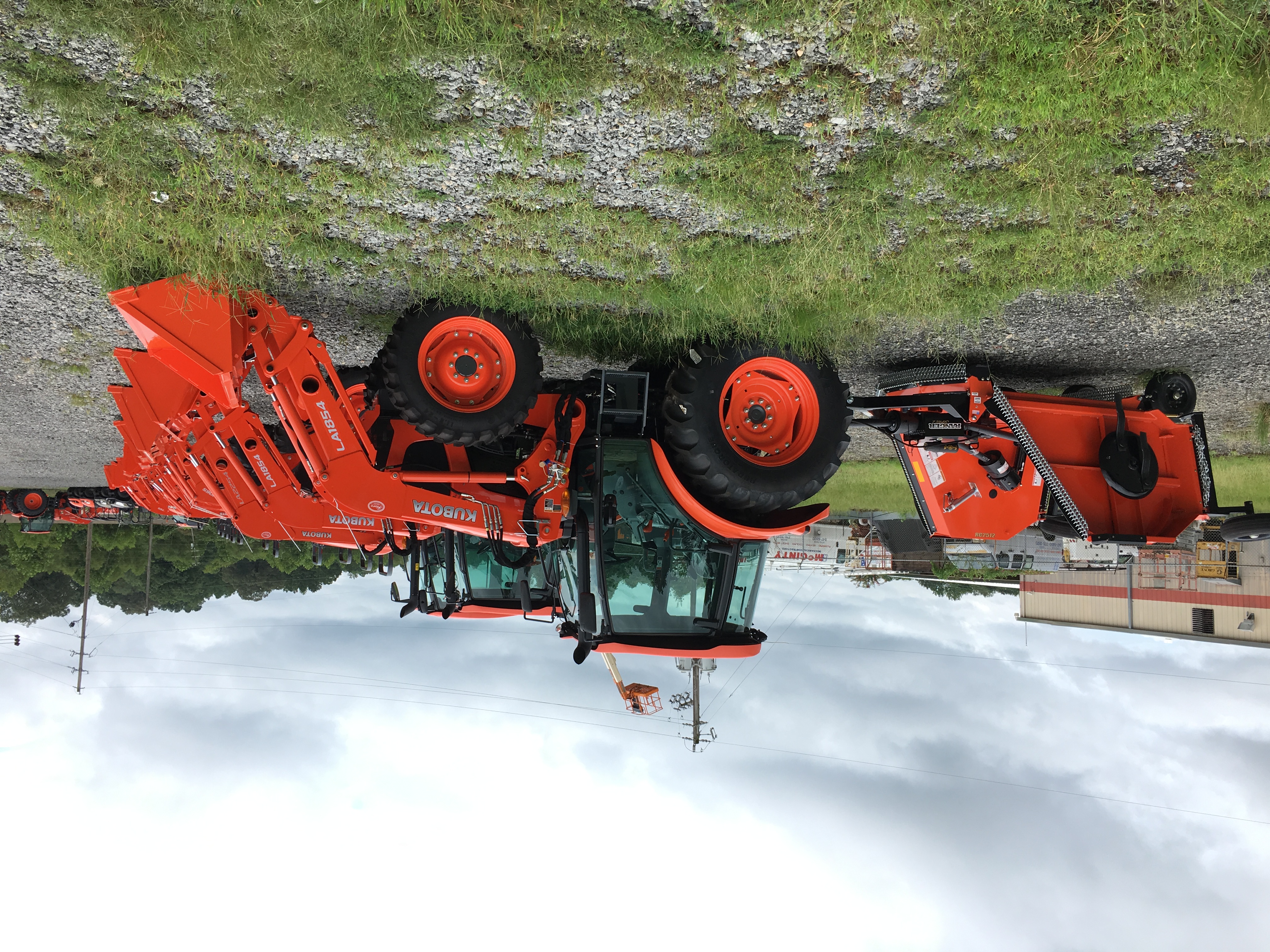

here you go...
this is the new M series M5-111, nice tractor, but it's the 12' winged bushhog that's got my interest. :)
