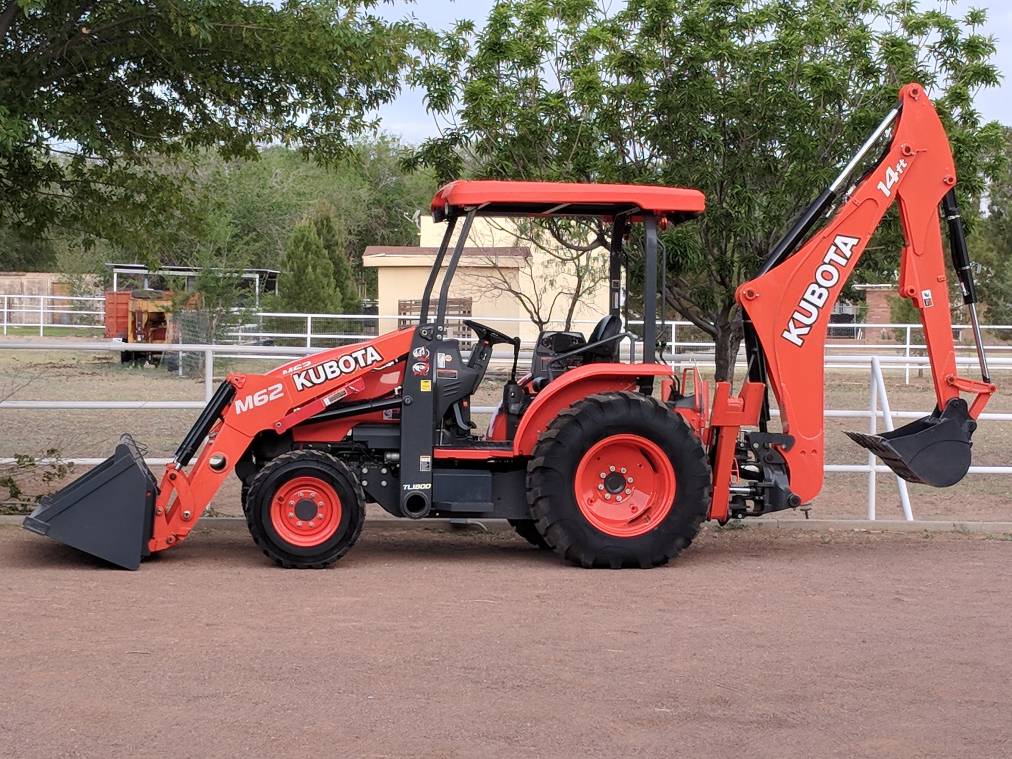

Here is a pic of mine. Just had it delivered on Tuesday. IMG_20180425_064959.jpg
