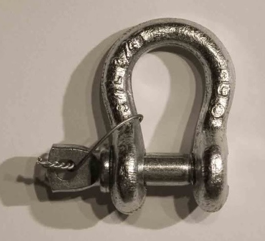

Will a screw pin anchor shackle work? I would try to match the rating of the chain. While it may not be necessary legally it would be nice to have a single chain be able hold in case of an accident.

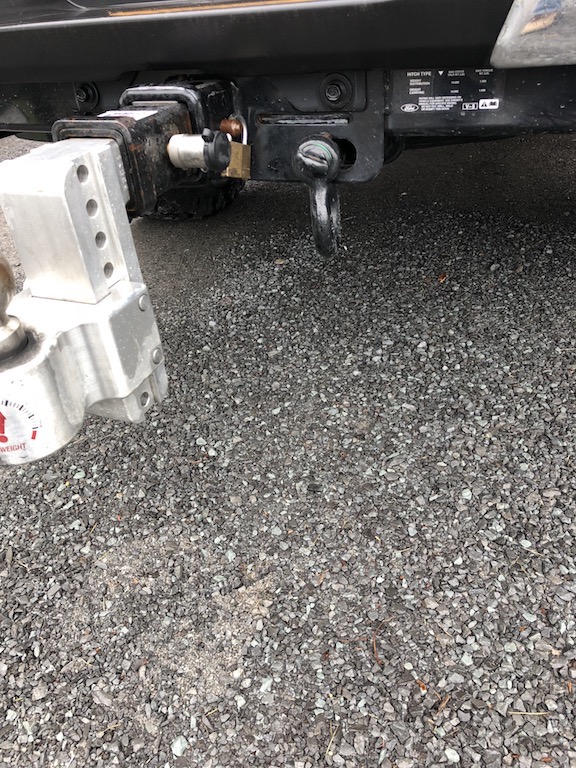

This is what I did because the shape of the safety chain holes on a 2017 F250 are not conducive to any kind of a proper sized hook.

I was also considering screw pin shackles. My concern with them is the possibility of them coming unscrewed while bouncing down the highway. I have found a bolt type with a nut and cotter pin which would fix that problem. The quick links could be situated such that gravity would keep the nut closed. I am wanting these to be relatively easy to remove since the hitch is only 7" above the ground. When I am not towing I want to be able to remove them so they don't hit the ground over bumps and such.
/ Any one use these quick links #7
That's what the hole in the pin is for. :D

/ Any one use these quick links #9
A good way to use that shape hole is to pass the hook through the hole and hook it back into the chain, assuming your hook will hook into a link. This is also the best way to adjust the length of the chain so it's not too tight, not dragging.
Not happening. Didn't like the flimsy factory chain and S hook. Replaced with a larger, stronger hook & chain. No way it's going through that hole.
