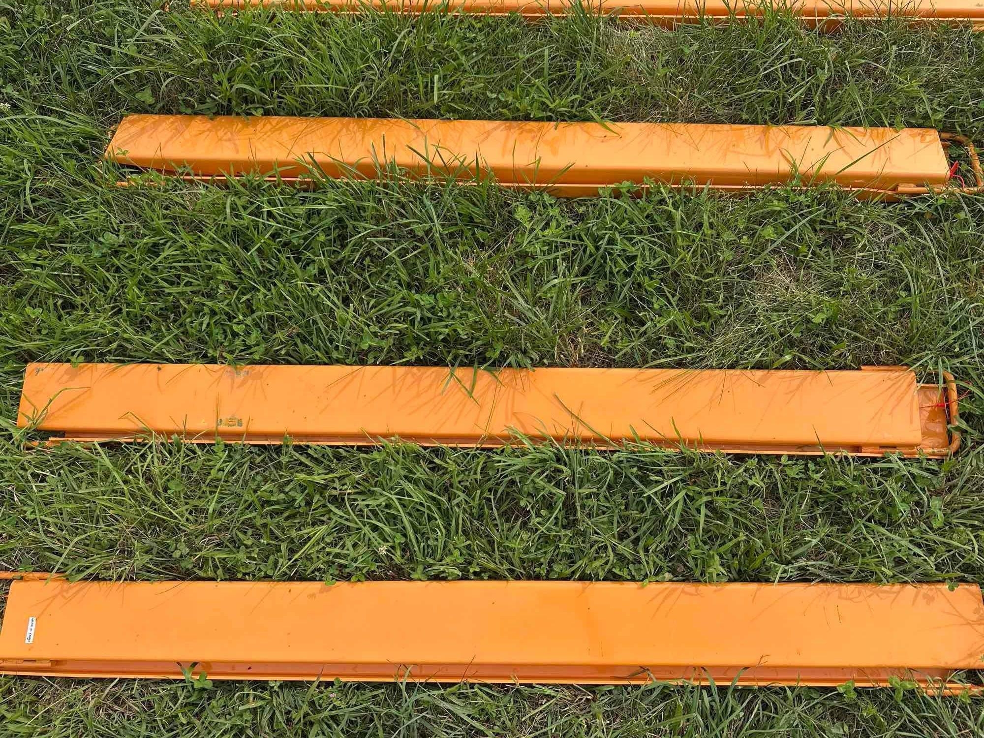

Found it on an auction about 300 dollars each if I recall

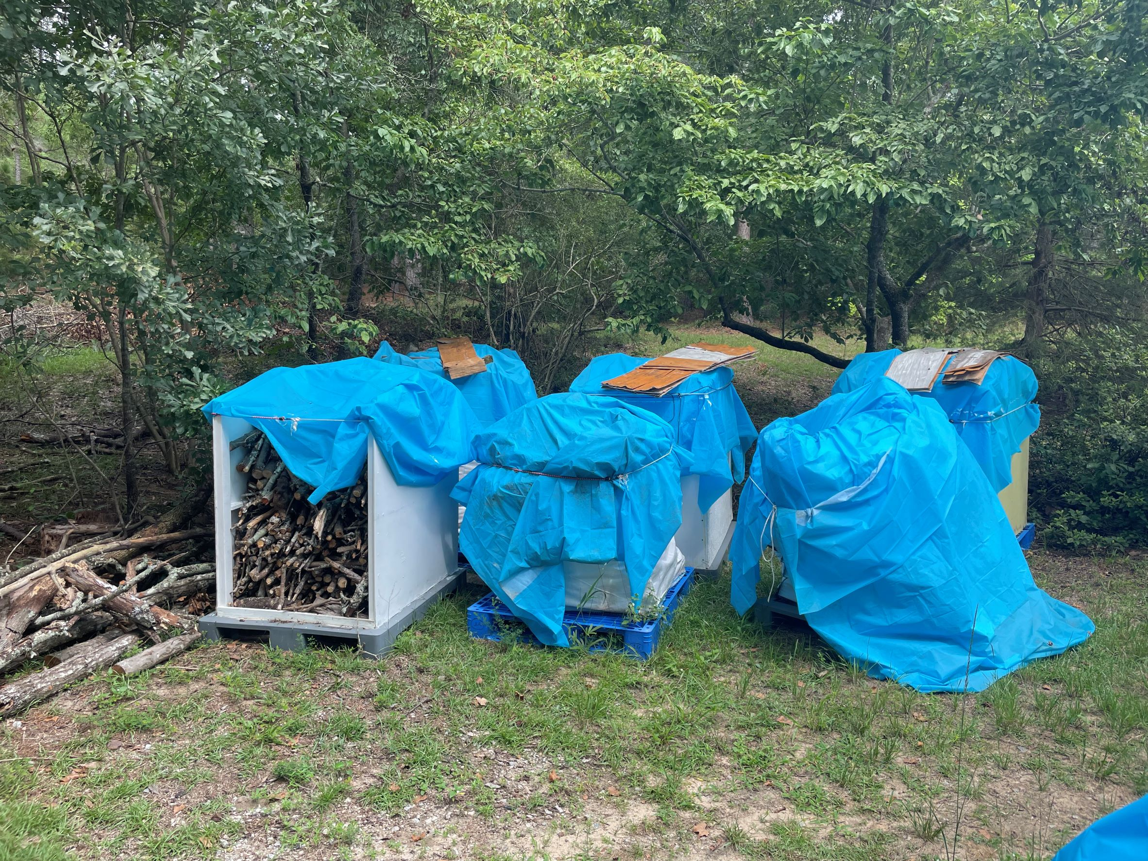

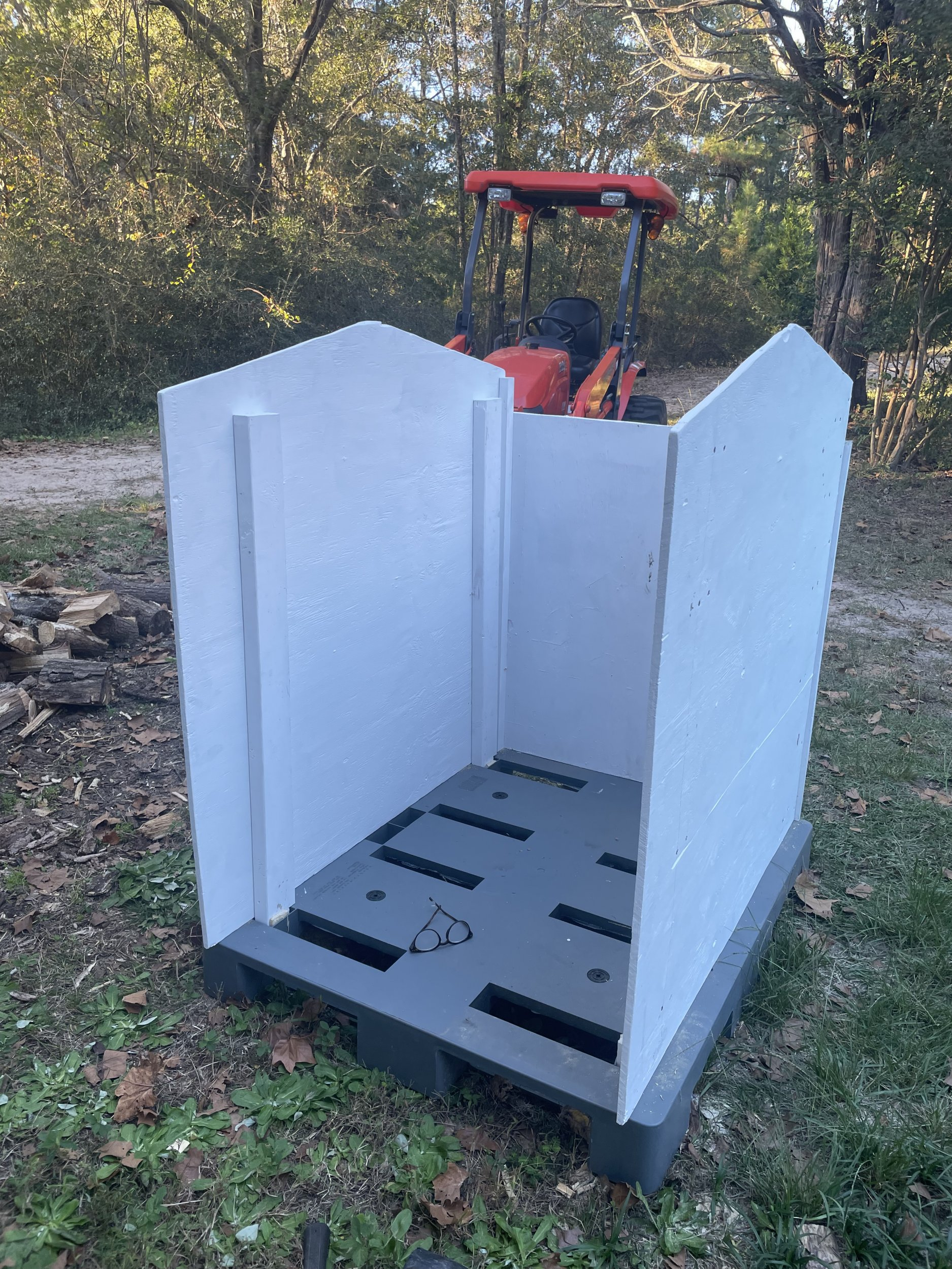

Like Indylan I went the pallet route. Found a guy selling plastic pallets on Craigslist for $12 each--bought a whole bunch and made firewood holders like this out of 4 so far.

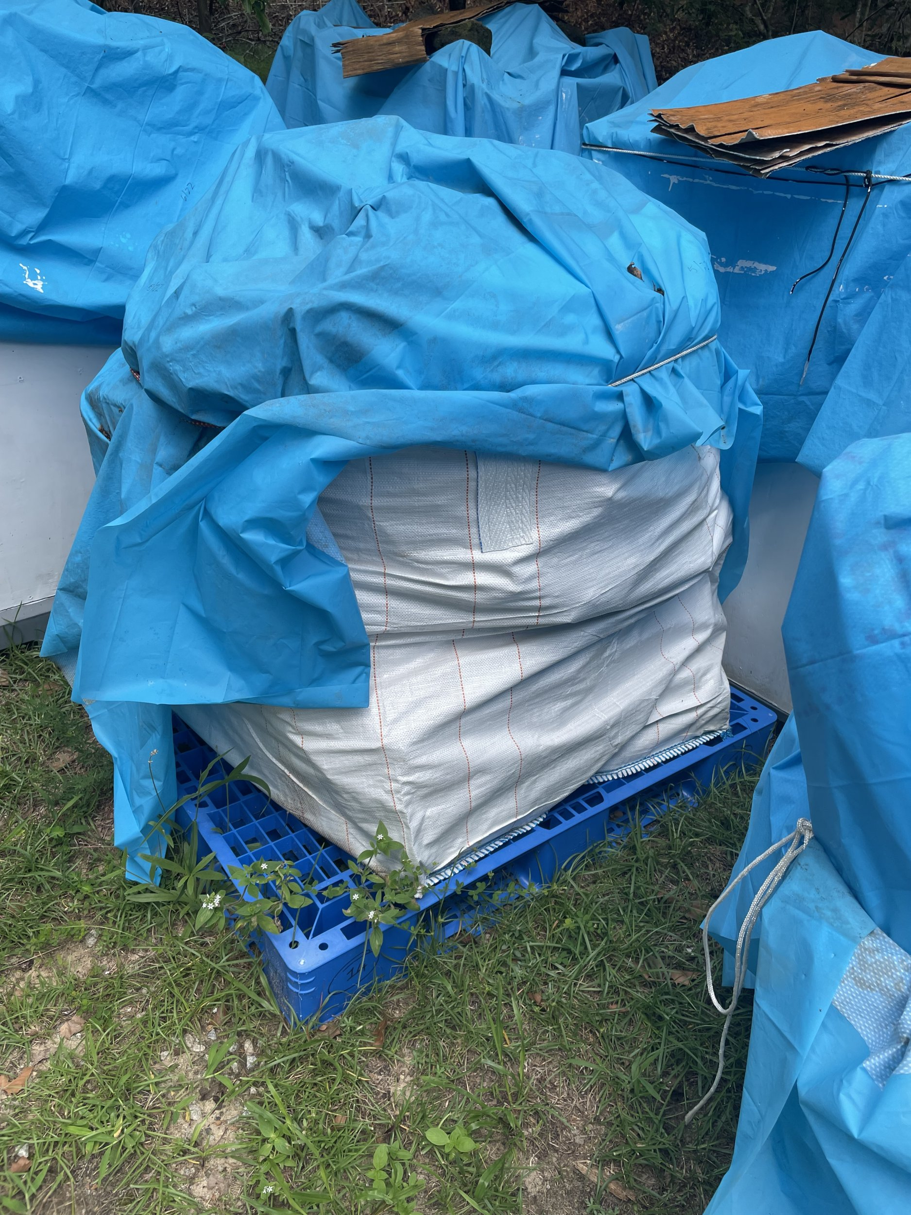

another route to go is polypropylene bags....
affordable and easy to move around using either the lift straps attached at the top of each bag, or simply sitting atop a pallet-which I prefer as it lowers the loader center of gravity over uneven terrain.
Filling the box with split oak pushes the B26 to its limits--it can do it, but even with filled rear tires and box blade on back started lifting rear tire off the ground one day. So we decided to load the good mid-winter split wood in the lighter bags and use the pallet boxes for the scrap limbs and kindling the wifey collects maintaining the property.
Started this system fall 2021--store the wood away from the house and keep it safe and dry. During the winter keep a split pallet and a kindling pallet right outside the back door--so much easier.
To the OP, its not quite the same as your hay wagon--which def sounds promising. For us, dividing the wood onto pallets makes sense bc our firewood comes from many different sources--some is fresh and really green. Each pallet gets a tag with completion date and source of wood. Let's me rotate in the drier material.

How do you dry your firewood in those bags?
From the website, bags are "breathable":
This 34.5" x 33" x 38.5" Type A Bulk Bag (FIBC) with an open top is ideal for storing and transporting dry goods for agriculture, landscaping, construction, and other industries. FIBC bulk bags are made from a thick, woven polypropylene with a UV enhanced finish. This bag holds approximately 1 cubic yard or up to 2,205 pounds of weight, and allows air and moisture to pass through the container.
Hoped to get upwards around 2 years ahead (plenty of time for drying) but brutal June/July heat stopped my splitting efforts cold! Figure around 4-5 cords ought to do it--we don't go through nearly as much as ya'll up north

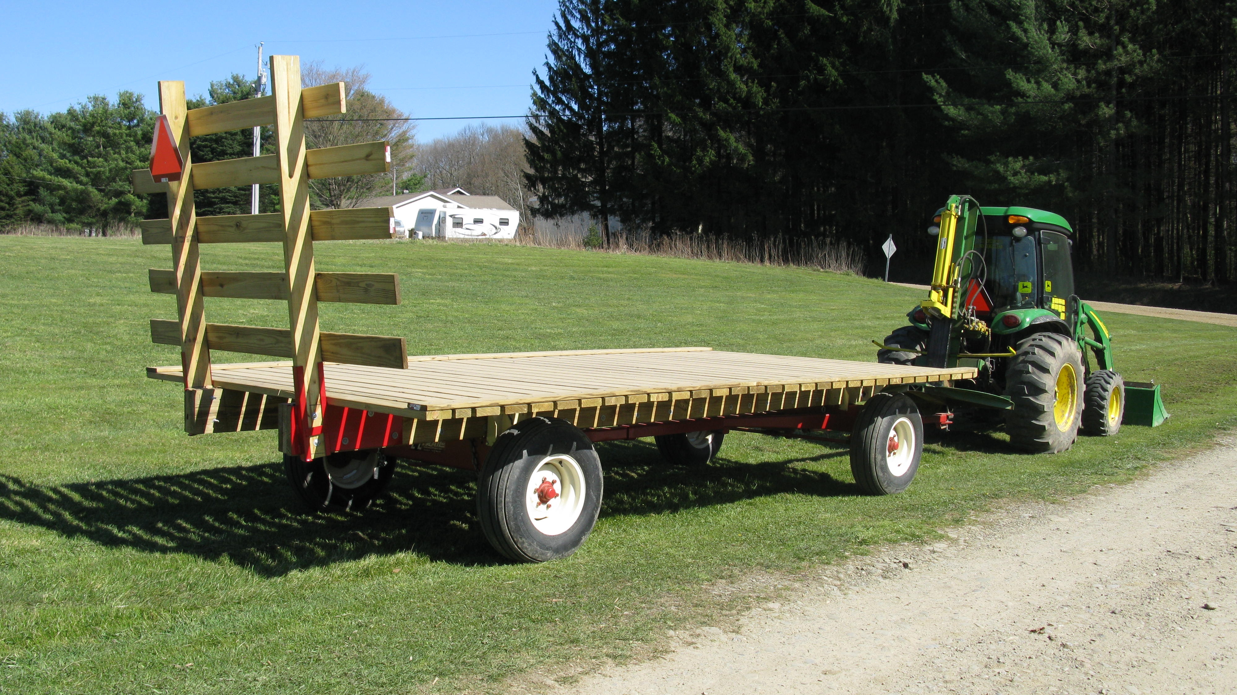

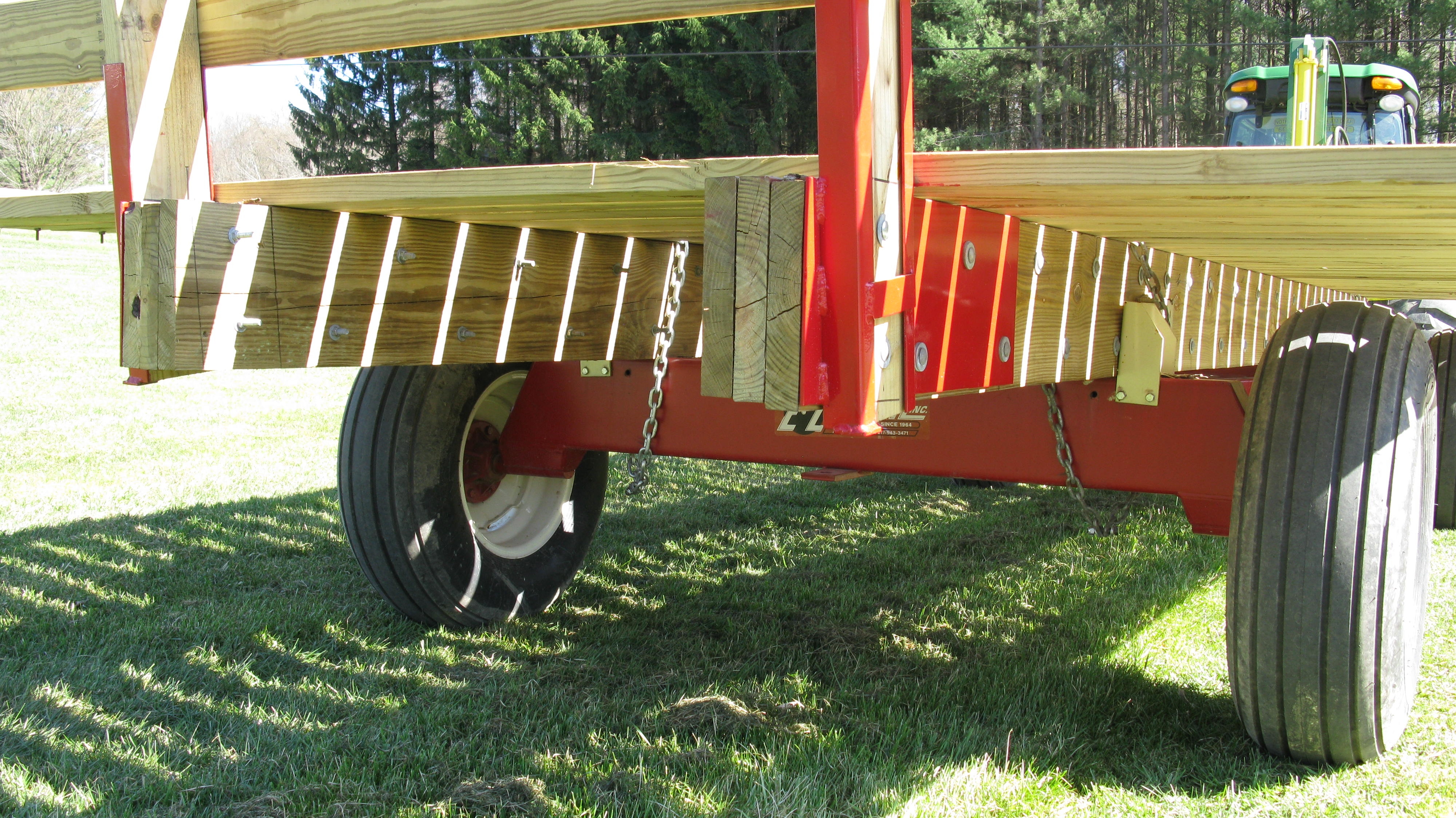

Do LARGE rocks and chunks of pine tree trunk count???? I built a farm wagon out of brand new HORST running gear. Its rated at ten tons - Horst model #185.

My buddy has one, loaded they sink too easily, sitting so low to the ground. You guys must live on some year around hard ground.
SR
I was thinking the same thing, great idea but those small tires wouldn't do well on soft ground.
   / Any pictures/plans of a firewood wagon built on hay wagon running gear? #18
Those tires on the airline carts do look to be a little small for soft ground. I've found that a heavy load on mine will sink and create ruts in the spring. For that matter - so does the tractor - pulling my heavily loaded wagon.
I just wait until things dry out and the ground hardens. Like right now. The tractor and trailer hardly leave a mark on the ground.
