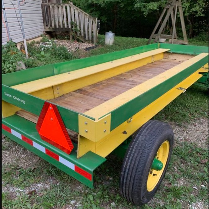

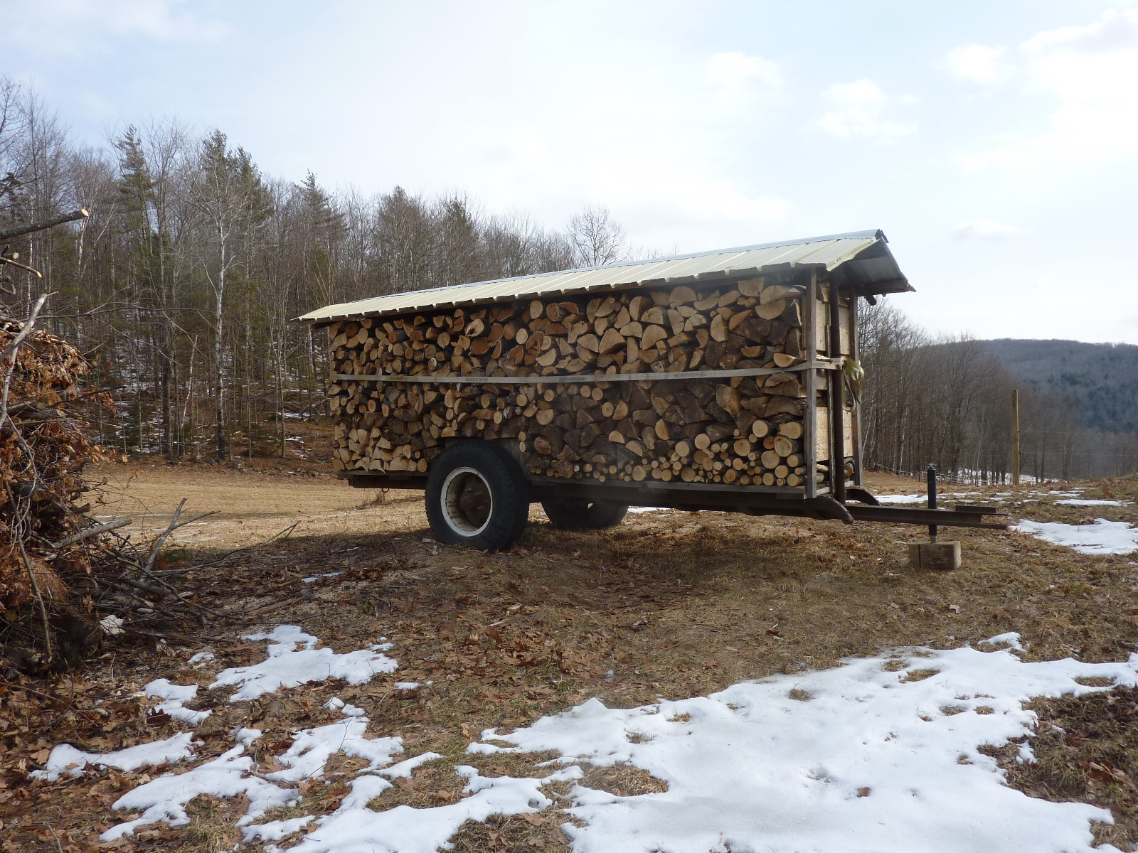

I'm pretty late here and this isn't running gear but might be close enough. Not mine either - it's my neighbors
gg

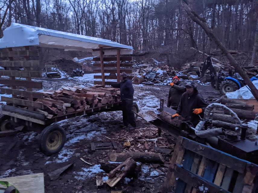

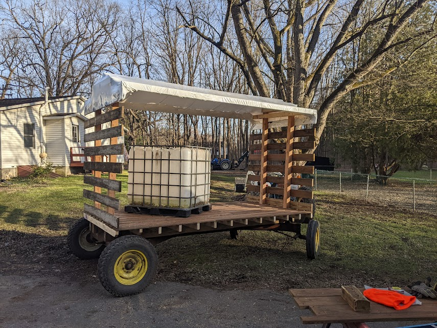

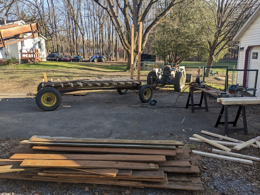

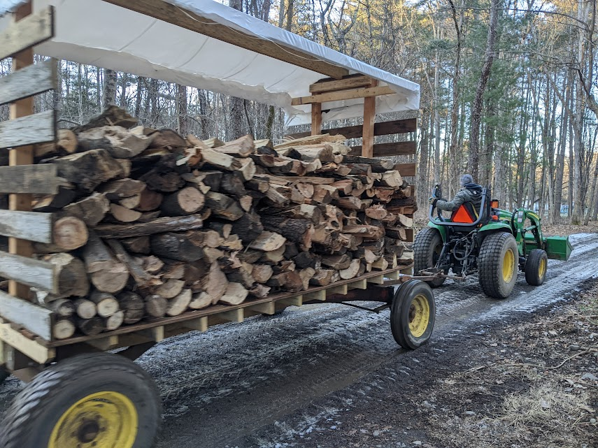

So I finally got around to building it. Works great. cant load as much as I want cause it gets so high, its a pain to load/unload. got 2 cord stacked on it so still better than doing it a pallet at a time!
My Neighbor redid his deck and gave me all the old deck boards:
used some left over shrink wrap from the boat to make a roof:
fill it up in the wood yard
pull it to the boiler

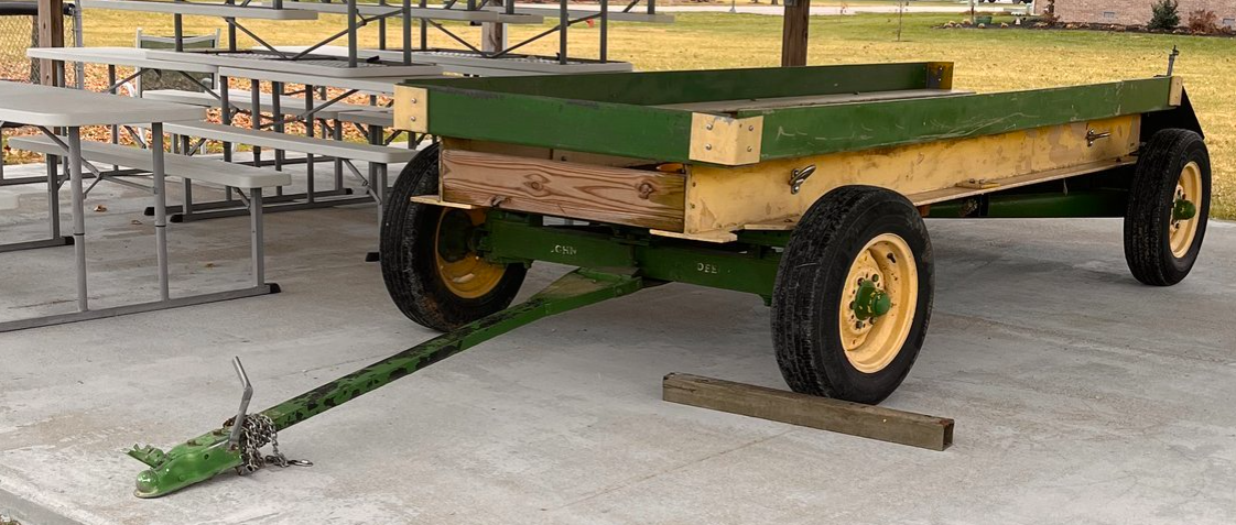

I found an old John Deere Running gear and used fiberglas I-beams (local fencing guy has them for sale) -- and put sides as shown on them. I use IBC totes for firewood storage. The side rail is removable so that the totes slide in from the left side and sit directly on the large I-beams. This wagon also doubles as a good hayride wagon -- put the side rail back on and the kids sit on it.

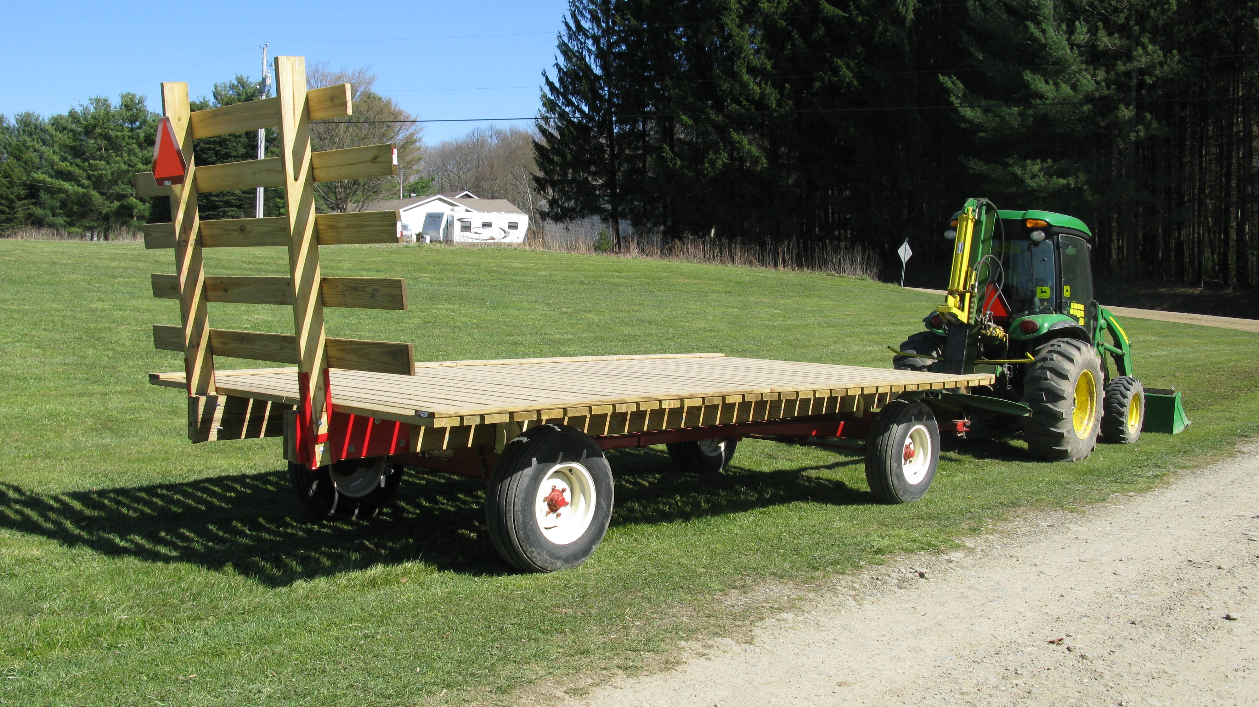

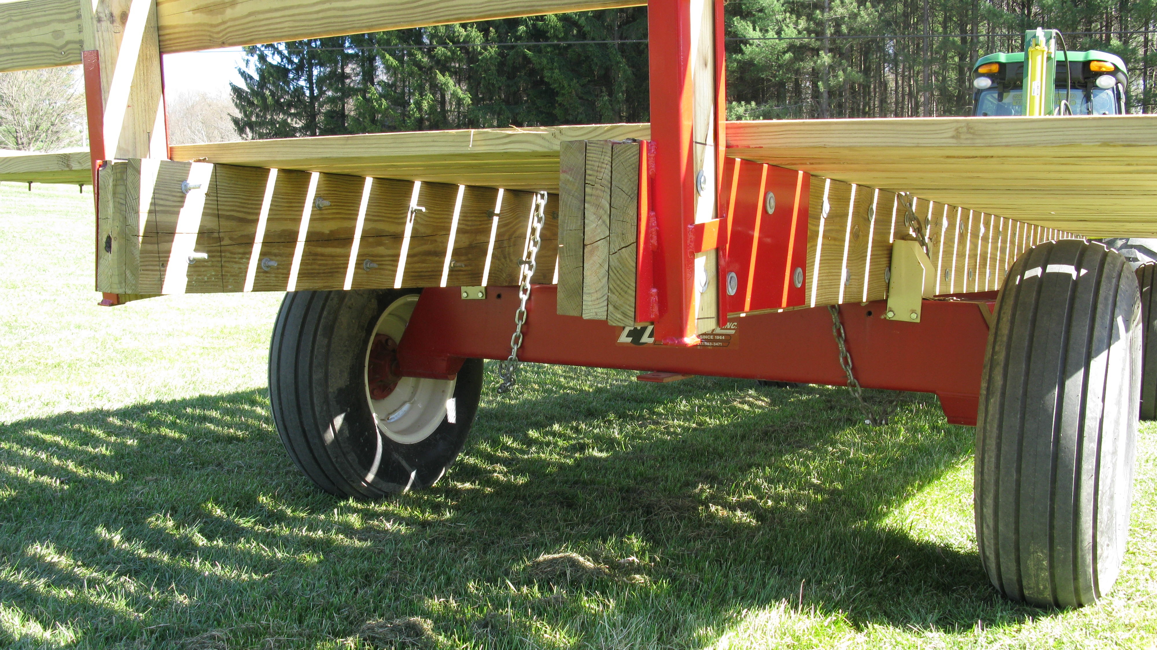

I made this hay rack just for moving my wood from the landing down to my garage. My brother in law some times borrows it for doing hay. It also a 8 ton running gear, E-Z Trail.
