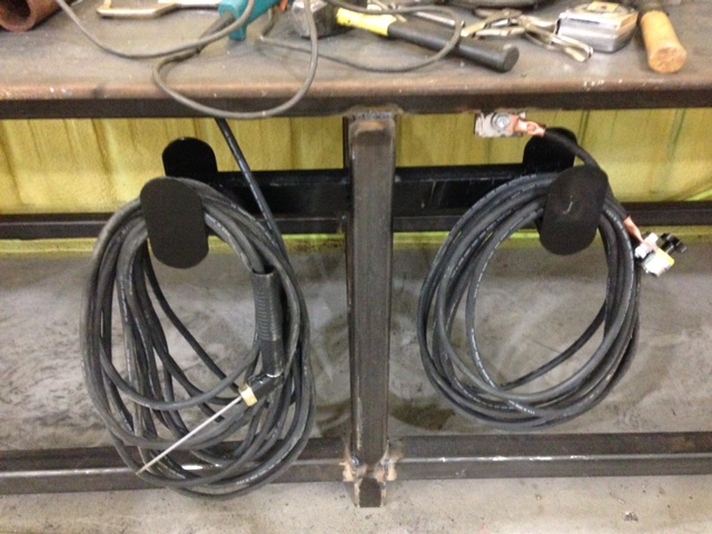

Yes, there is. Whenever possible you should attach the work directly to the part being welded. You are relying upon the surface to surface contact of whatever you are welding to provide a current path. That at best is unreliable. Not to say it can't be done in a reliable fashion if due care and diligence is taken, along with routine maintenance/sanding of the top, but surface rust, paint, other forms of corrosion may exist either on the table or the "weldment".
I don't see the problem. His table is permanently attached to his welder ground. If you want a direct connection to the work piece, run a properly sized jumper cable between the table and the work piece.

What I have done is one clamp to the table and another cable from that clamp with another 15' cable and clamp. That way I have the best of all worlds, a grounded table, a clamp for loose things, and I can also take the table clamp loose and stretch the combined cables outside for welding when needed.

wt2.JPGwt1.JPGWell I got it all connected up and took a couple of pictures in case anyone is interested. It works good.

What we did at work for our grounding cable is use 2 grounds.. One we bolted to the table, the other we clamped.. If you need to weld somthing off the table (say, too big or heavy) we simply used the clamp.
But then, it was a big Lincoln with lugs..

I just wanted to remind people about the dangers of having a poor welder ground and the ground is found inadvertantly through your shop wiring in some manner, like a metal grounded tool lying on your bench. You will burn up your ground system and there is no fuse or breaker that will blow!
